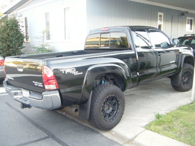

    i got a 3" spacer lift from Toytech and i dont mind too much that its a little stiff. :) here she is with the lift and 285's.. :) DSCF4993_3e71c5d1b812280a774fab00fe39a379b8673d41.jpg
