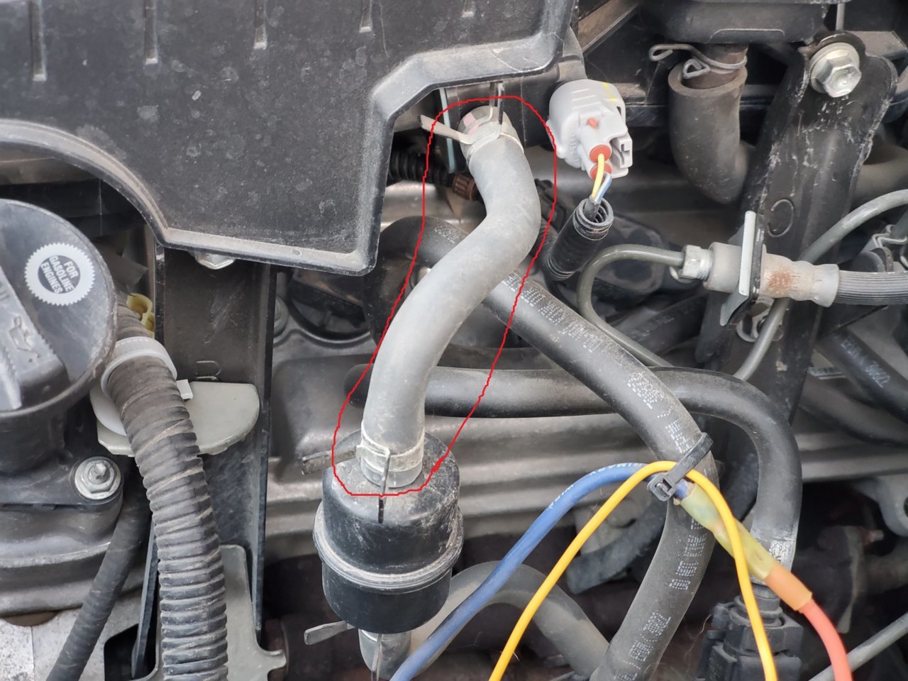

    I just joined two because I began modifications on my 2009 prerunner. I bought a smoke tester but have no clue where to connect it too to do so.

    Do you know where I should plug in my smoke machine?

    A very small leak (0.02in) sometimes can be very difficult to find.
    You will need a scan tool to command the vent valve closed, you can hook your smoke up to the line at the purge VSV (shown below assuming you have a V6).
    Also test the Purge VSV, with the engine running and the electrical connector unplugged there should be no vacuum present at the port.
    There is also a TSB for p0456 if no leak is found to update the PCM to the latest calibration.
