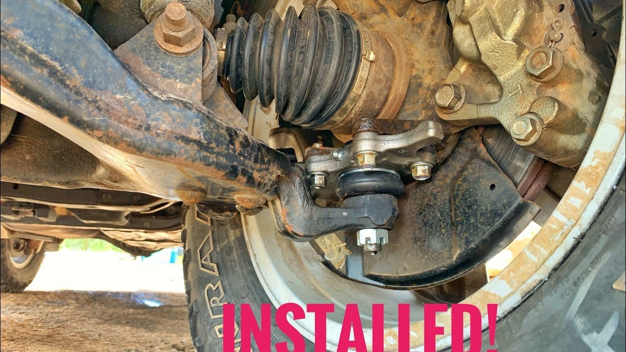

    My 33” tires don’t rub.

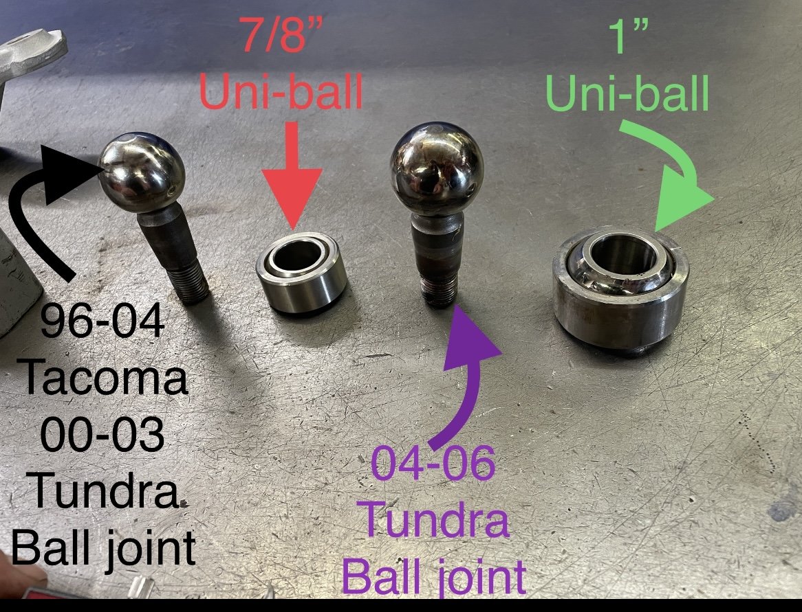

    They cant fail in the way that I see a lot of ball joints fail (shearing off the tapered pin) because there isn't a pin to shear, it's held together with a 5/8" through bolt. If you are referring to them failing by the ball coming out of the race (I would be shocked), then that has nothing to do with Toyota's "shitty design". With the uniball conversion there really is no top or bottom like their is on a ball joint. The uniball doesn't care which way its oriented. If the load was pushing on the uniball like on the 05+ Tacoma's the uniball wouldn't know the difference; unless you can explain to me why the uniball is just as likely to fail as a ball joint.
    I have seen the bolts fail, but its usially from 1. coming loose and then shearing off or 2. people not using the dowel pins that help take the shear load off the ball joint bolts. If you notice, the uniball conversion has the pins machined into the part, and you'll notice that center of the uniball conversion is raised and registers itself into the bottom of steering knuckle which takes side load shear load off of the bolts and transfers it to the steering knuckle.
    Of those miles, a lot are HARD offroad miles. Anyone on here who knows me knows im not easy on my truck.
    Yes its the same 1"uniball that TC uses on its arms.

    Just for reference here are the joints for that model disassembled.

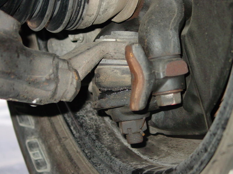

    I have seen numerous of these ball joints pull the ball out of socket and it has EVERYTHING to do with Toyotas shitty design. With this design the weight of the vehicle is literally trying to pull the ball out of socket constantly. This is the sole reason lbj failures are so prevalent on this generation of Toyotas and why the problem basically disappeared in 05 when they put the ball joint under compression like every other truck on the road.
    I just don’t see how a uniball, which is still just a ball in a socket, is going to be any different.

    Mine don't either but I beat the crap out of my firewall . Are you saying the new ones will move the tire forward? Do you have a eta on when they maybe coming to market? If so I'll hold of on getting the solos.

    Yes, I agree with you 100% that when the ball joints pull out of the socket it is because of Toyota’s shitty design. What I am saying is with a uniball it’s different because it’s not a 1 piece taper and ball in a plastic socket trying to pull out of a socket. If you are arguing that the uniball has the same chance of failing as the ball joint because Toyotas design loads the uniball in a shitty way then you are questioning any uniball used in a horizontal fashion correct? Did you look at the load rating of the FK uniball? I don’t think that this conversion is for everyone and clearly it is not for you and that is totally fine, no one has a gun to anyone else’ head forcing them to buy it. I never said it was completely indestructible, and I never said it will outlast a factory ball joints in terms of miles. All I’m saying is that it’s much stronger and will not fail in the same way a ball joint does.
    The bottom line is that I have this truck, and after having my son 3 years ago I decided that it was about time someone made a fix for as you say “.Toyota’s shitty design” because I wasn’t about to have a ball joint failure with my son in the car. So after two years of hard work and overcoming multiple hurdles, Total Chaos is now able to offer a solution to a very common problem with a very popular Toyota platform. If you don’t think it’s very good, I respect that and you’re entitled to your opinion, but if this part keeps even one taco or 4-runner from rolling due to ball joint failure then in my eyes it a success.

    I do not have stock length lowers on my truck, And I cannot talk about what we have in process right now, but one thing I have found over the years is tire revving is very dependent also upon wheel and tire choice. I didn’t have to beat my fender well at all, but I also use stock wheels and no wheel spacer with a 33x10.5 R15.

    But do you see how the uniball doesn’t know or care what orientation it’s in? Weather it’s being pulled on or pushed on (imagine a uniball in both the photos) it doesn’t know the difference. There could be an argument that the snap ring is on the “wrong side” but there is a reason it is where it is too. And in regards to the cost I understand it’s expensive for sure but it’s not cheap to produce also add up the cost of breaking a lower ball joint and the parts that will need to be replaced once you break a ball joint if it’s not totaled. Axle, inner and outer tire rod, lower control arm, Steering knuckle etc etc
