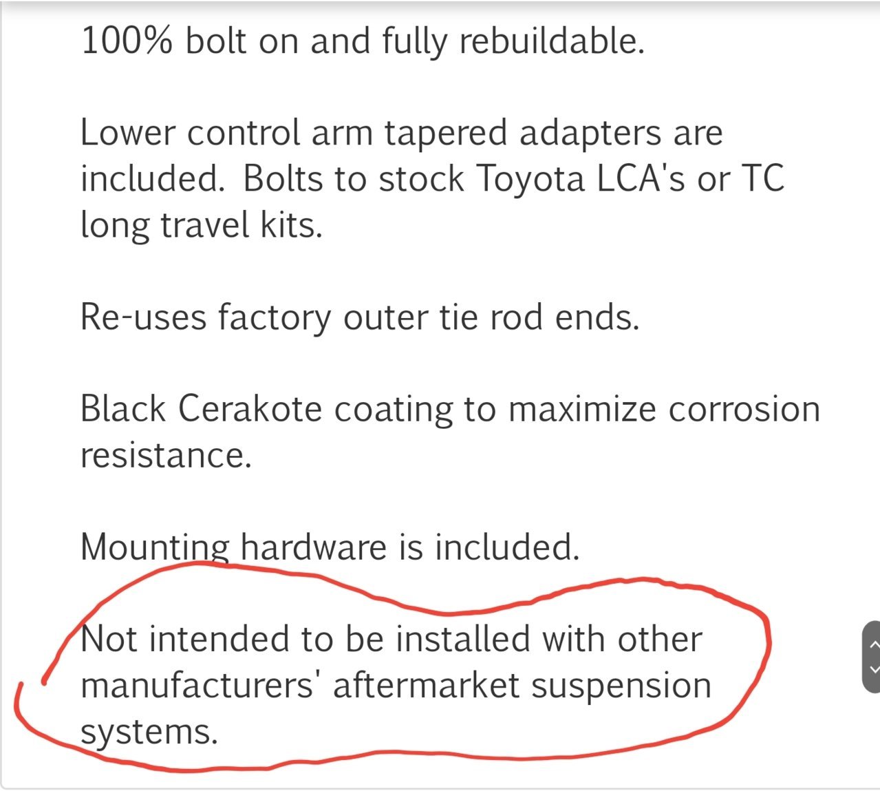

    Mike, would these be compatible with other companies' lower control arms? Let's say Solo Motorsports or BTF Fabrication if we've already purchased those. Also, just to clarify, these would work with stock, mid, and long travel? Thanks in advance.

    That’s just legal disclosure to put the liability on the consumer if they choose to mix use with other manufacturers. If it uses an OEM lower ball joint, I don’t see why it wouldn’t work.

    We have not tried it with any other manufacturers arms so I can’t tell you 100% yes but I don’t see why it wouldn’t work anywhere an OEM ball joint works.

    ^exactly^
