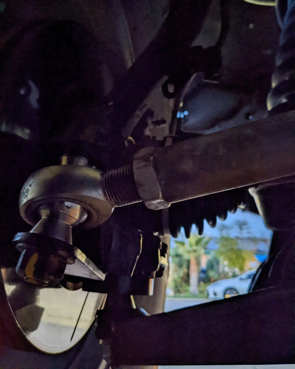

    mike a
    mike a [OP] Active Member
    Jan 30, 2017
    #209121
    37
    michael
    Although I understand the concern about the bearing being open to the air these spherical bearings are 100% stainless steel unlike most shock rod ends which are chrome plated steel that ends up corroding and flaking off. I will take a picture of mine tomorrow morning and show what they look like after 30,000 miles in one year
    Area51Runner and Nano909 like this.

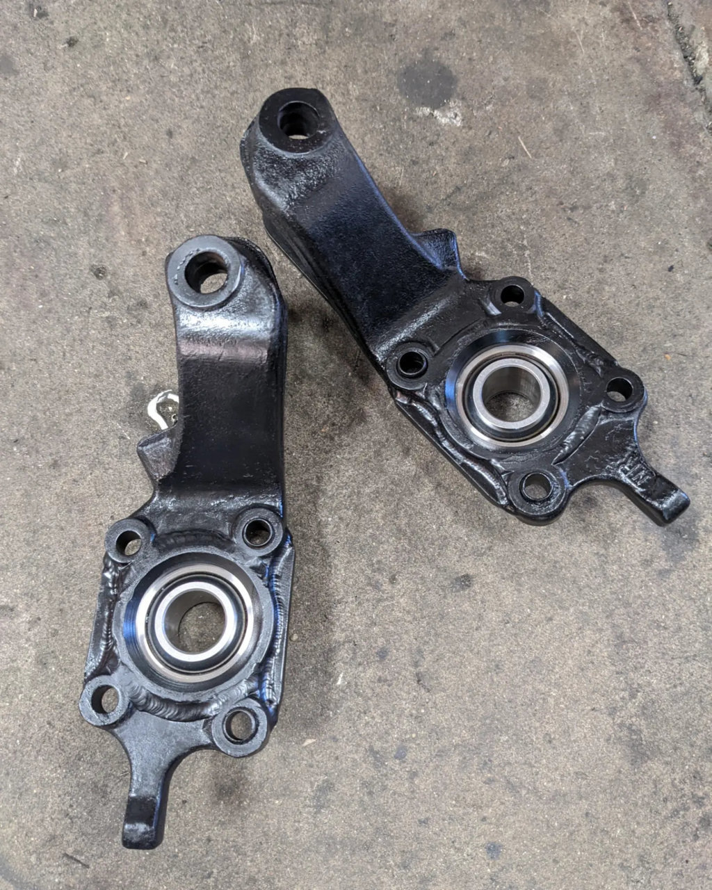

    Zam15
    Zam15 Well-Known Member
    Nov 7, 2012
    #90678
    896
    Derek
    San Diego
    Needs power..
    ARMOR
    Dang! Wish I hand known these were in work before I did my swap :rain:
    Happy to see a 1" uni-ball used here too! Will be a great upgrade for a lot of folks!
    chrslefty and whatstcp like this.
