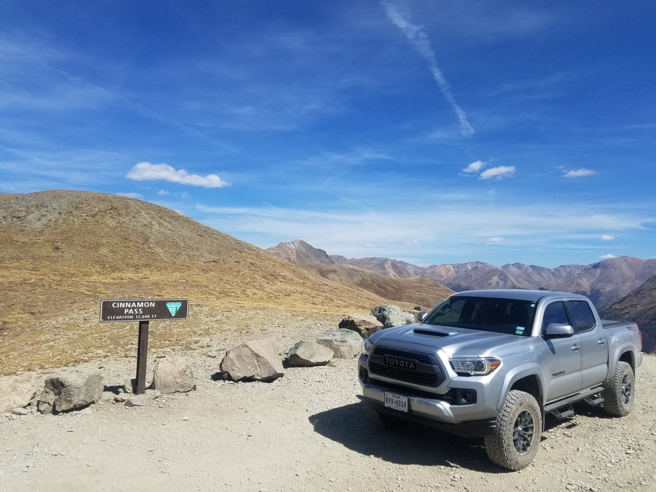

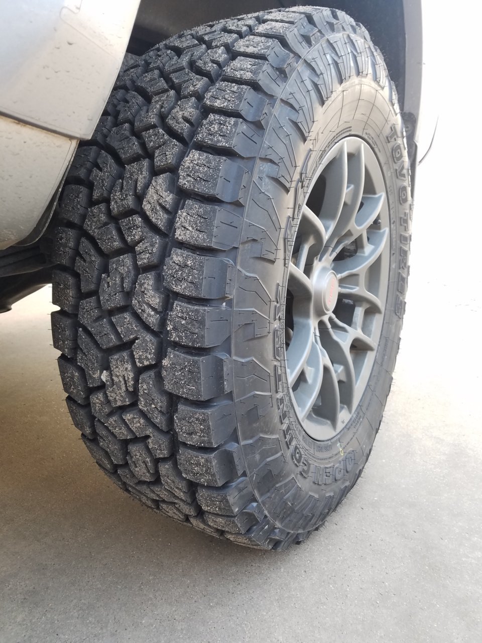

    Just got the AT3's 2 weeks ago and tested them out on the Alpine Loop outside of Lake City, CO. Tires performed extremely well. These are LT265/70R17 E load. Highway manners are good with a fairly quiet ride. There is a higher pitched hum at highway speed but nothing I would consider loud. The ride is slightly firmer than my C load KO2's these replaced but am very happy with their feel for an E load. The sidewalls look great in person and are much more aggressive looking than any photos I've seen. All in all these seem to be a fantastic tire!

    I'll have to check where mine were manufactured...mine are LT265/70r17 E (top tire above) and the sidewall tread definitely looks more pronounced than the one in the bottom pic.

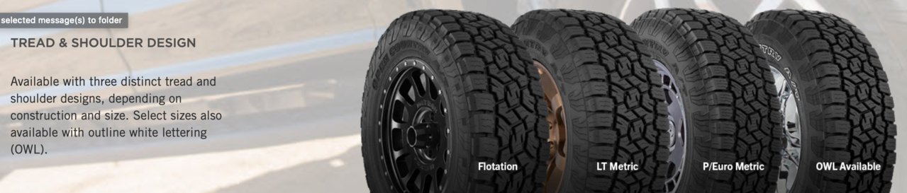

    The AT III features two different sidewall designs.

    I saw that while flipping though the thread. The LT still doesn't look that aggressive imo.

    Wait... so now there is aggressive and non-aggressive SIDES?!
    So confused... What are "Flotation" tires? Is that the SL one? And LT = E rated right?
    edit: Looking at Discount Tire's website for 265/70R17 (what and likely where I'd be purchasing), there is the load range selection of SL or E1, both only have Black Side Wall as the only option for sidewall, no OWL. Any idea what the sides would be like on those?

    Floatation sizes are the ones in the 35x12.50r17 format. LT tires are LT regardless off load rating. C, D, E etc are all LT. Also looking at the picture again I just realized that the P/Euro Metric has more siping in the tread than the other tires.
