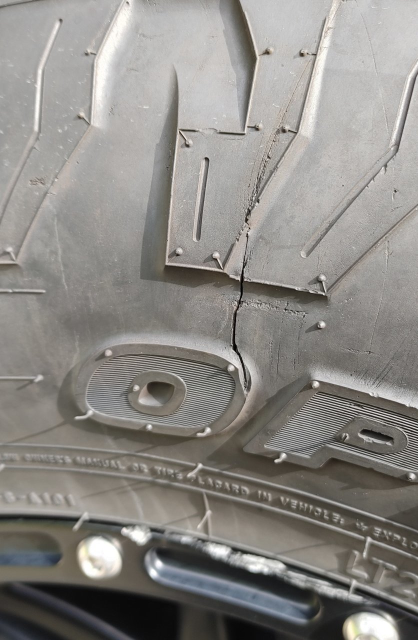

    I did this playing in the rocks this summer. Whatever it was put a gash in the wheel as well. But, the tire held air. I didn't even notice it until I was taking pictures of the sidewall tread for this thread a few pages back.
    I'm not sure if it would have been better or worse with another tire. But, it didn't puncture, and that's enough for me.

    damn bro... welp shit does happen sometimes... Thats great they didn't lose air.

    Wow. That is quite a gash.

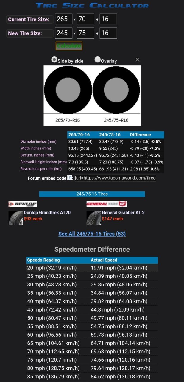

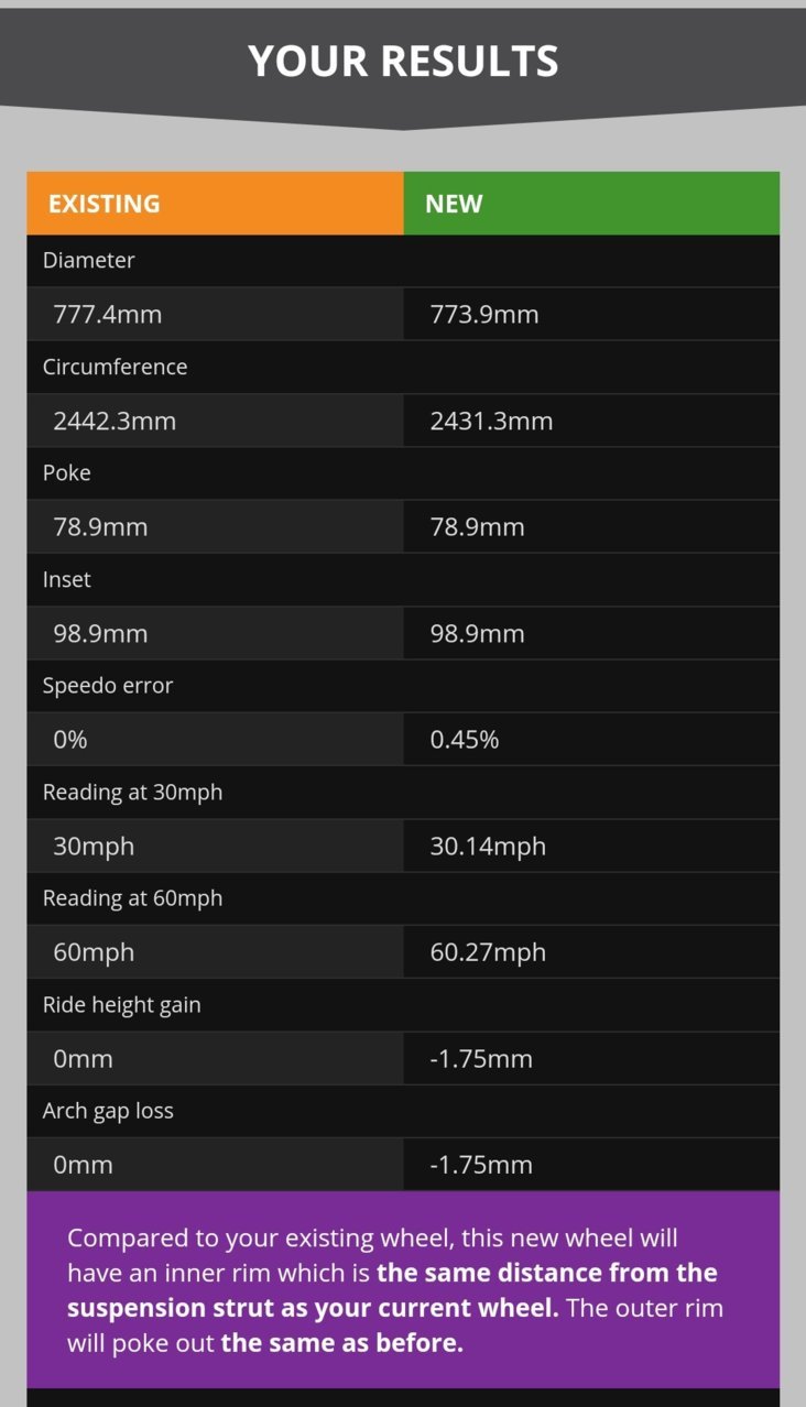

    No issues man... see pics. The tire will actually be slightly smaller. If different from stock wheels i would just check the offset. with OE wheels no issues.

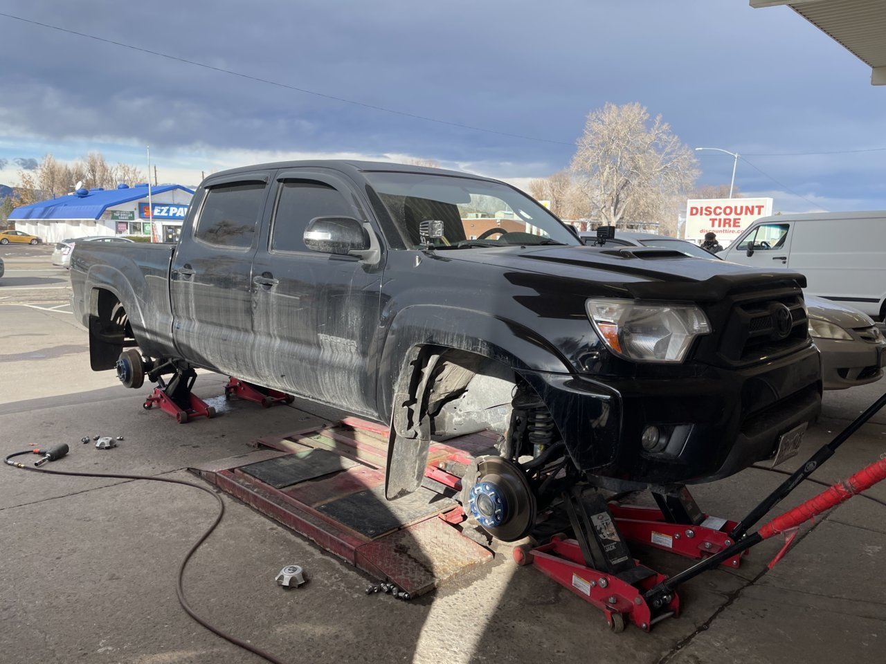

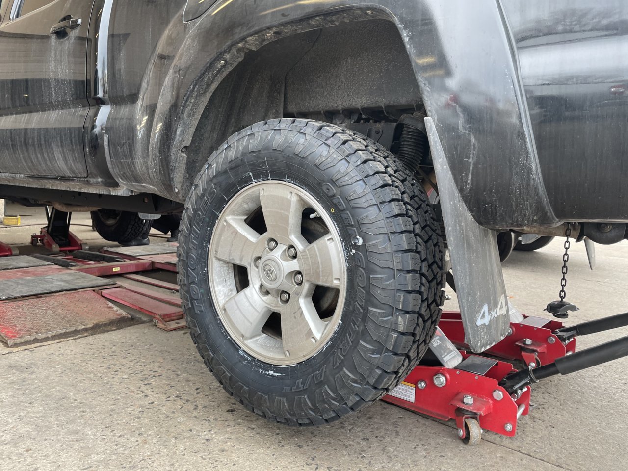

    New shoes. Again. Discount Tire has been great to work with, especially since the purchase mistake was on me. Stoked to have these for the long haul. Better safe than sorry. 245/75/17 E-Rated.

    Well dang! The sidewalls in your picture look extra beefy. Nice choice!

    Yeah I’ve been reading about that. These LT have the thicker graphics on both sides with raised labels on the outside.

    That might have just changed my mind. If I can make sure I can get that sidewall. Thx

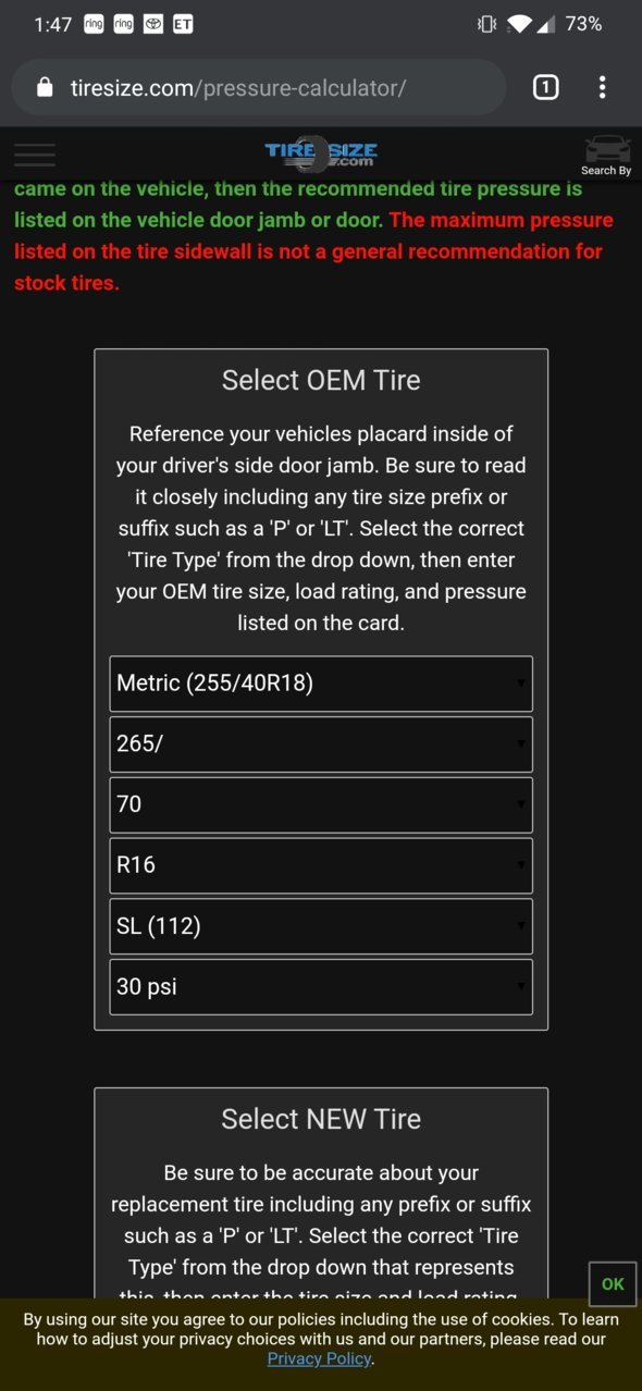

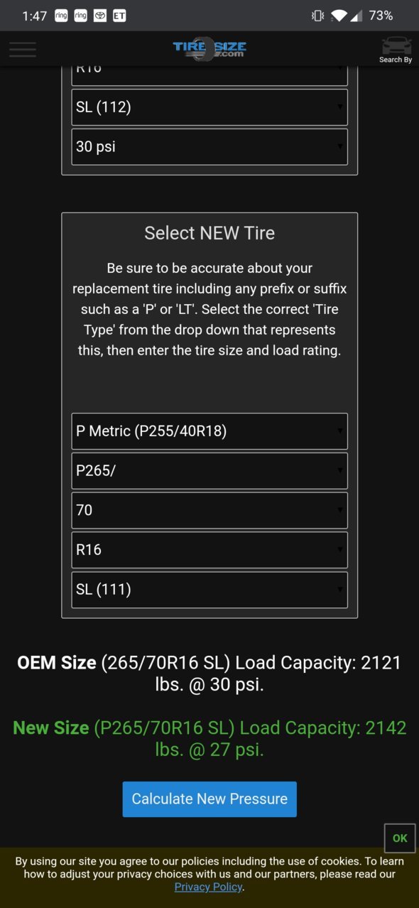

    Okay Fam I thought I would give an update.
    So... it ended up being Tire Pressure... No $hit.. psi
    So the OE tires are load rating 112 and the Toyo's are 111 (for the P265/70r16 P Metric). So I did the math based on the load charts for P metric and metric.
    So the OE @ load rating 112 @ 30 psi (door placard) is the same as the Toyos @ load rating 111 @ 27 psi..
    So I didn't go that low but I did end up setting the rear to 28 and the front to 29 psi. No vibrations at 60-65 mph anymore... So both the Toyota dealership and DT was setting the PSI to 36 which I think was causing some weird resonance thing happening at 60-65 mph.
    In my research I found this website that does this calculation for u... Here is a few pics of the comparison

    Wow, those look chunky. This is soooo irritating (that my LT265/76/16 sidewalls are basically non-existent in comparison).
