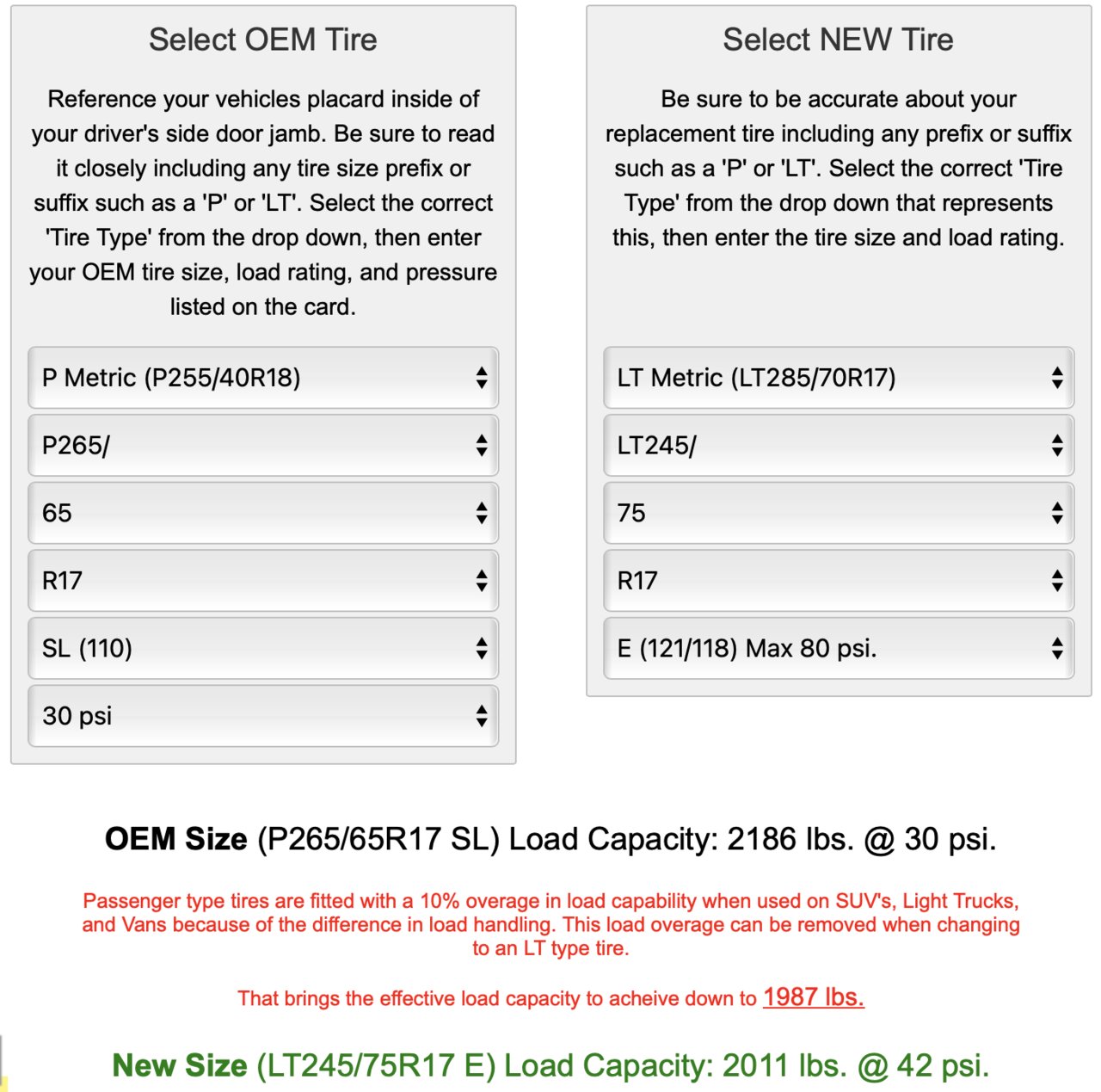

    Welp, Discount Tire got it right I guess, but the load capacity is way off below so.... :notsure:

    I think there's a reason for this, but I can't recall exactly. There is some sort of adjustment going from SL to LT tires. More tire stuff that I just don't fully understand. :oops:
    This is why I just trust the website to figure it out. I have been running the pressure recommended by that calculator on my current set, and they're wearing evenly. So far, so good. They happen to be AT3's as well.

    I don't think I realized you were on a 245. That makes more sense now. A smaller contact patch will require more pounds because of less square inches touching the road. At least that's how I'm thinking about it.
