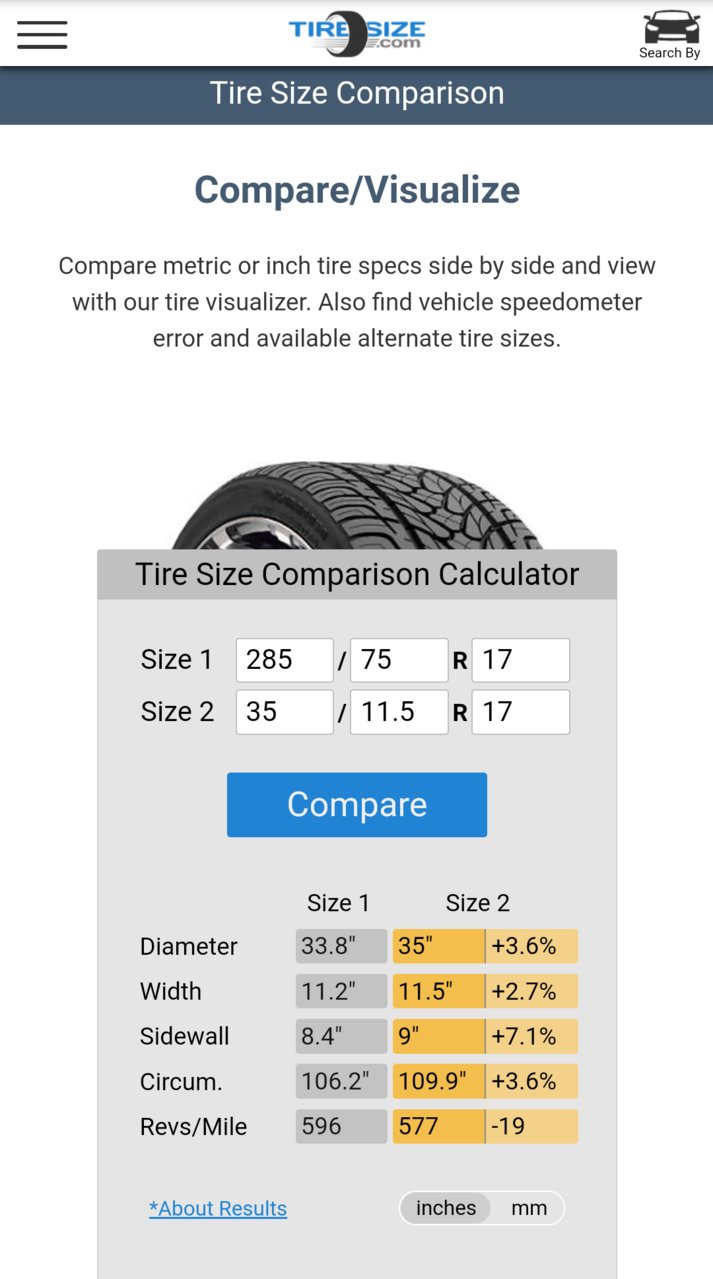

    Anyone know if there is any difference in the sidewalls between a LT285/75/17 C load vs the 35/11.5/17LT in C load?
    That, and I'm also wondering how much extra cutting/work it would be to fit the 35 vs the 285/75/17

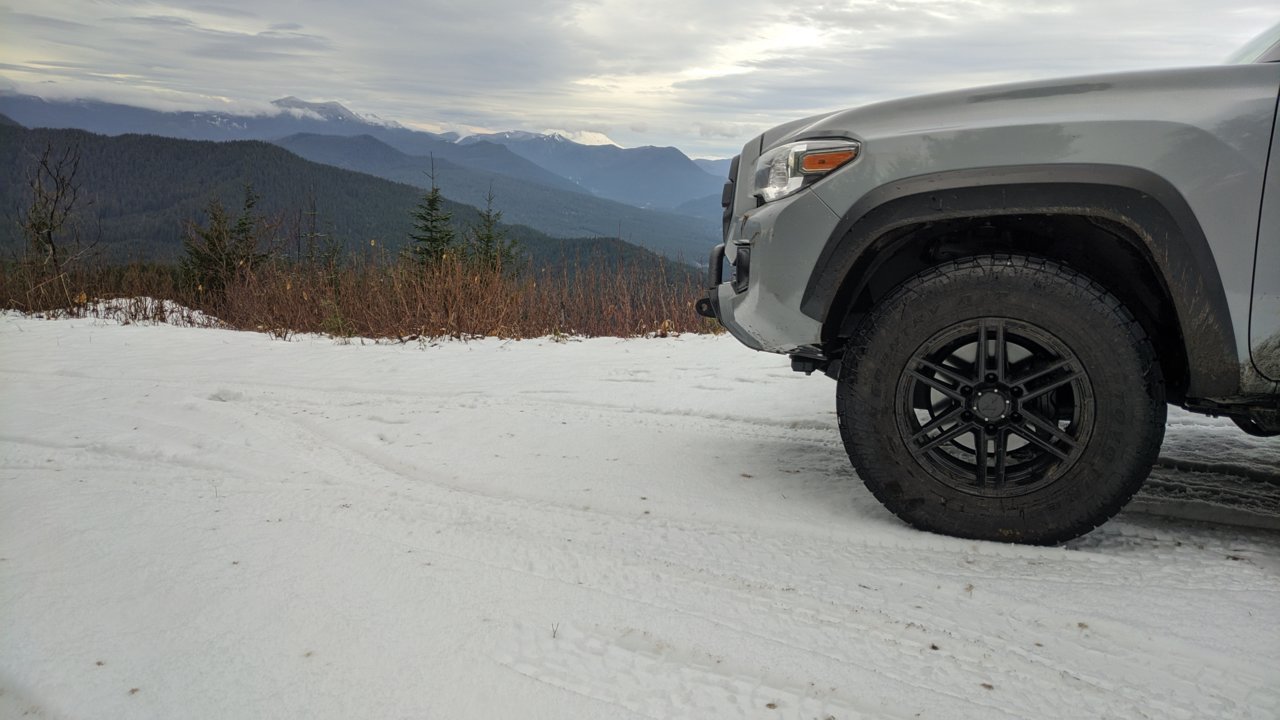

    I've had 265/70/17s on a 17x9 -12 wheel for about 6 months now. No lift, and +110lbs for a winch so I ride sligtly lower than stock. I shaped the plastic with a heat gun and trimmed a little off the bottom with a rotory tool. I still rub on plastic (not the CM) at 2/3 turn and some compression/stuff. I've got upper control arms and Kings shipping soon(I hope) so I haven't hammered the pinch weld yet. That might fix the rub.
    I love this tire. So good in the snow and rain. Stock tires had me doubting the capability of the truck. Now I'm having fun. Cheers

    Here are some dimensions for comparison. You can also check Toyo's website for their exact dimensions, as tires usually vary slightly from one manufacturer to the next.

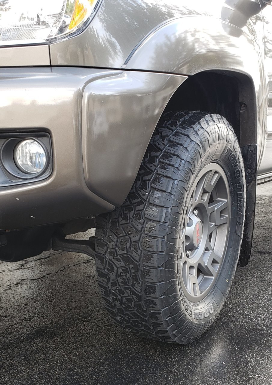

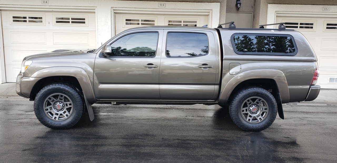

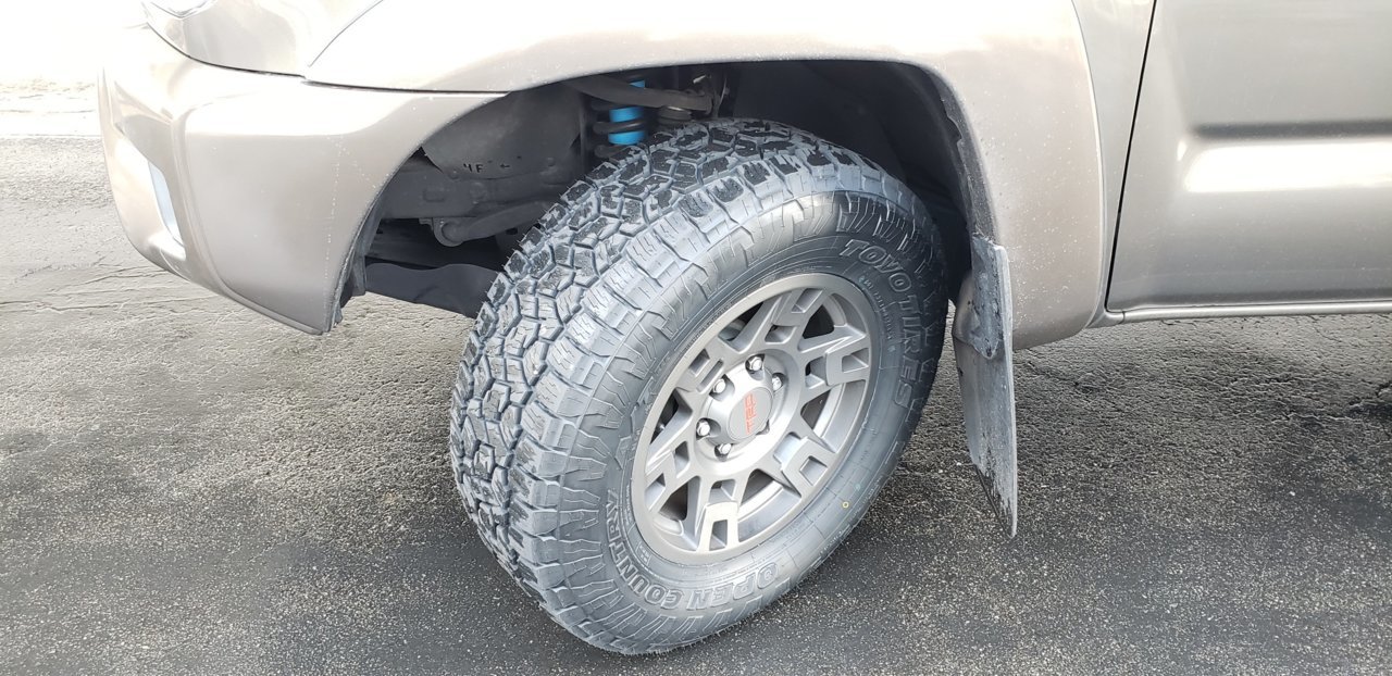

    Got my shocks back and finally got the big bear back on the ground again. 285/75/17 C-load. Stock TRD wheels, no spacers, Fox 2.5 DSC (from Accutune), SPC UCAs, Dakar pack out back.

    Looks nice. Don’t do a fender trim it will make your Tires look small AF

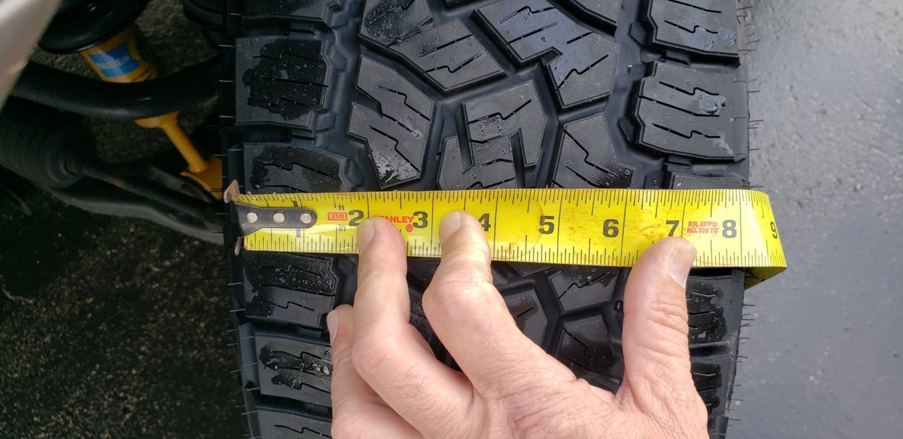

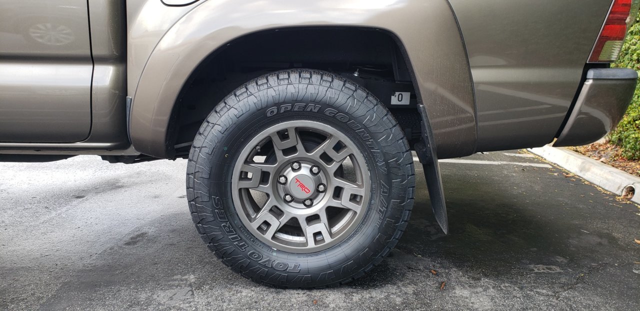

    So glad I got rid of my existing Bridgestone Dueler H/L Alenza Plus in the 265/65/17 size and went with the Toyo Open Country A/T III......great tire all round.......looks, performance on dry and wet (raining all day today), ride quality and price..........I'm glad I choose these "mild" A/T tires and hopefully they'll last a long time (65,000 mile warranty)......size was perfect as well......255/70R17 S/L........half inch taller and half inch narrower then the Bridgestones but I can't tell that they're any narrower and the look great for height and width.......I just had to remove the little "front of the front tire mud flap thingy" as it was rubbing at full turn.....no bigger and I don't want or need a lift as I'm a 2wd and drive 95%+ on road and maybe an occasional dirt road or a trip to the snow......and yes, they look "beefy" enough on the sidewall......not quite as aggressive on the sidewall as the BFG KO2's but not bad at all IMO.....well worth the $172 each from America's Tire!

    Looks great. thanks for the pics. Got mine in the garage waiting to go on!!

    Do you think you could have stuck the 35/11.5/17 in there without any extra cutting?

    Hard no.....assuming it's a true 35" tire it wouldn't fit. If you got extended bump stops it would. Keep in mind, when I say it won't fit, I mean it will rub at full shock compression. Daily driving? Absolutely would fit the wheel wells with some trimming.

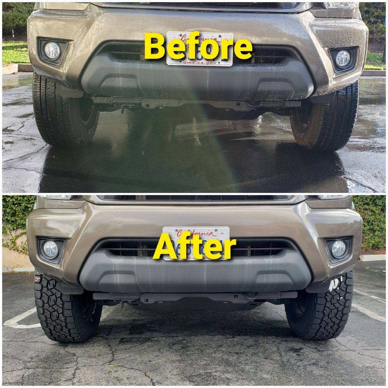

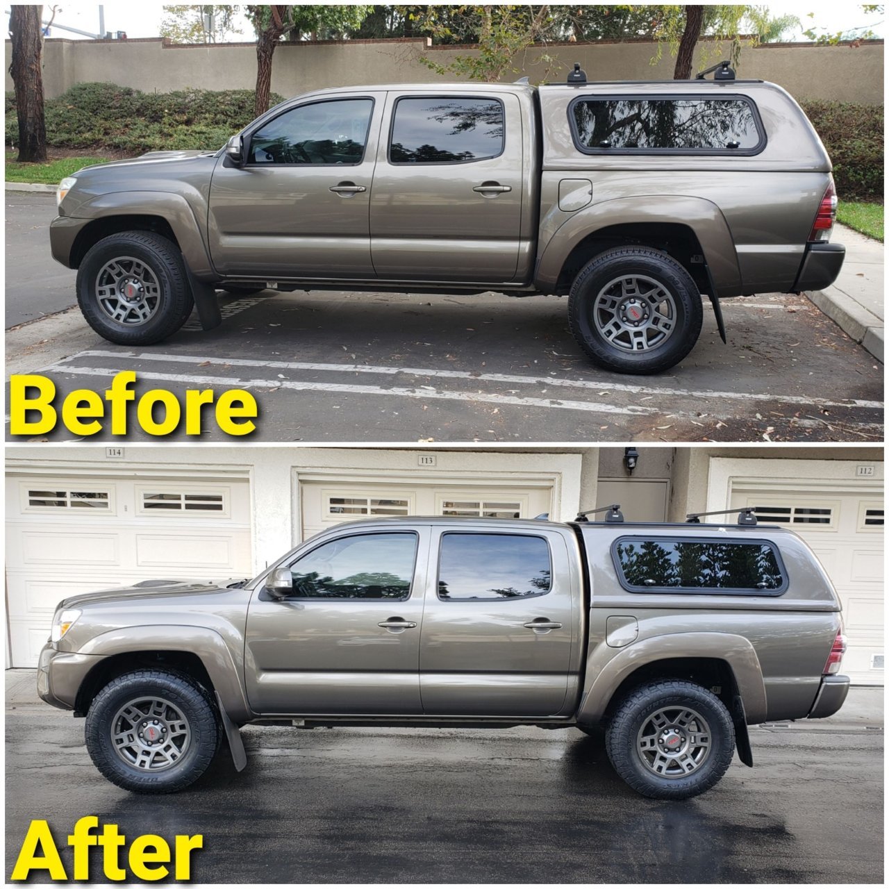

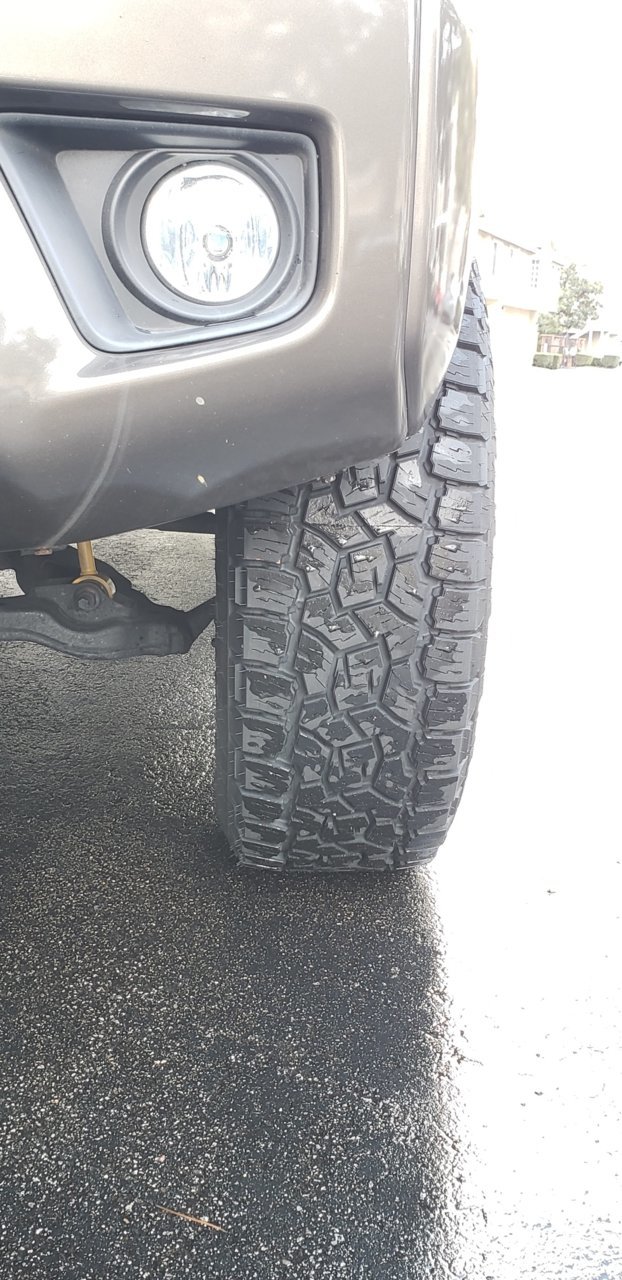

    Ok, I learned a lot about the suspension geometry in the last couple weeks. Full disclosure, it took me so long to get these tires on the truck because I was waiting on my shocks to come back from a custom valving. Originally, I took them off to get revalved and that sort of spurred the idea of getting new tires while the truck was already apart. Gave me time to trim and fit the tires.
    During that time, I thought I was going to need SPC upper control arms to get the tires to fit as I was under the impression the camber would basically disappear when the LCAs were pushed all the way forward. First, that turned out not to be true. The Icon Tubular UCAs are PERFECT. Second, the SPC control arms will not clear any reasonably wide tire. In my case, 285/75/17. When you turn the wheel, the tread blocks hit the UCA in pretty much all caster positions except position A. With that said, you can't really take advantage of the camber adjustments due to the tire already being too close to the UCA...this completely defeats the purpose of the SPC arm. This is with the Stock TRD Sport wheels which have basically no backspacing. If you run a large spacer OR you run a wheel with generous backspacing you will likely be ok. But if you are running stock TRD Sport wheels....hard no, absolutely do not even try SPC control arms. Icon Tubular UCAs or bust.
    I also want to state that I think this is probably the largest tire you can run and still retain the "stock" look. I kinda like having an offroady "sleeper" truck that's extremely capable but doesn't LOOK like it would slay trails the way it does. So for me, this is about as big as it's going to get I think. Can't wait to get some time on these tires!
    PS: I had to finally part ways with my front mudflaps....11.5 years of good memories. Pour one out for my dudes.
    Here's what I ended up with.
