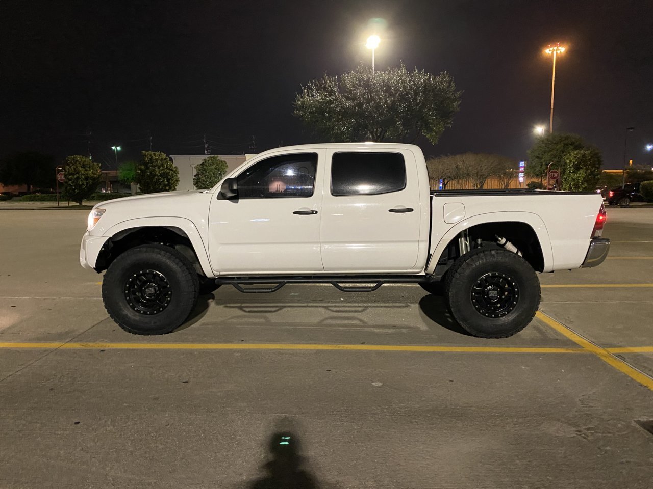

    I haven’t done a chalk test. Discount Tire put them at 38. That seems a little high. But the ride is much better compared to chopped up my terrains
    I think I’m going to test him around 30 32 psi.
    I decided to go with Toyo Over the Cooper because I believe they are a little better off road based on the tread pattern. There is a slight amount of road noise at highway speed’s but it’s not bad compared to MTs.
    I still haven’t got the vehicle aligned yet. So driving back from discount tire on the highway probably sounded a little bit louder because of more camber and the toe is off.
    Toyo does have a 500 mile 45 day trial period. I talked to Discount Tire regarding this and they said that all I have to do is bring the tires back to them and they will credit me for another tire.

    38 is like 42 when they get rolling and heat up

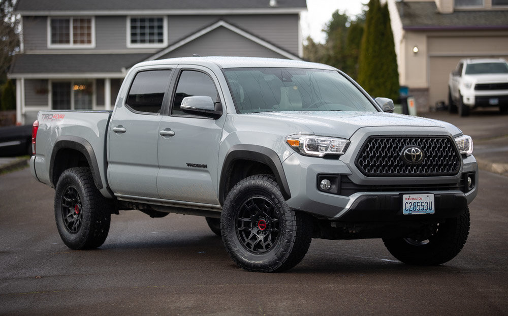

    I just spent a bunch of time researching this yesterday and the Toyo tire pressure tables to figure out the pressure for my new 265/70/17 AT III's. General answer would be if your load rating is the same on the old tires and the new tires, then your pressure should be the same. Some info from Toyo here:
    https://www.toyotires.com/tires-101/tire-load-and-inflation-tables
    https://www.toyotires.com/media/3729/application_of_load_inflation_tables_20200723.pdf
    If the load ratings are different, then you look at the pressure table for your factory tires with the factory recommended pressure at their load rating, then find the matching pressure for the new tires with the new load rating and then find the matching pressure that gives you the same load rating.
    For example, my factory Goodyears were 112 load rating and my new 265/70/R17's are 115T rated. These are both ISO-Metric tires so I used the ETRTO chart on page 34 of the linked PDF. The 30psi door jam recommendation gave me a load capacity of 2149lb with the factory tire's 112 load rating. Then I looked at the row for 115 load rating and to match 2149lb I need 28 psi (rule of thumb bigger tire needs less pressure for given load). That seemed a tiny bit light so I ended up putting them at 31 PSI.
    Anyhow, that's what I think I figured out from reading all that stuff. If anyone more experience has clarification that would be cool too. And since threads are worthless without pics, here's my new AT III's on 2021 4Runner Pro wheels.
    Minny Taco, Siblue, angerbot and 5 others like this.

  15. Feb 3, 2021 at 2:08 PM
    #915
    TACO TM
    TACO TM Well-Known Member
    Sep 1, 2020
    #339457
    147
    2021 Pro
    265/65R17 is XL (116T) - 31 PSI for you
    265/70R17 is SL (115T) - 28 PSI for you
    LT265/70R17 is E (121/118S) - 37 PSI for you
    Which tire did you have put on?

  18. Feb 4, 2021 at 10:59 AM
    #918
    TayTay Ankles
    TayTay Ankles Well-Known Member
    Sep 17, 2015
    #164461
    191
    Super nice set up. I think I'm going to buy the same. Also, do you have a lift or leveling kit in?
  19. Feb 4, 2021 at 11:53 AM
    #919
    TayTay Ankles
    Sep 17, 2015
    #164461
    191
    Those look super nice. About to pull the trigger too. Do you have a lift or leveling kit in the pic? I want your set up! Thanks
