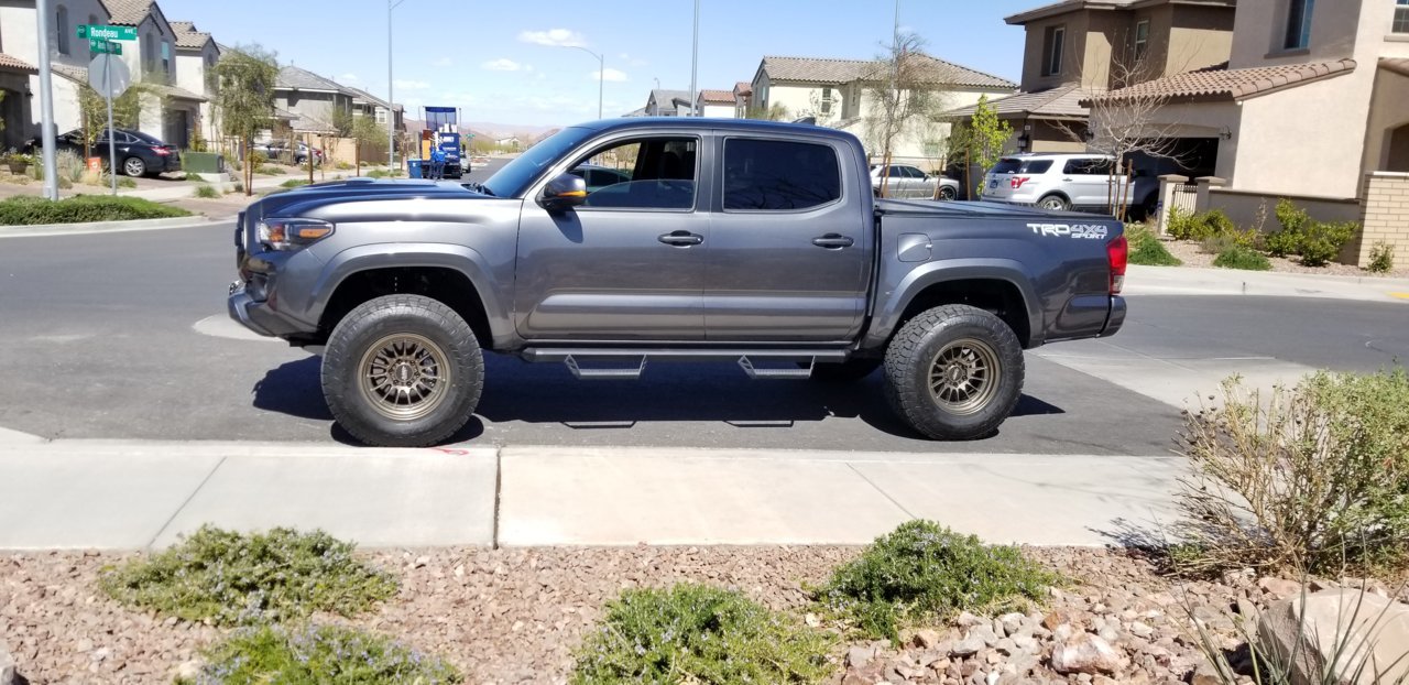

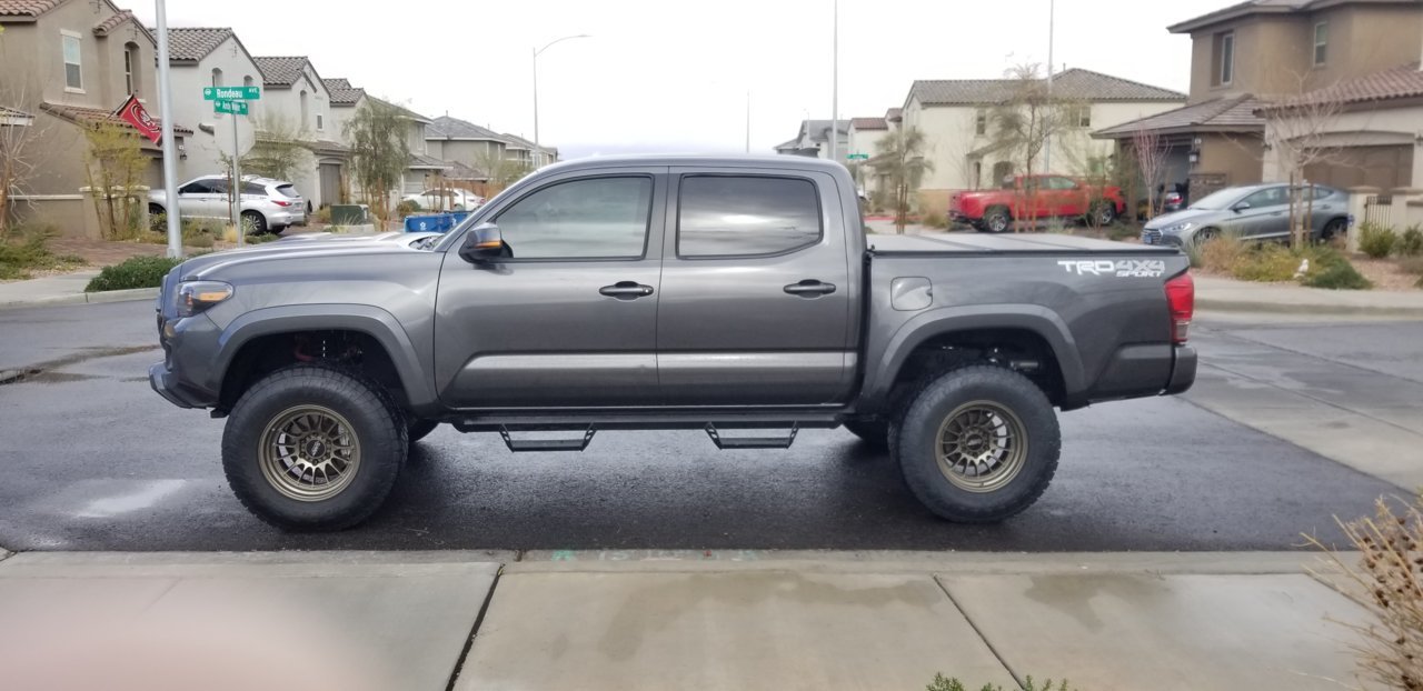

    Did not realize I had the tires installed with the wrong side facing out p285/70/17
    Had them flipped, hard to see from pictures but looks much better in person.
    Interesting enough when the were first mounted I noticed it took 10-12 ounces to balance each wheel. When they were flipped took 0-3 ounces to balance

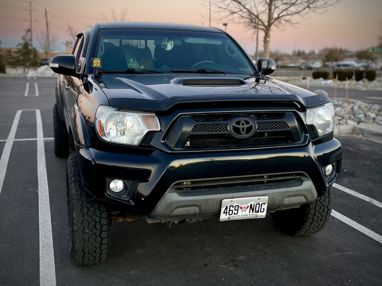

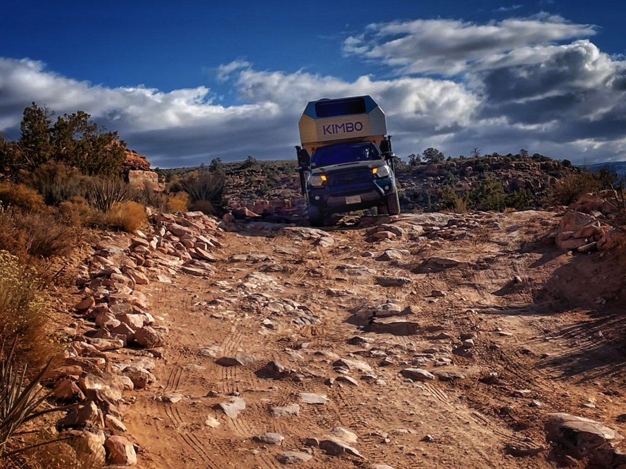

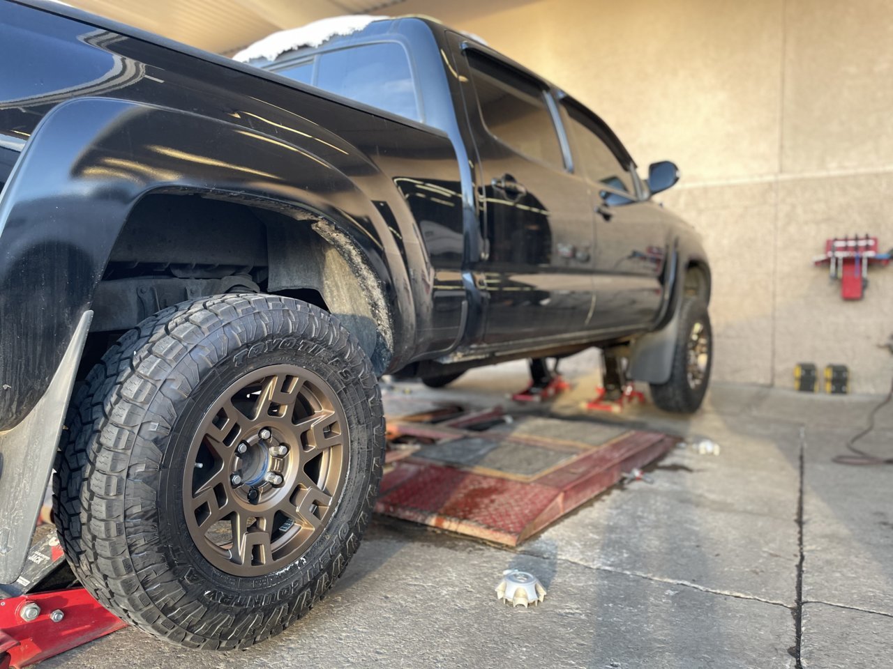

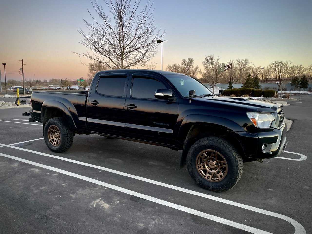

    Nice review. Don't forget that you can go skinny and save a lot of weight while also improving some traction aspects. I went to a 245 LT from a 265 SL Wildpeak and ended up lighter with the same height. An AT3 245/75/17 is 31.5 at 44lbs. Obviously if you don't need the extra load capacity then SL's are fine. I had to go up due to a camper and love the setup. I do wish there was a skinny 32in but then that would be adding more weight again. Happy with the clearance/performance and looks this tire brings.

    Consider changing width to save some weight. My LTs, first set ever, ride just fine. Cant really tell if they are harsher than my SL wildpeaks but definitely feel better cornering. Went from 265 to a 245 and ended up lighter. Just posted some pictures.

    How do you like that Kimbo camper? What's the weight? It looks awesome.

    What denotes the wrong side out? Nice truck!

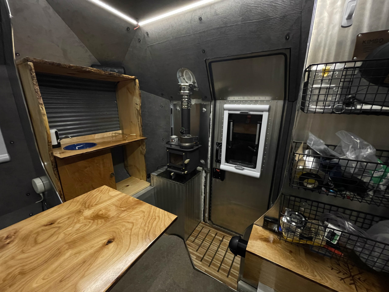

    Its been great! The build quality is exceptional. We just got a base model and currently working on building it out. Its starts at about 900 lbs. Don't notice it on the truck when on the highway and can still parallel park it, tailgate closes. Coming up mountain passes, the truck never had to jump up to 3000 rpm and cruised up. Almost finished with the interior.
    Have a thread started here with some other owners.
