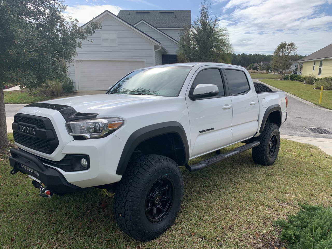

    35x11.5r17
    Best size tire ever.
    DavesTaco68, Suicyco and Dr3w like this.

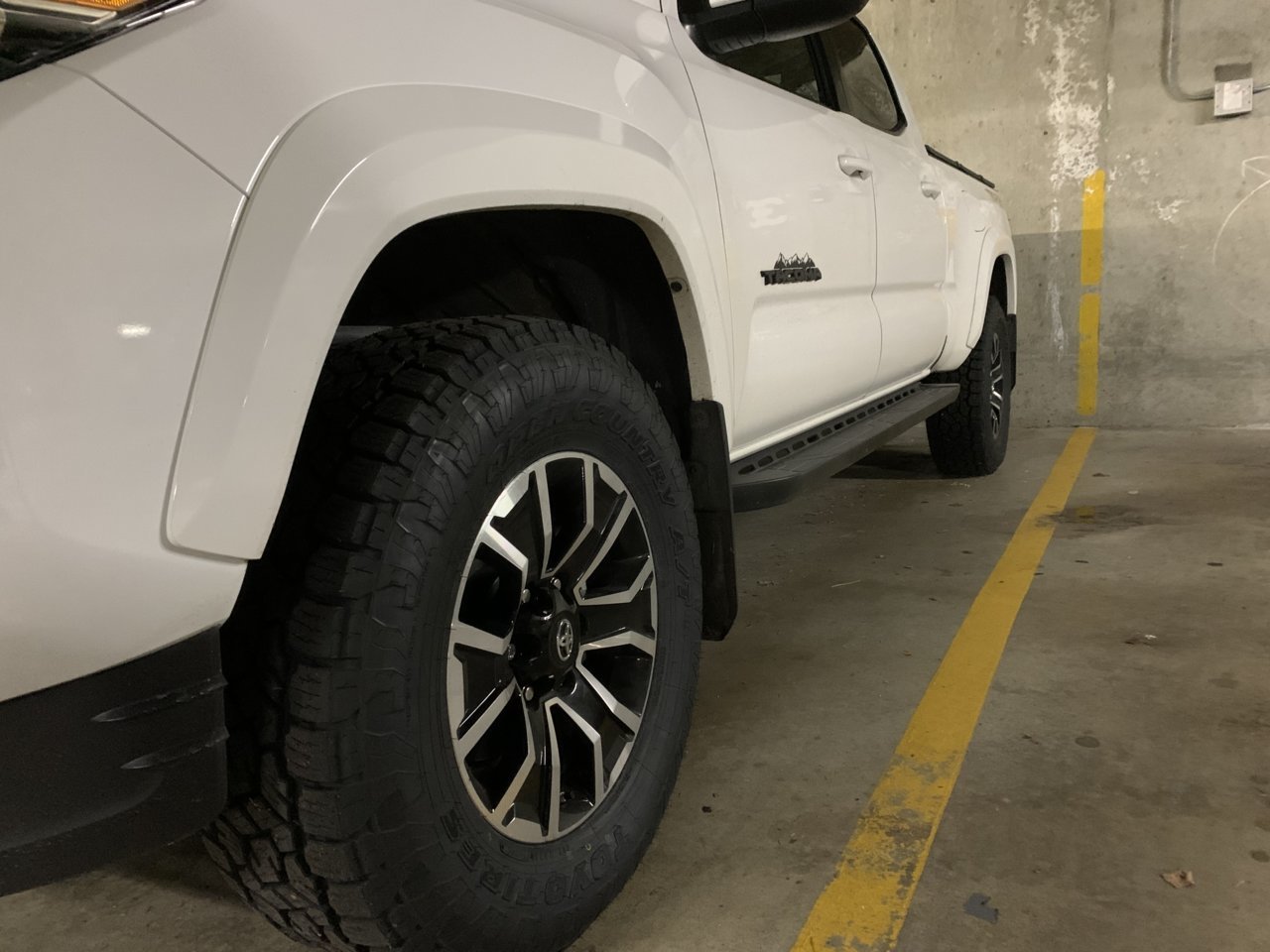

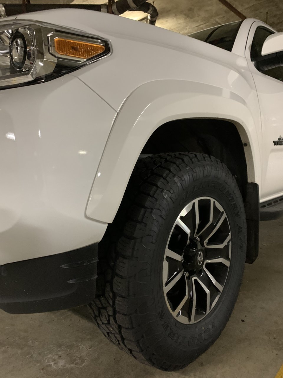

    Finally arrived after a 5 week wait. Hard to get these around here.
    First foray into a A/T tire. Always ran Michelins LTX M&S for many trouble free years. We also went one tire size up from stock. Tires look better in person than in the photos.
    First impressions after driving with the OEM Firestone Destination LE’s2 for one year.
    1. My TRD Sport looks more like a truck. Love the look.
    2. Truck feels more like a truck while driving.
    3. Can feel that It sits slightly higher. Wife is short and noticed the 1/2” right away.
    4. A little more road noise with these. Not a problem tho.
    5. We feel a lot more confident about heading deeper in the bush with theses tires.
    6. No rubbing with the slightly larger P265/70R17’s. Stock wheels, all mud flaps and front spoiler still on truck.
    7. May see a slight increase n fuel consumption.
    8. No vibrations. Balanced with no issues.
    9. 3 peak snowflake rating.
    10. Comes with a $70 rebate. Mail in tho.
    Funny, my brand new 1992 Toyota 4X4 came with 31.5” tires from the factory. I see how much influence EPA and fuel economy figures weigh in on product design these days. This new truck should of have come with 31.5” tires from the factory.

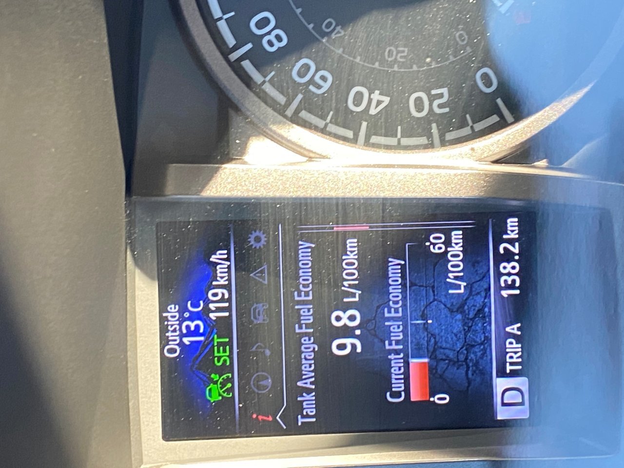

    Took her out for one last hunt...was pretty happy with the fuel economy

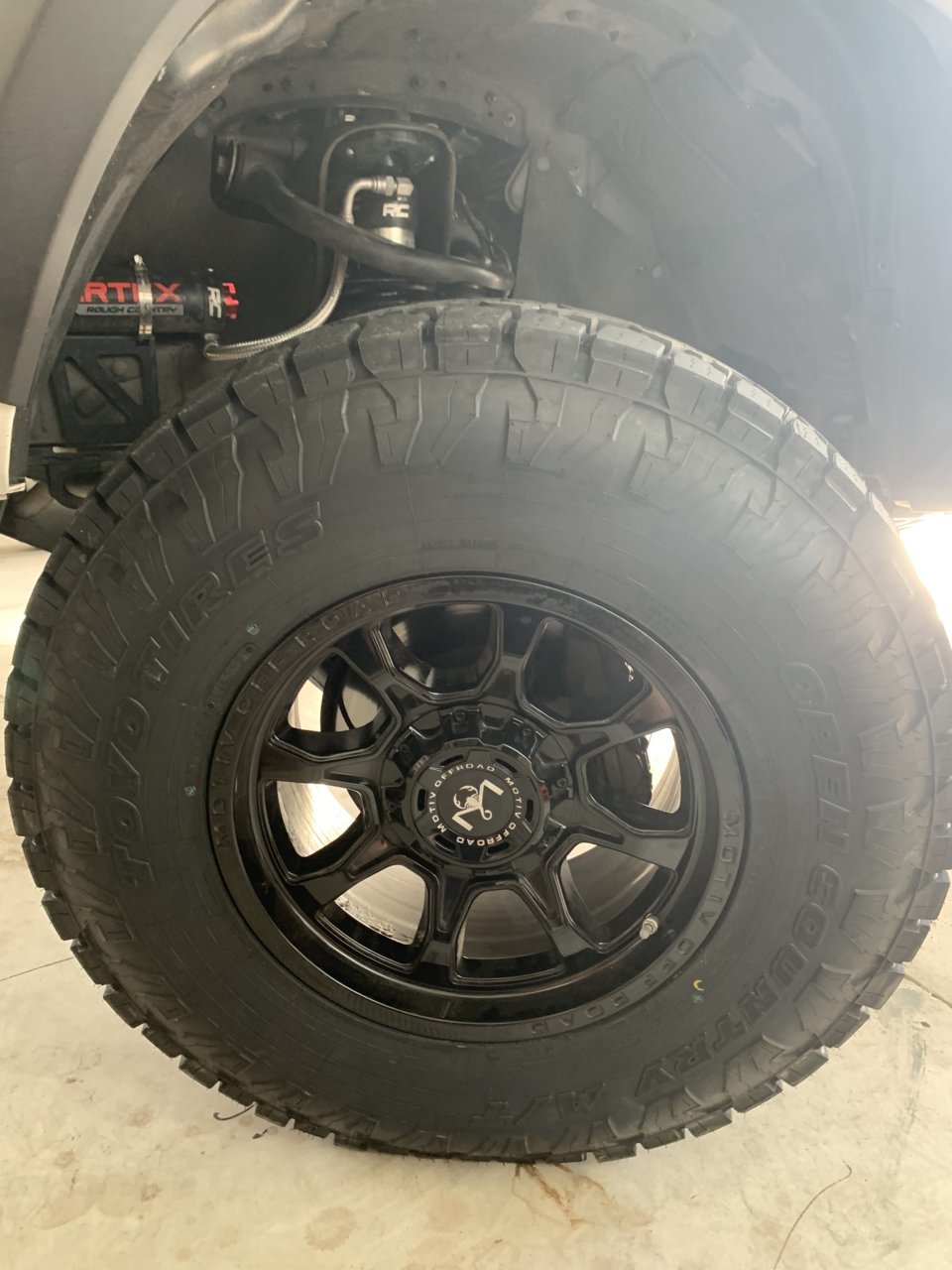

    just a couple of things tbh
    had these for a few weeks now and so far they have been great! (besides the road noise tbh) overall the tires ride a lot smoother and seem to grip a lot better then my falling apart stmaxx i had but the one down side is the fact of how loud they are i think they are louder then the stmaxx tbh but besides that they have been great.
    havent been offroad with them yet since i still rub in places and still have to fix it
