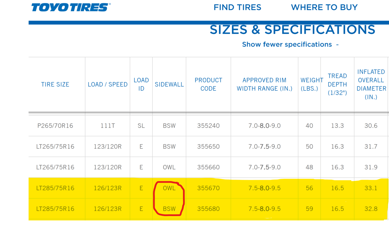

    Any Idea why there is weight difference and height difference when seemingly the only change is Outline White Lettering? @dToyo AT.png

    When bought mine I asked this exact question, I had no idea why letters would make a 3 pound difference but the tire guy said thats what it is. The White letters are smaller than the black letters which was the reason, I was thinking BS the entire time he was talking but thats what I was told.

    An Outside White Letter tire is usually made by adding an additional strip of rubber to the sidewall of a tire, then shaving it down to reveal the white color. This should, in theory mean a OWL tire would always either be the same weight, if not a little heavier than its BSW counterpart.
    We reached out to Toyo this morning for clarification and its likely this is an error in the weight on their site. The rep stated they have contacted the engineers and factory to make some confirmations and will update the website accordingly. They are also going to confirm the height information however the height is understandable as different tire molds can have different true OD's even with the same tire size.
    Great call out on this!

    Thanks for the quick update. I ordered my AT3 this morning before seeing this. Im trying to save some weight where I can chose AT3 over Grabber ATX (57lbs) partially due to weight. Please update me when you can, I have an install appointment Saturday 3/26/21 ata discount tire here in Austin.

    Thank you for your business!
    Unfortunately we won't get any follow-up from Toyo. The rep who I spoke with looked over the info and confirmed it is likely an error and they would look into it and update the website if needed. It is unlikely that they would have any details by Saturday.

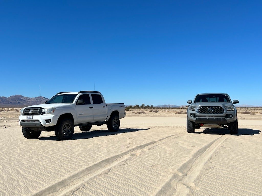

    I guess I'll drop my .02 cents as I just hit 15k miles on my Toyo at3s.
    2014 TRD OR
    255/80/17 on TRD 4runner wheels
    Overall I am pretty impressed. Definitely would buy another set after this.
    Tread wear has been excellent (my BFG KO2s sucked comparatively). Tires being rotated every 5k miles.
    Minimal road noise.
    Good (not great) in the rain but I'm sure the 255 width isn't helping here. My cooper discoverer at3s (265/75/16) worked better in the rain.
    Zero issues keeping up with other trucks that have 285+ width tires in the sand dunes.
    Cuts through the snow pretty good.
    Ice...does any all terrain actually work well on black ice??
    Biggest upside with the $6/gallon CA gas was no loss in MPG going from a 265/75/16 to 255/80/17 as these tires are really light for a true 33" E rated tire.

    Believe they are made in two different locations. Japan I think and somewhere else i cant recall. So similar but different compounds weight difference. What i heard at least
