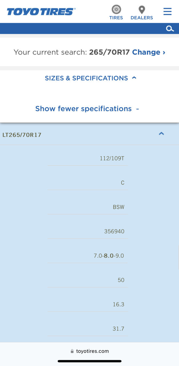

    Looks like there is now a load C LT265/70R17 coming. It has a part number on Toyo’s website, but is not listed at @Discount Tire or TireRack or anywhere else.
    Wish I had known this, I’d rather a LT265/70R17C over the LT255/75R17C I went with. I chose them because I wanted C load over SL or LT E 265/70s.

    I'm wondering if that new 265/70/17 in C load on Toyo's website is off, in terms of listed weight. Seems odd the C would be heavier than the E in the same size.

    Yeah, doesn’t seem correct. The OWL and BSW are different but still, the E BSW is only 49 lbs so the C seems high. I imagine it’s just incorrect.

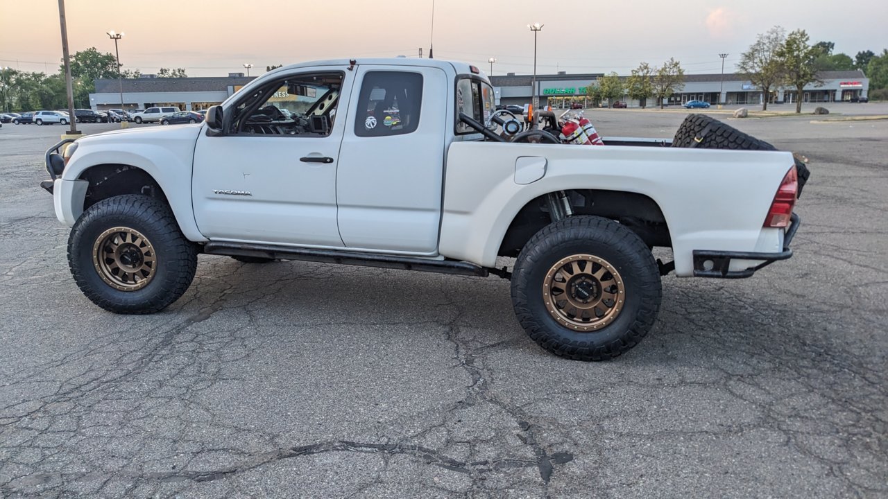

    Mounted up a set of 35x11.5r17 on my truck. Love them so far!

    Just be forewarned, these are the narrowest 255s ever. Dont mount them on anything bigger than a 7.5” wheel.

    So, I wrote to Toyo to confirm these numbers. Their reply was, "The OPAT 3 LT265/70R17 C/6 tire weight is 50 lbs. and the LT265/70R17 121/118S E/10 tire weight is 48 lbs." So they're confirming that, counterintuitively, the load C is 2lbs heavier than the load E.

    If I had to guess, the LT E is probably heavier than they say it is. 265/70/17 C makes sense being 50 lbs, as 255/75R17 C is 49 lbs and the wider 265 should add some weight due to being wider and not much taller. The E 265/70 being 48 lbs makes no sense when compared to either of the other two. But who knows. I have a suspicion that when you asked, they just read you the specs off the website, much like you already looked at.
