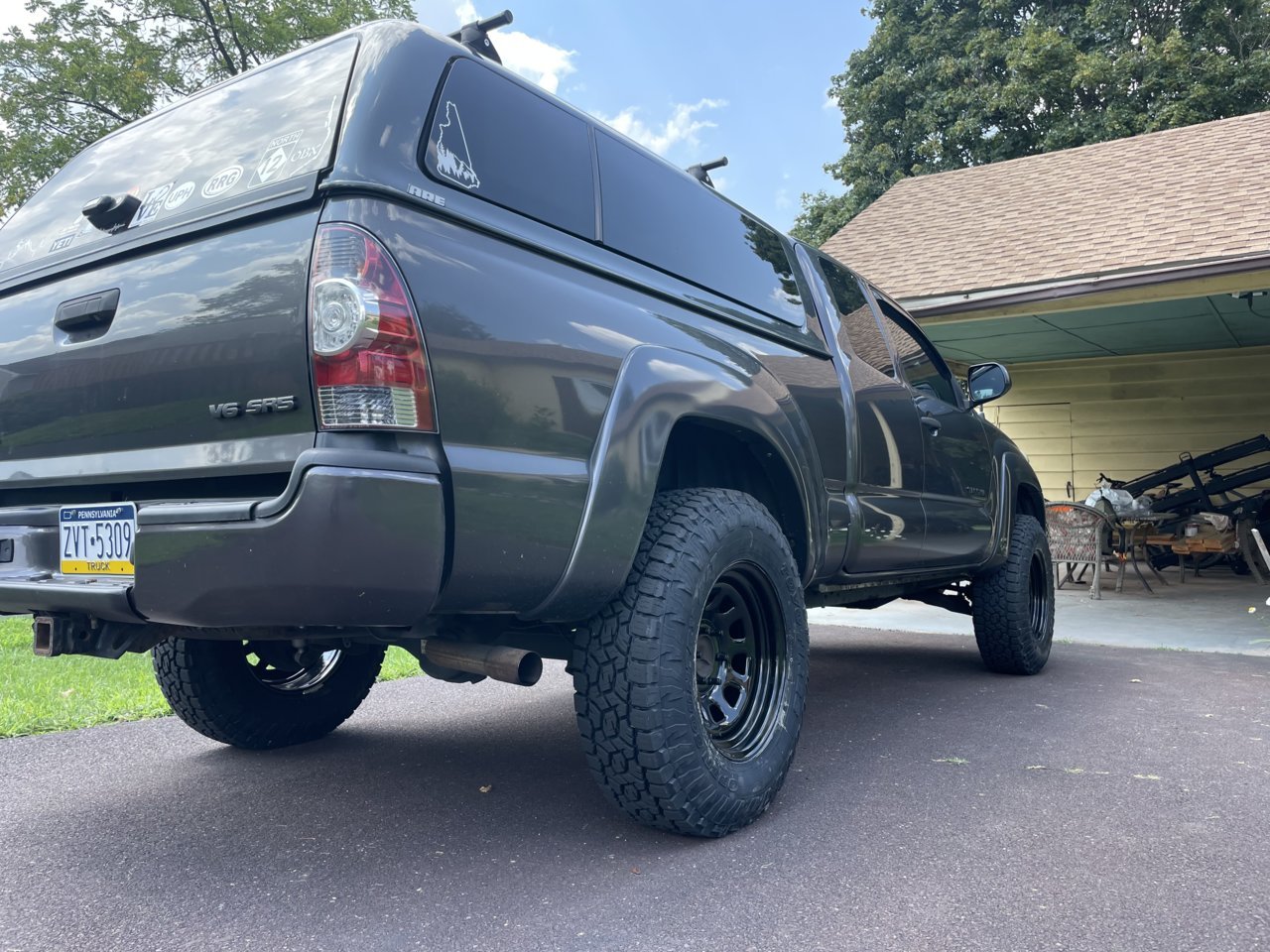

    255/80/17 AT3s mounted up and loving them so far!

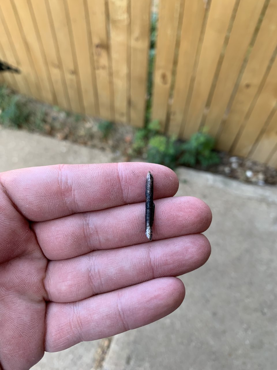

    Sadly, I found this in one of my tires during the rotation….
    Not sure what I’m doing about it yet. It went into a tread block pretty deep. No full puncture, but it concerns me for the integrity of the tire long term. Don’t want a random blowout later. I’m just driving on the full size spare for now until I figure out what discount wants to do. Didn’t buy road hazard as I’ve never had an issue before.

    @BLtheP rest assured that if the tire has not lost any air, you will not have a problem in the future. At 16/32nds of tread it would have to be much longer to penetrate the liner and leak. Consider it a full depth tread sipe at this time.

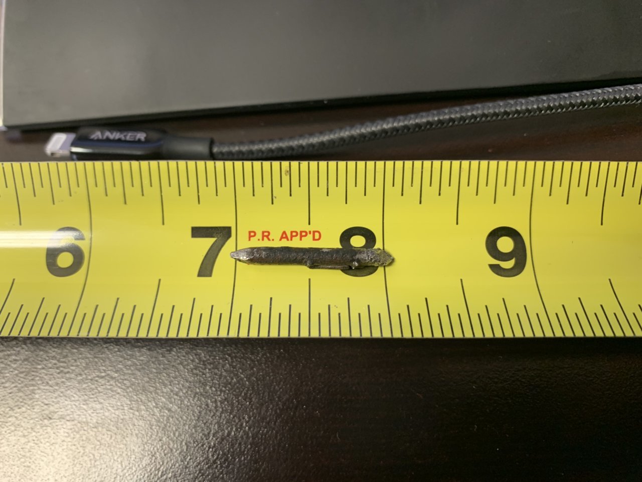

    Thanks. I don't know enough about tires to know how thick the carcass is under the tread blocks, I'd say about half of this piece of metal was tread block, the rest was going into the carcass. Just unsure how deep that was, so I figured I may be pretty close to puncturing the tire. But, I don't know for sure, and definitely not losing air yet.
    I will add that the piece of metal was about 1-1/8" long.

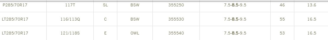

    Do the C rated 285/70r17s have the larger shoulder and deeper treads like the LT versions? I’m reading mixed reviews as to wether or not they do.

    @Ilove2dubb the tread depth on both the LRC and LRE are the same. The P rated has less thread depth than the LT versions. 16.5 and 13.6
