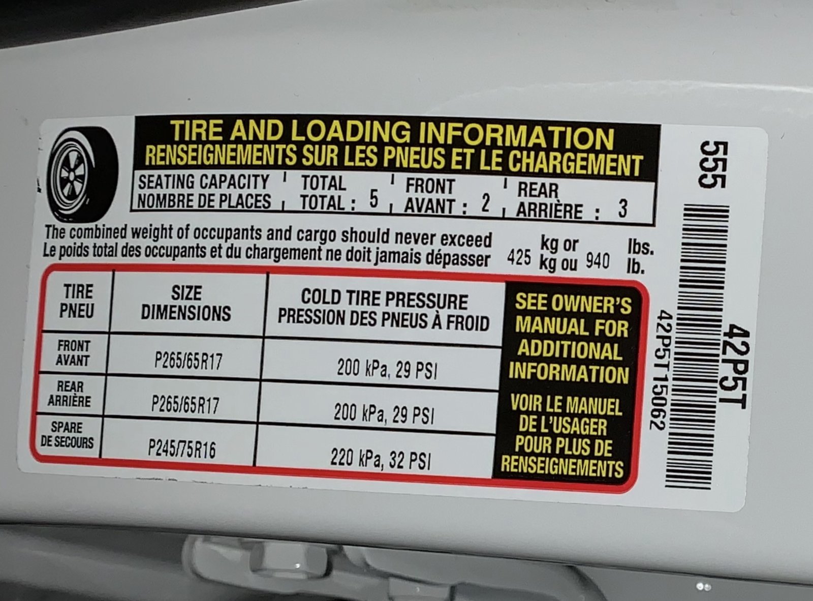

    I’m surprised yours said 26. Never seen that on a 3rd gen before. When I do a search on the Sport tires I’ve seen (P265/65R17 29 PSI), I get a conversion of 37 on LT255/75R17. Same for when I do that conversion starting with 265/70R16 SL 30 PSI TRD off-road tires.
    Either way, our trucks are the same and 37 should be the cold number. Mine will reach 41-42 on a hot summer day on the highway but it works well and I haven’t felt it was harsh. A little bit harsher than the old tires initially but once I got used them I didn’t find them harsh at all. Good thing is I have like 15K on mine and very little tread wear, so they should last a while.

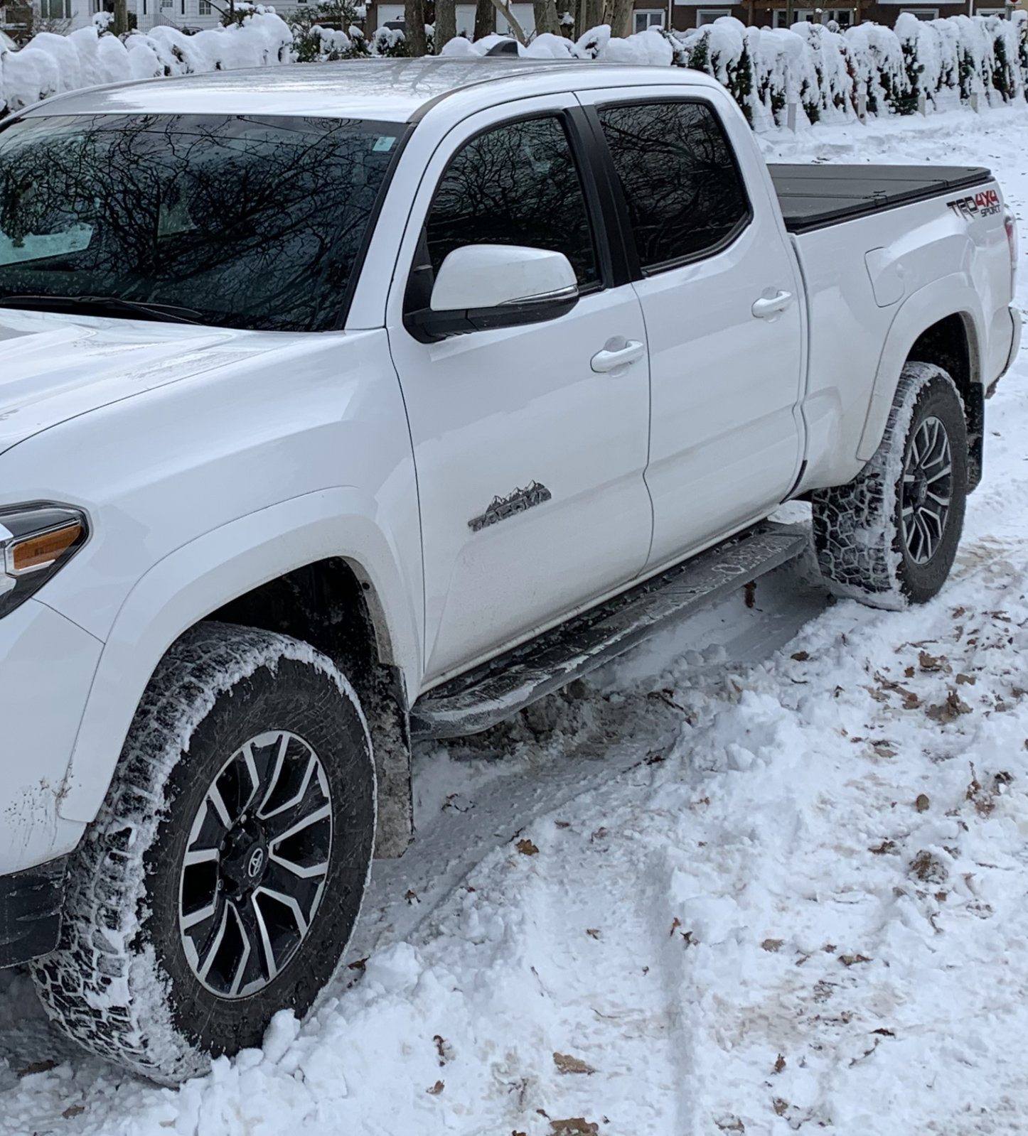

    Purchased the P-metric in a 265/70/R17. Trusted Mechanic’s shop where I bought them from set the PSI to 34. Seems to be all good. Going into my 3rd winter with them. So far so good overall. First set of A/T’s ever. Michelins all the time prior. Wanted to try an A/T for the first time. Love the looks, slight lift, 1 mpg hit. I think these Toyo’s made the transition to an A/T easy. Also, being P-metric helped as well. Initially I really was interested in the Falken’s like the cool kids, but the balancing issues I was hearing about put me off.
    Yes, stock psi is 29.

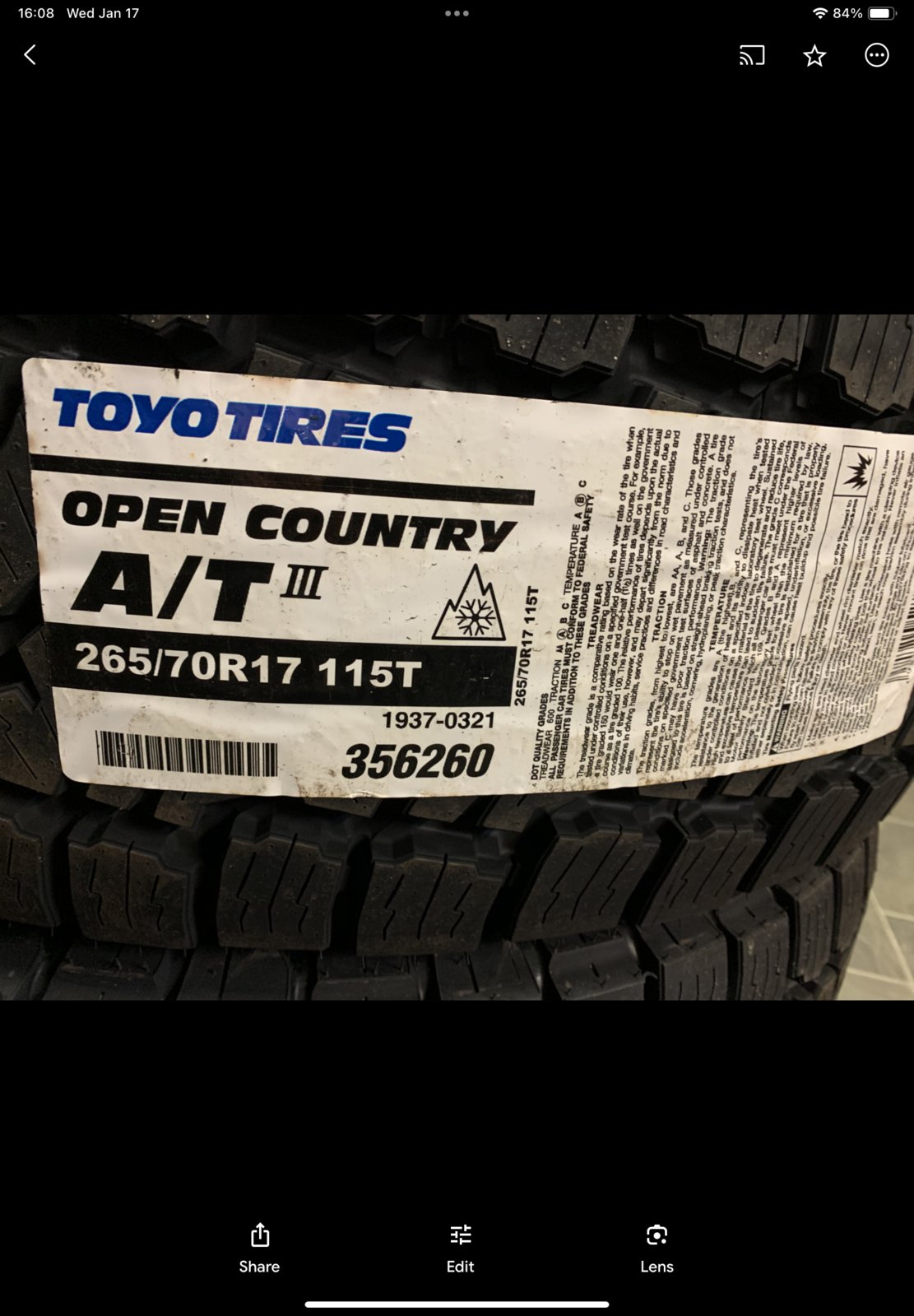

    Not that it really matters that much but technically you’re overinflated by a bit - P265/65R17 @ 29 psi (stock) is capable of 2,149 lbs. your new tires are actually just metric, not P-metric which changes things a bit. The tires you are running are 265/70R17 115T in which the closest match for 2,149 lbs is 2,178 lbs at 28 psi. So to maintain the stock load of the stock tires, you’d want to have the Toyos at 28.
    At 34 psi your current tires are capable of 2,544 lbs each which equates to 1,580 additional load capacity.
    If it handles and wears fine as-is then it probably doesn’t matter. Maybe worth playing around with if you get bored, but just thought I’d share.

    Hey, thanks for the details. You are correct. They are 115T’s. Good to know about the proper psi. It’s peaked my curiosity and I will experiment with the psi to see if I notice a difference. Dial them in as much as possible for my needs. Didn’t know the difference between p-metric and metric. I’m assuming one is European and one is North American?
