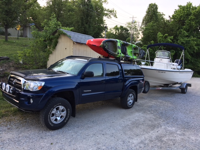

    I just want to understand, you folks are saying the GII and 4.0 is a better tow vehicle than the GIII? I do not tow in OD/4th except on flat ground and I do not tow over 60 MPH. Gas mileage is not great but not horrid either. A few summers ago but nothing has changed other than new shoes:
    Pretty typical, kayaks or bicycles, camping gear and the Whaler. So, the GIII with auto needs to be regeared? I run 265X70X17 tires, have no need for larger. Places that need larger I have TJ Rubicon for that duty:

    You'd be doing yourself a favor if you could get the kayaks stowed in the whaler.
    Anything on top is an aerodynamic barn door.

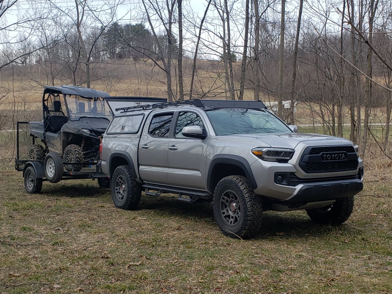

    Man, this just isn't my experience at all. I'm lifted on 33's all stock motor and gearwise. I get between 10-12.5 MPG towing about #3000 through flat to mountainous terrain. I run S4 & 5th with ETC and usually I am somewhere between, 2000 and 2800 RPM at speeds of 65 or so while towing, sometimes faster, sometimes slower. Obviously the RPM's climb with needed downshifts, but my truck absolutely does not live there. I do hit 3rd gear on bigger climbs, but my truck has 0 issues maintaining 4th simply cruising along. 5th is like molasses though. E rated 33's really hurt and with the 265/70/17's I had before it was much better. My truck would only hit 3rd gear on the really big climbs maintaining speed with SL tires.
    Your sig says you have a 17 now, so I'm assuming you traded off your AT a while ago and wonder if the latest tune makes that much of a difference. I know on my truck, bought 12/16 it made a big difference. I'm guessing the '21 would be much better than my truck since it has a different tune anyways.
    While there is some airflow differences for sure between a camper and my SxS, it sticks out in the air enough to have a negative impact. The windshield alone knocked almost 2 MPG of my tow MPG. My cargo trailer gets similar MPG and has the same airflow characteristics as a camper.
    MT has some distinct advantages, but OP has already ruled that out.

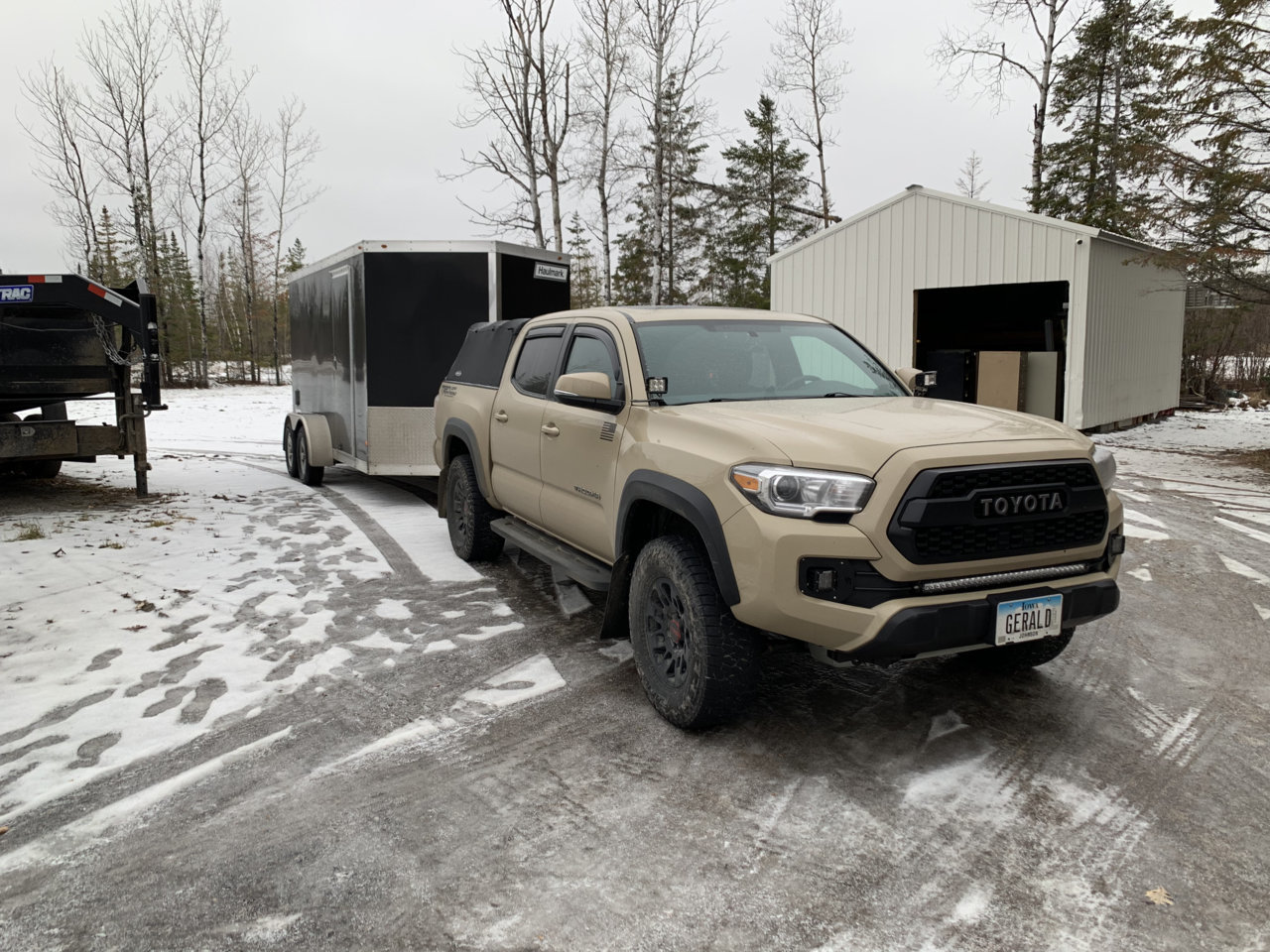

    Yeah i traded it off Spring of 2017. I was already up to 50k miles on it and decided I either needed to deal with it or trade it off before i put a bunch more miles on.

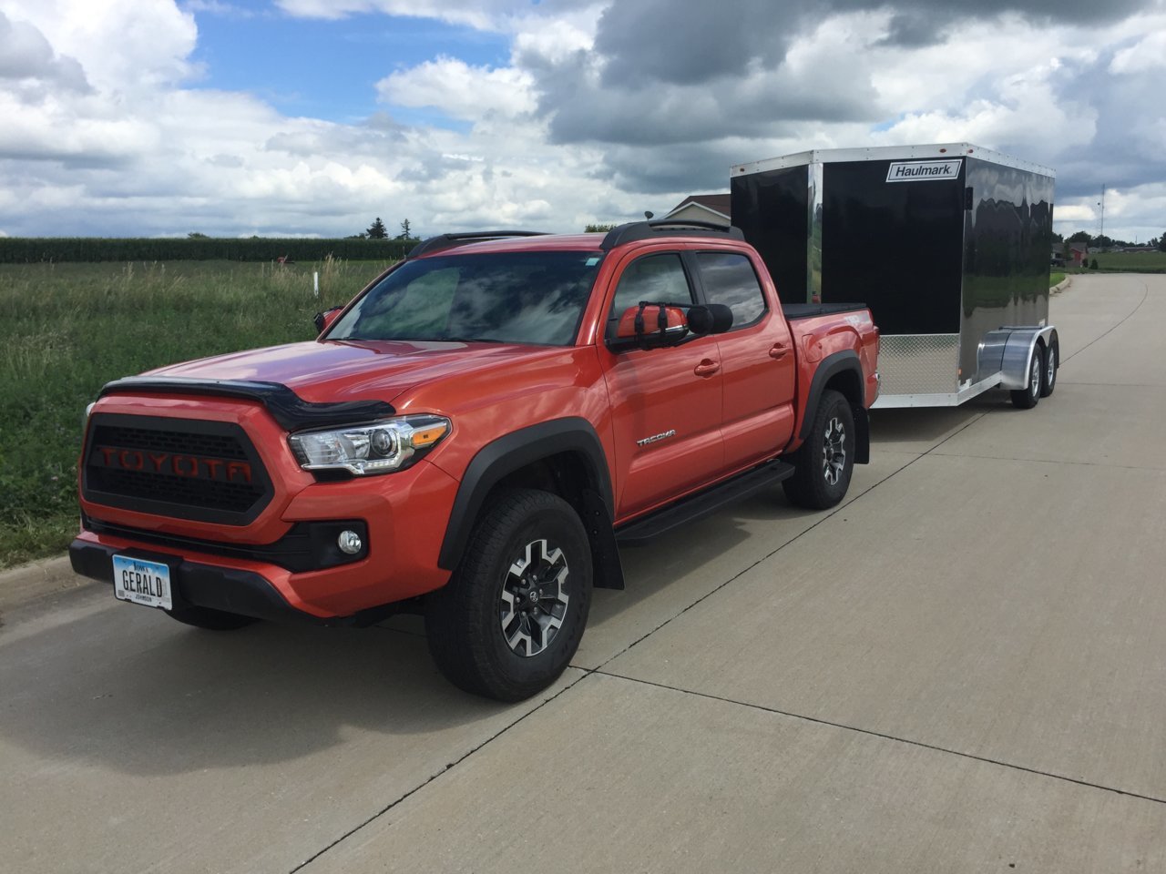

    This is the trailer I’ve been pulling (7x14 aluminum haulmark - 1800 lbs empty)
    My 2016 was a 04b00 that eventually got updated to 04b02 (which definitely made a difference.. as sad as that is compared to what’s available now). I’d usually go S4 and it would still dance 3-4-3-4-3-4-3-4 trying to maintain 65 on flat ground. I think the best trip i ever had was 10.5 MPG
    Same trailer, i can tow in 5th and rarely ever need to downshift. Usually around 14 MPG at the same speed / area as I went with my 16.
    I’m definitely impacted by wind resistance just due to how tall my trailer is (6.5’ interior vs normal 6’). I’m assuming a boat or something else low profile is going to see better MPG but its hard to say how much. I’ve got no doubt the newer ECU revisions have improved things (I’ve gone from 04b12->04b13->04b14) and have seen them help my MT.
    There is only so much tuning can do though. In my experience, the gearing makes this truck completely different too. When i first drove a 3g MT, I couldn’t believe this was the same truck.

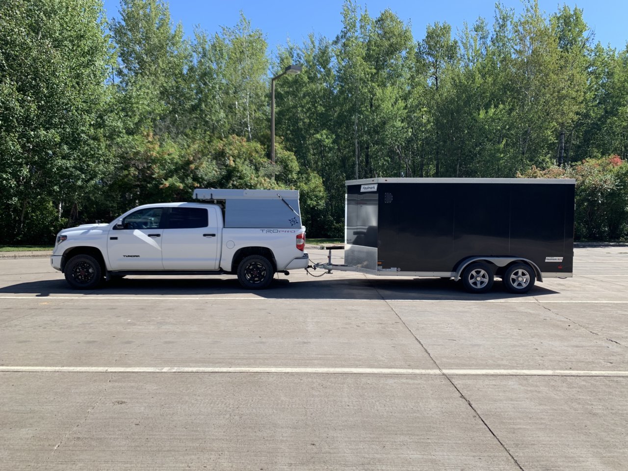

    I can pretty consistently get 12+ with my current tacoma lol i also had a Turtleback trailer for a while. Around 14 pulling it.
    About 10 with my tundra, but the habitat kills my aero in general though. I went from 17 -> 14 after i put it on :( the 38 gallon tank makes up for it though.
