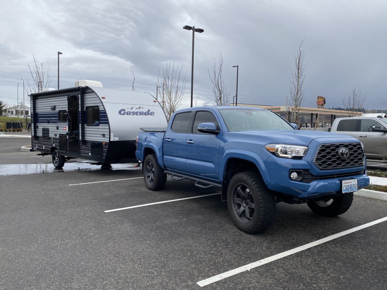

    I don’t think anyone has said it yet but on the A/T Gen 3 trucks both 5th and 6th are overdrives. Coupled together with the 3.91 is does leave a little to be desired.
    Our first trip camping was over the weekend. Trailer is 3400lbs dry and probably 4K with gear. The truck does fine in S4 with ect on. Once it gets steep it drops into 3rd. On the 120 mile round trip we averaged 11.3mpg. Saw trans temps reach 223 momentarily as we neared the top of a climb and dropped back down to sub 200 within a couple seconds of creating the hill. Is the Tacoma an ideal tow rig? Not really but it isn’t terrible either.

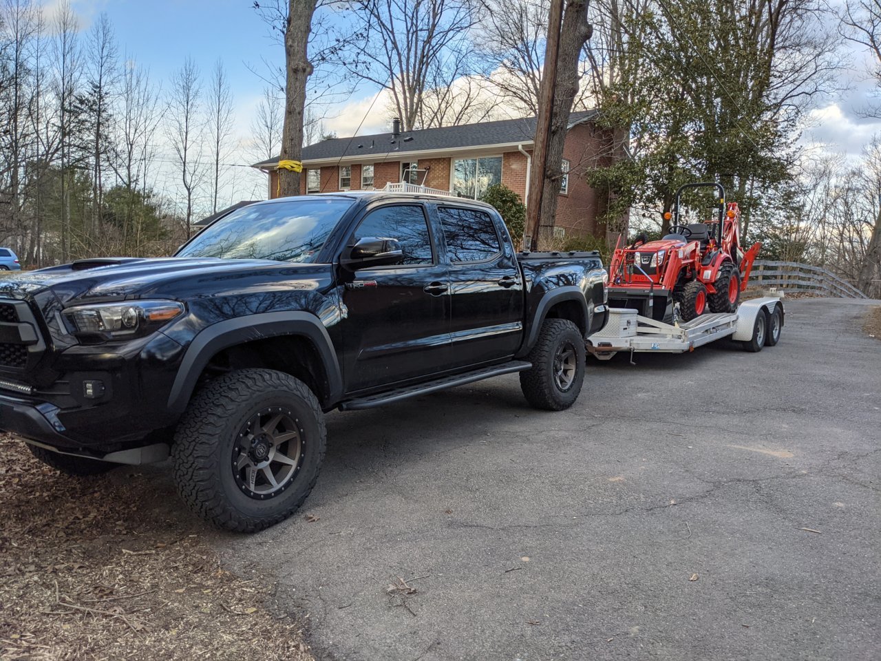

    Just brought this bad boy home on Friday. Probably around 5500 pounds total. The Tacoma did fine for the 60 mile trip home. This was the first time I pulled anything substantial and I was pleasantly surprise. Definitely took a MPG hit but wasn't paying attention to that while I was towing. I run Woolwax for rust resistance and so far doing well.

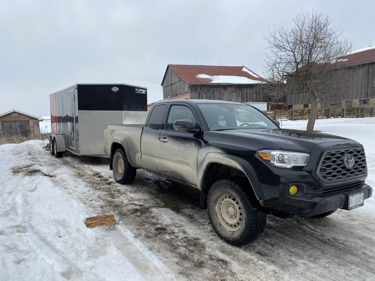

    I tow this weighing in at about 5500 lbs loaded. Does just fine. I would not be worried at all towing 3500.

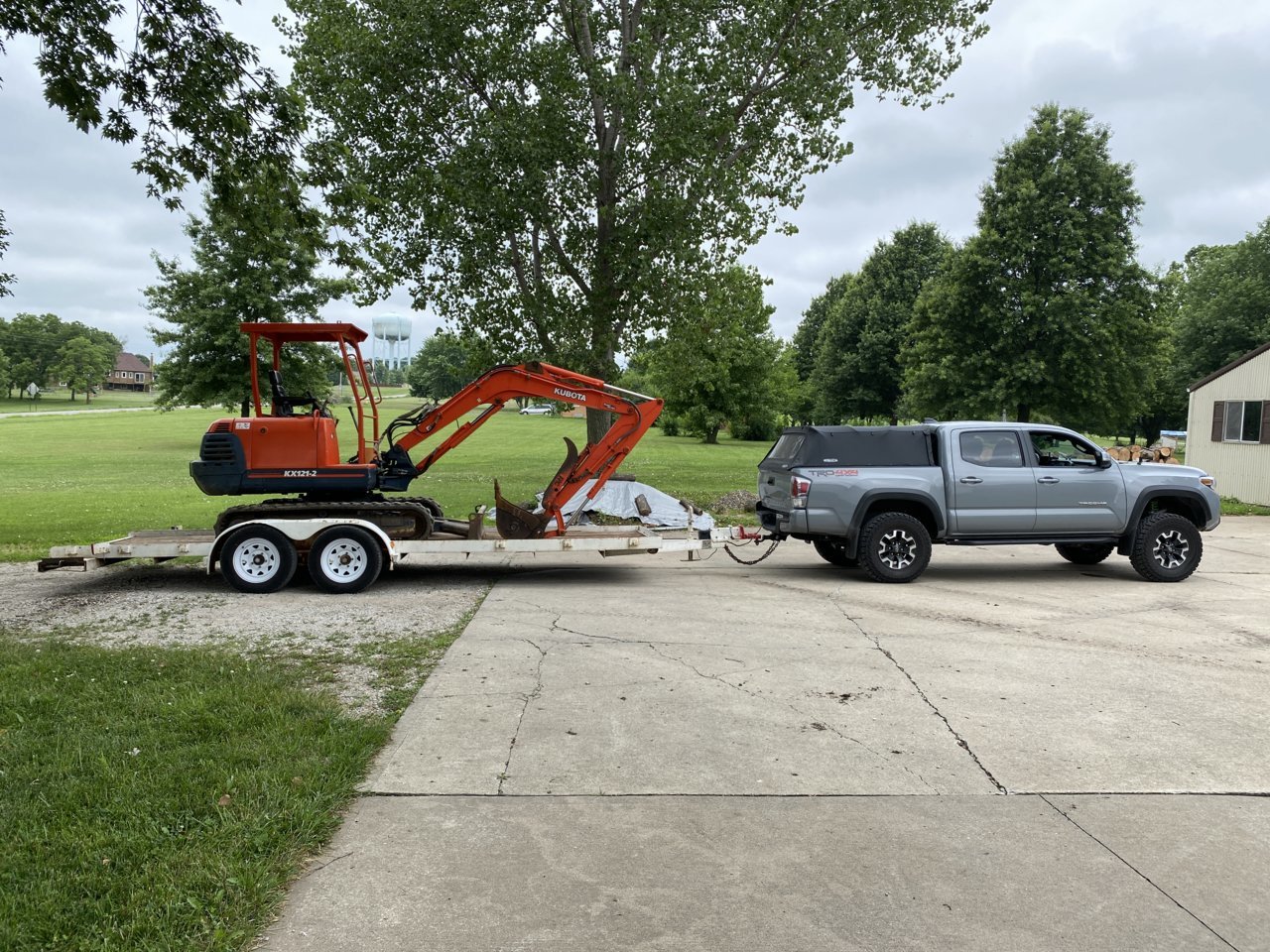

    It will tow well outside its weight limit. 95D03239-B9D5-478E-A0F9-8BF364D5F6CF.jpg

    Any truck will. However, towing and safely towing are 2 different things. Thus the ratings.

    Very true statement. I only moved the excavator a mile down the road from the neighbor. Also without the trailer brakes and upgraded rear leaf springs I would have never tried it.
