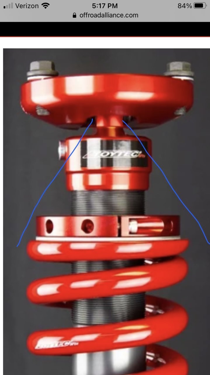

    Thanks guys for all the info and pictures. Please keep the info and pics coming. I have a 2011 and am considering these bad boys. Quick question. Can these be adjusted on the truck?

    They can, but it is a pain in the ass. I would highly recommend putting them in a spring compressor to adjust them.

    Do you mean a pain because of access to the collar or because of the preload on the spring?

    Truck on Jack stands with suspension at full droop. Collar lock nut loosened one turn from tight to adjust and I broke their provided tool. I used a long steel punch and bent that too. I also was using a breaker bar. They don’t recommend doing it on the truck and I agree. It also puts a lot of stress on the top bushing. I added one turn and called it a day.4A10EB88-22BF-4BFB-9172-4A0A3548E745.jpg

    WOW! OK good to know. Hey thank you for that info much appreciated!! Something to keep in mind for those wanting to make adjustments on the truck. Like myself.
