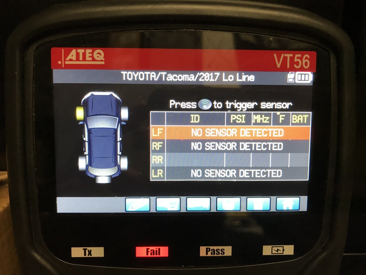

    The shop I went to does have a programmer. When they hooked it up it read no sensor detected

  17. May 31, 2021 at 1:33 PM

    Project_SR
    Project_SR [OP] Active Member
    May 17, 2021
    #365979
    33
    2017 Toyota Tacoma SR
    This is what popped up
  18. May 31, 2021 at 1:33 PM
    #18
    CanadaToy
    CanadaToy Well-Known Member
    Nov 7, 2013
    #116081
    1,712
    Greg
    Toronto
    17 DCSB TRD OR Alpine
    TRD Pro grille & skid, OEM tonneau and roof racks
    Did they scan the sensors for the code? If not, they're idiots.

    No I did not. Now I know they didn’t come programmed now
