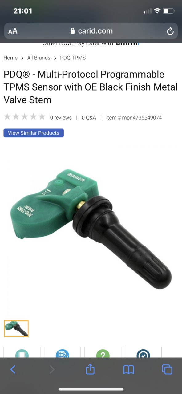

    I bought everything off CarId. They said it would work with my truck model

    The picture of the sensor shows an I.D. number printed on the sensor so they have a preassigned I.D. and don't need to be "programmed".
    A handheld trigger tool that you point at the valve stem should read and display the I.D. number of the sensors (and wake them up if necessary).
    The ATEQ tool that you pictured should have been able to do that. It's possible that they entered the vehicle info wrong. I noticed that it said Low Line which might be correct for your truck but not for the new wheels and sensors (steel vs. alloy). If there is an option for High Line on the tool, that might work. If another shop with a different tool still can't trigger the sensors, then something is clearly wrong.
    I'm kind of surprised that the place you bought the wheels from wouldn't trigger the sensors after mounting. That would allow them to supply you with the I.D. numbers, wake them up if necessary and insure that they didn't get broken when mounting the tires (which is more common than you might think).
    Edit: this is what comes up when you search for the mpn of the sensor shown in your picture.
    https://www.carid.com/pdq-tpms/multi-protocol-programmable-tpms-sensor-mpn-pdq-001oeb.html
    It says that it is a programmable sensor that does need to be programmed to your vehicle but the description states that it comes already programmed so a call to CARID would probably be in order. Also, vehicle fitment section for that sensor does not list any Toyota vehicles.

    I’m thinking the seller meant that those universal or, multi-vehicle sensors you bought were “pre-programmed” for a 2017 Tacoma (any 2017 Tacoma).
    You’ll need to first scan each sensor at the wheel to get all four individual sensor ID’s, then you can plug into your truck with a scan tool and enter the new ID’s.

    That's what the ATEQ tool pictured should have been able to do but wasn't for some reason.
