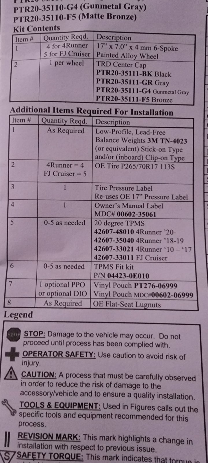

    So I got my wheels in today and there was some handy paperwork inside the box. I decided to buy new OEM TPMS and got the particular one Toyota said was for my truck. The part number of my new sensors is 42607-06012 witch is not listed to go with these wheels. So my thought was... as long as they are 20 degree sensors they should be fine. But I can't find any specifications on these to tell what angle they mount at. How can I look that up?

    Just part of the paperwork inside the box
