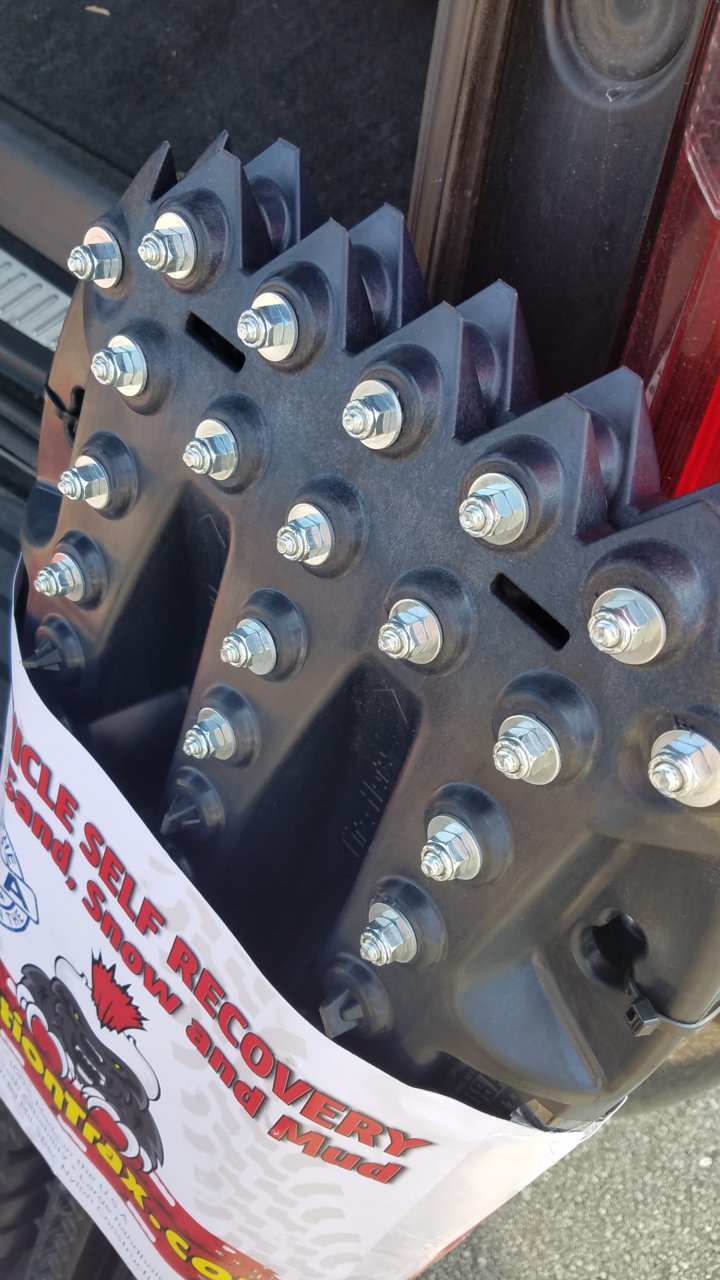

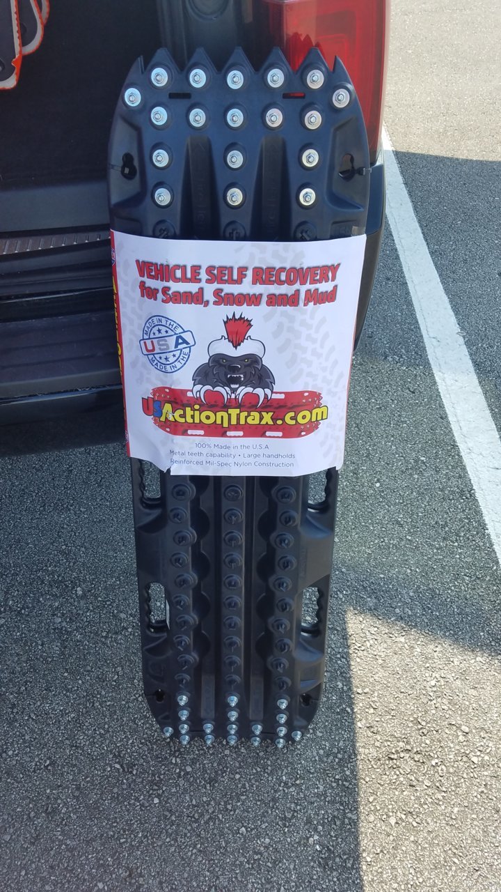

    Anybody seen these or have used these before? Never seen these before and I was able to convince my company to get these purchased for my work. Won't be able to test them for a few more weeks to a month from now. And it will be my first time using traction board type of recovery, period, so any advice would be helpful. But rest assured they'll definitely get used and I'll have a report about them later.

    Don't spin your tires.

    Look like the stack nicely.

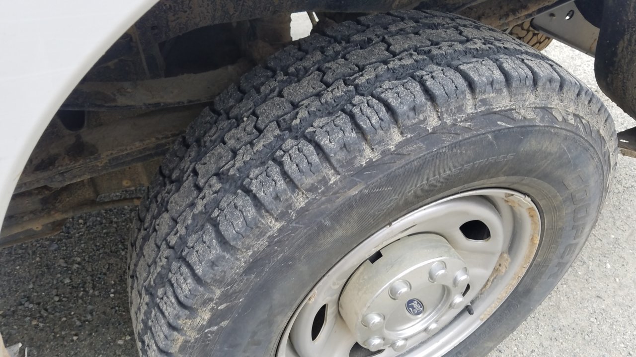

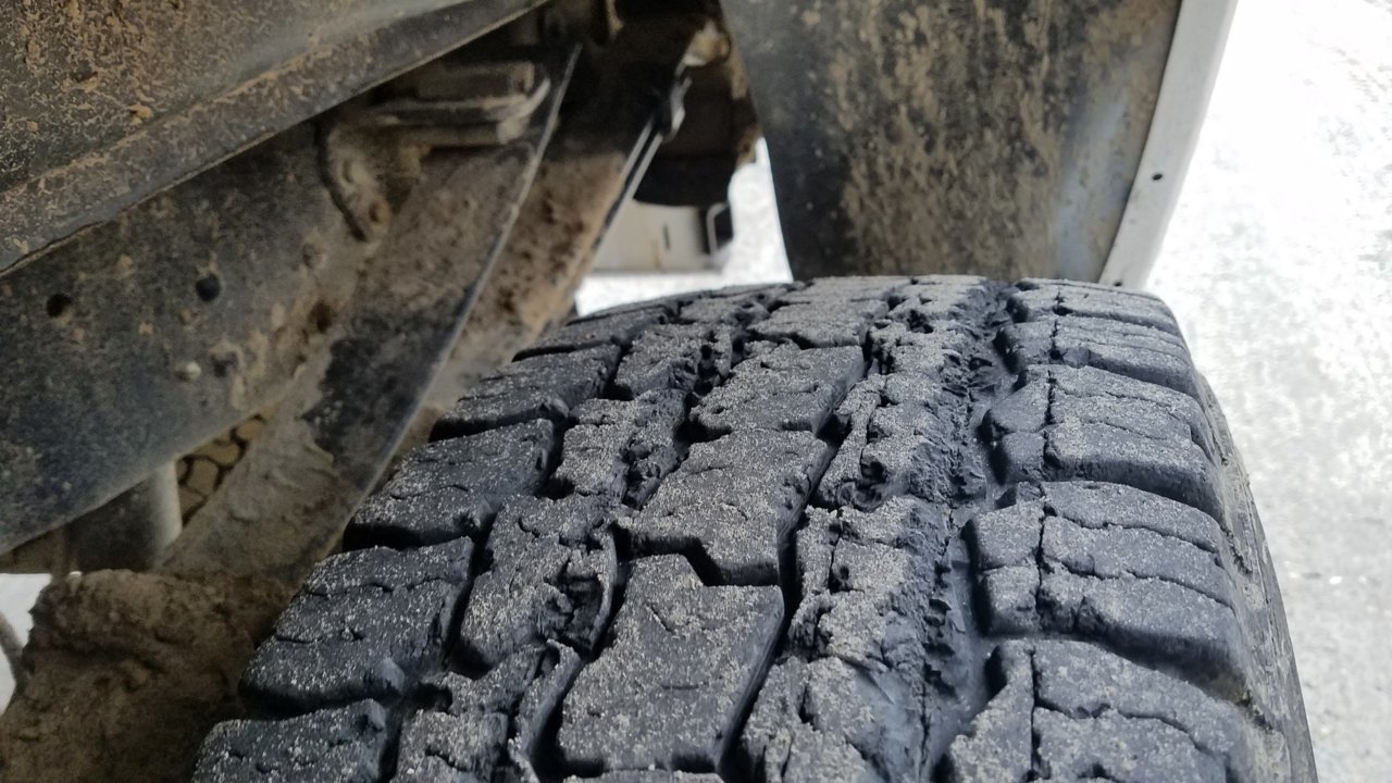

    Ya that's a true statement

    Daaaaaaamn

    Holy moly. What do the boards look like?

    Forgot yours have metal studs.

    The metal studs are unscathed, of course. The plastic knobbys in the middle were rubbed down passed the base. So if your traction control is off, this is most likely the outcome. I would reccomend to either keep traction control on (which all the recoveries I've done I've made sure they're off) or replace all the plastic knobbys with the metal nut and stud version as shown. I'll take a pic of the boards when I'm back to the storage area they're kept (which will be about 2 months).

    That's good to know. We used them on our work truck that I was driving with (2017 Ford F350 gas with a rear locker) that got stuck. I drove upon a grassy hill in 2wd with about 63 5 gallon specter water jugs in the bed and as soon as I slowed, truck bogged down. I immediately realized it and dropped it into 4lo and rear locker engaged and deployed the boards behind the rear tires. No luck. Time was sensitive and I had to leave said area ASAP so I ended up burning the Coopers a bit. Thats between rocking back and forth with a crew deploying the recovery boards in appropriate locations of the tires. Just goes to show that you must read your lines and predict your next move b4 you get to it.

    Would this have happened with other recovery boards??

    Any board without metal studs wouldn't do that to the tire; they would just wear down, or melt if you spun the tires long enough.

    Initially I liked the idea of the metal studs (replaceable), however the tire wear issue is definitely something to think about. Maybe replaceable plastic studs would be a good compromise...

    Now you have a set of aquatreds.

    I think you're right on the replaceable plastic studs. Metal seems like a good idea on paper, but I'd rather the sacrificial part be the board instead of my tire.
