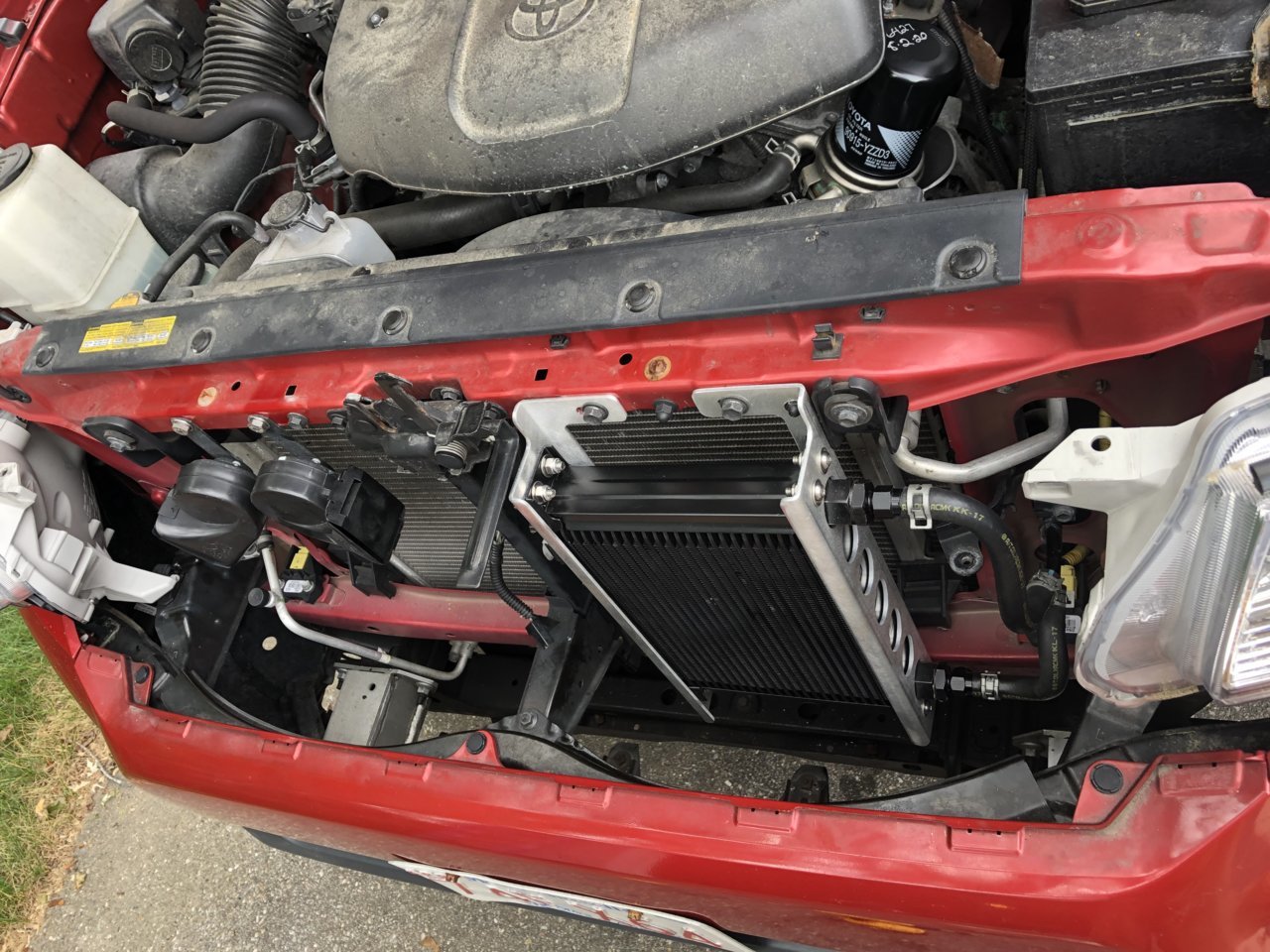

    Yes my truck has the tow package. I removed the original cooler, moved the horns over to the passenger side and installed the new cooler generally where the old one was.
    The plumbing is plug and play, but that’s about it. I used custom made brackets cut from aluminum on a water jet that ended up being more expensive than I had hoped. The pattern came from a friend on another forum (since it’s not my design I wouldn’t be able to share it).

    Holy crap, that's nice!

    Very clean install.

    Install seems pretty straight forward. I like that you only have to move the horns because I have an electric fan mounted on the PS and was hoping not to move it. Yeah, those brackets are awesome. Doing some googling, I see where Derale sells mounting brackets. I know they don't come close to what you have, but are the Derale brackets really that cheesy?

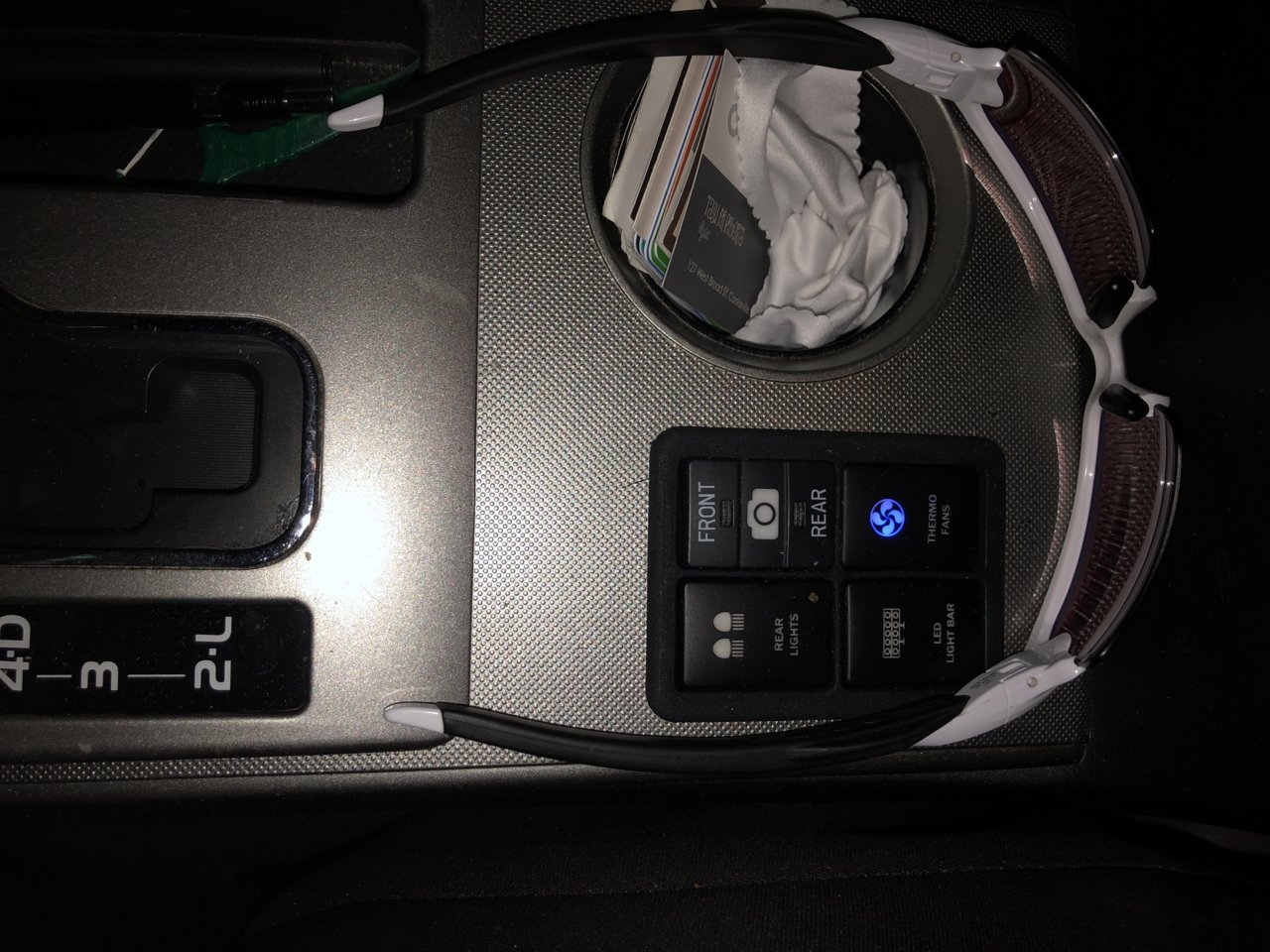

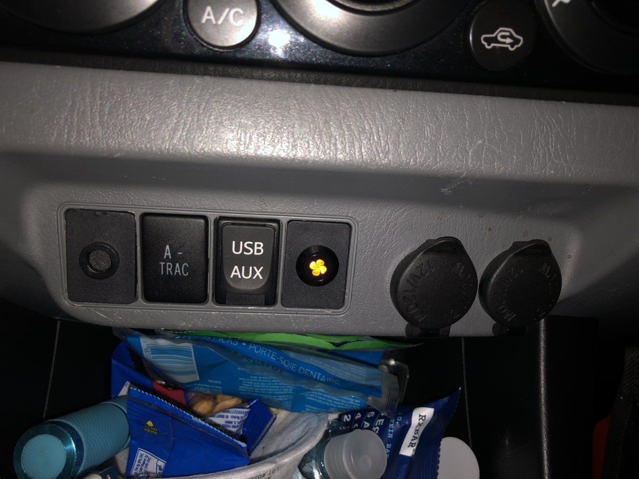

    Very nice Steevo... it's looks good... A few photos of mine..
    I also installed a fan indicator light for when the thermocouple activated the switch at 175F. Also put a switch to turn on manually.
    I installed the B&M 70298 Hi-Tek SuperCooler Oil Cooler with Fan.
