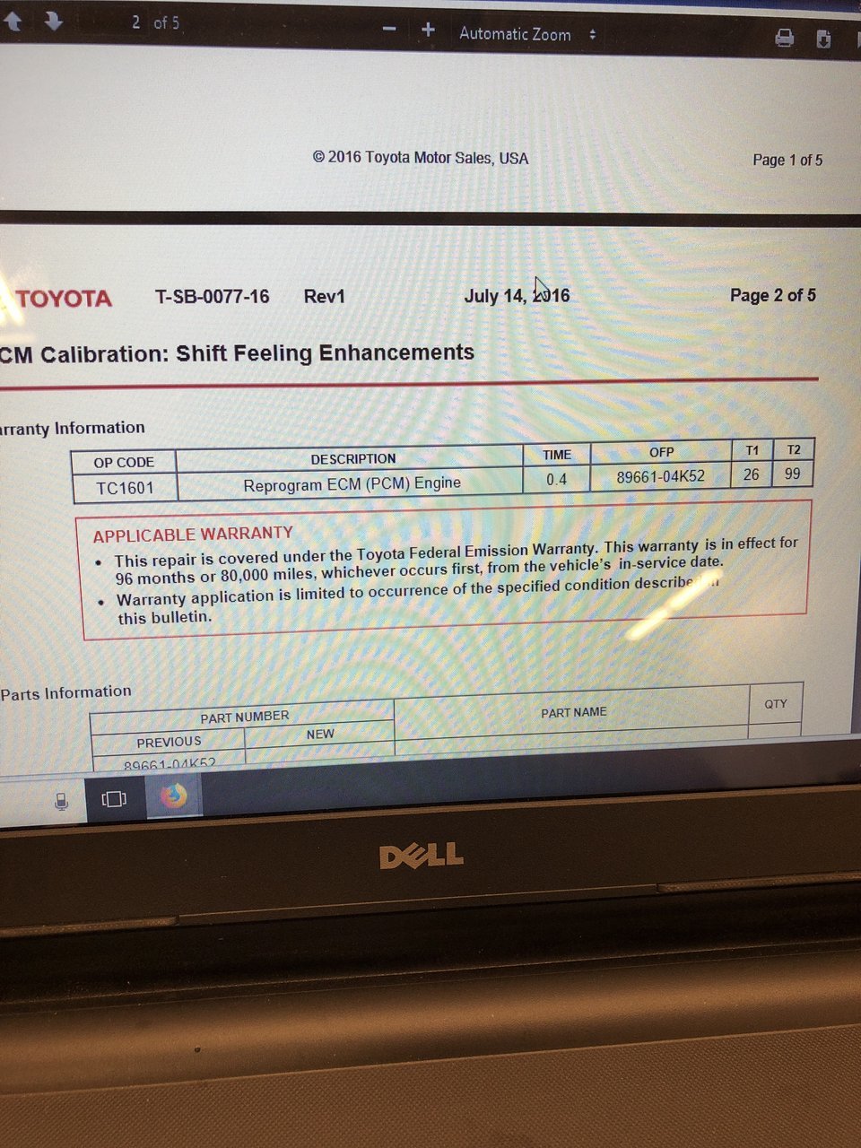

    New Member here, but wanted to update this thread as I just picked my truck up yesterday from service. I had mentioned the transmission seeming to search around for the right gear and making dramatic downshifts. Service Manager immediately said there was a computer update available, and upon driving it home I could definitely notice a difference.
    Not sure if it is Rev 1 or 2 as many of you have mentioned, but here is the verbiage from my service report:
    "TC1601 Reprogram ECM (PCM) Engine / Re flashed ECU for trans T1 26 t2 99"
    If anyone is still curious about the update for their trans, hope this helps.

    That’s just the warranty information for the dealership.
    There is no new update as of July 2016.
    Some trucks never had it done, so this is still the “new” programming for many vehicles.
    If anything new launches, I’d be one of the first to make TW aware

    Is this the one you're talking about: TSB 007-16 FOR SHIFT ENHANCEMENT OP CODE TC1601 T1-26 T2-99 FPN 89661-04K52."
