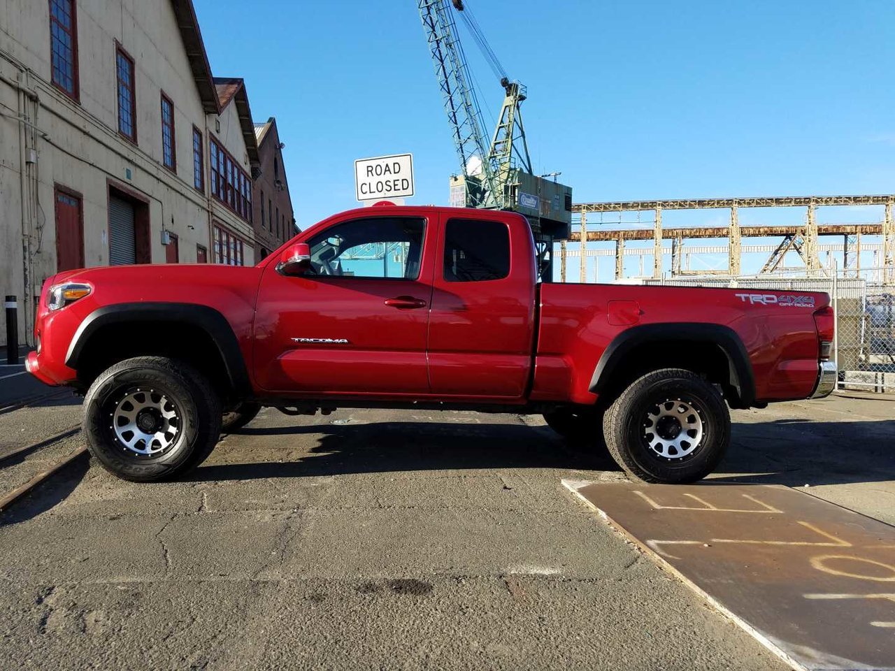

    Hasty "glamour shots" of the truck, taken at the local semi-abandoned Navy yard:

    Fortunately, that's just a visual effect of sloping ground; the truck hasn't had its suspension modified and it sits level.

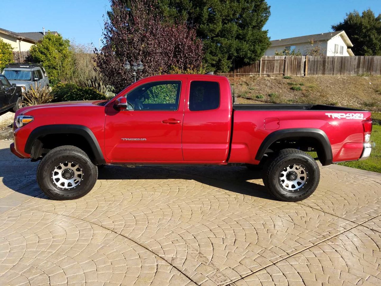

    As requested:
    The driveway isn't perfectly level, but this gives you a much less exaggerated picture. Am I incorrect in thinking this is the stock setup?

    That is a stock suspension but you have a block in the front raising the front up, probably to "level" it.
    I'd remove it before going overlanding.
    EDIT: Looks like front and rear block lift. Remove when you have a chance.

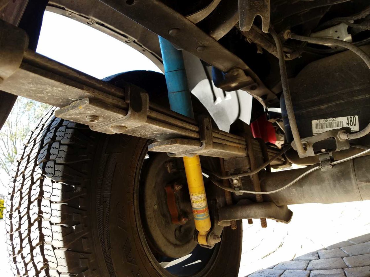

    There is one in the rear as well.

    Good Call I just noticed the brick under the leafs.

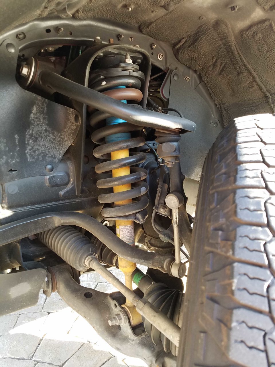

    Yup, take a look at this picture of completely stock suspension and your front coilovers. There's a spacer up top.
