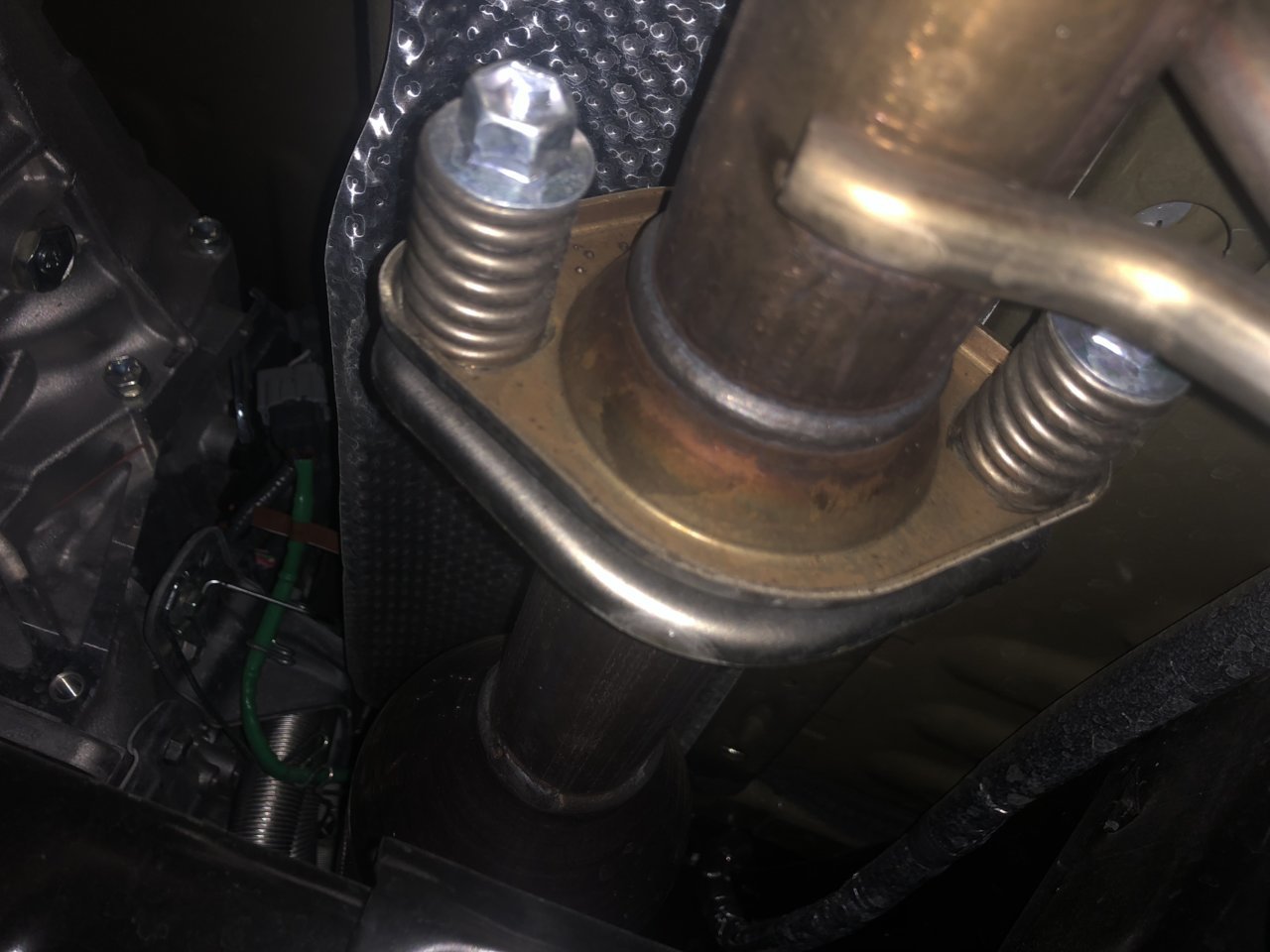

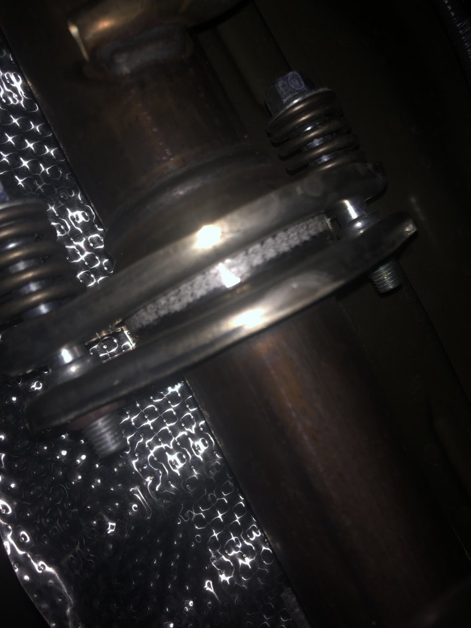

    Could this connection may have gotten loose on install? Is the small gap in the first picture normal?AA45BEB4-3E82-4384-B2B4-4B54C635E680.jpgEF18F3FE-D270-4A6A-B779-43FFD95CB0D7.jpg

    It's normal, just the protective oil on the inner piping burning off.
    Had the same thing happen on my dual exhaust. After 50ish miles, the smoke died out. Smell lingered for about 100+ miles.
    500 miles in and the loudness had mellowed out.
    I do not have that gap in the piping though.
    Also what are those spring loaded bolts?

    Looks like an expansion joint to me
