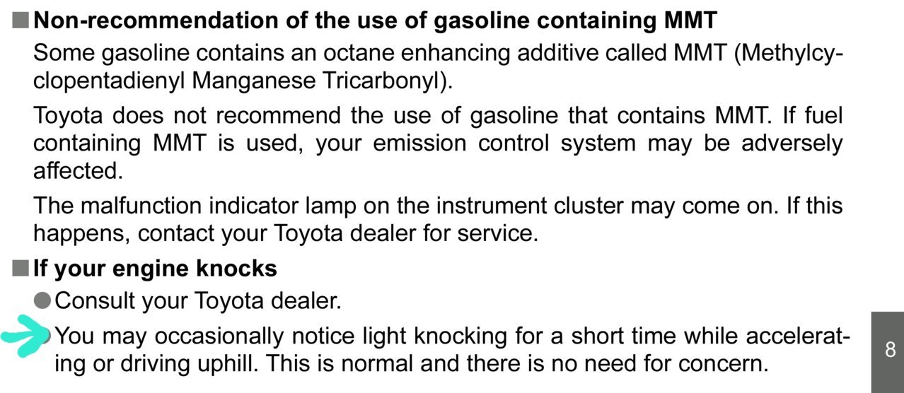

    Toyota does not flag the MIL until it calculates 200 misfires. This is because Toyota uses a calculation based on assumption.
    @Woodsie, there is this note in the manual. Doesn't specifically mention towing, but could be what's going on:
    RustyGreen and ColoradoTJ like this.
