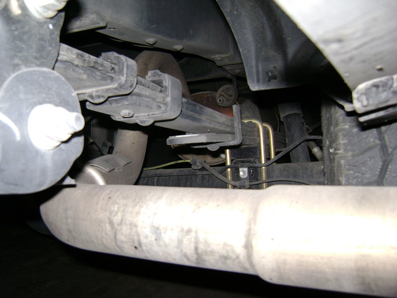

    There all like this that I've seen, here is my 15 with 9000 miles, looks the same as the day I got her, except for 3" lift. Looks like its straight I know I've always driven Jeeps I'm used to the big arch, not that way on Tacoma's.DSC02865.jpg DSC02868.jpg

    It does look flat doesn't it....but with the small space between the overload and the third spring wouldn't that show they still have some curve (if not small) to them? Makes me wanna go check my 14.

    The overload spring is actually negatively arched! That would indicate to me that the leaf pack is supposed to be flat (or near it) with the weight of an unloaded truck on it. Still baffling to me. I guess Toyota figures there's no problem with the springs going into negative arch on a regular basis? Maybe the arch of a leaf spring doesn't even matter?
