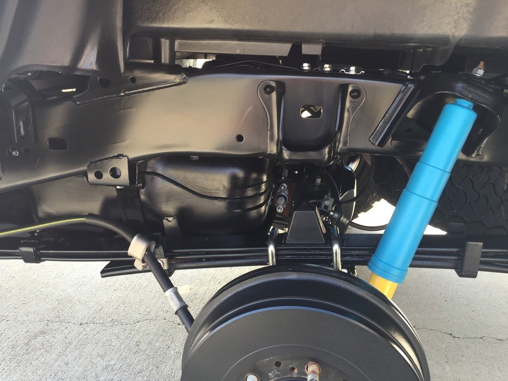

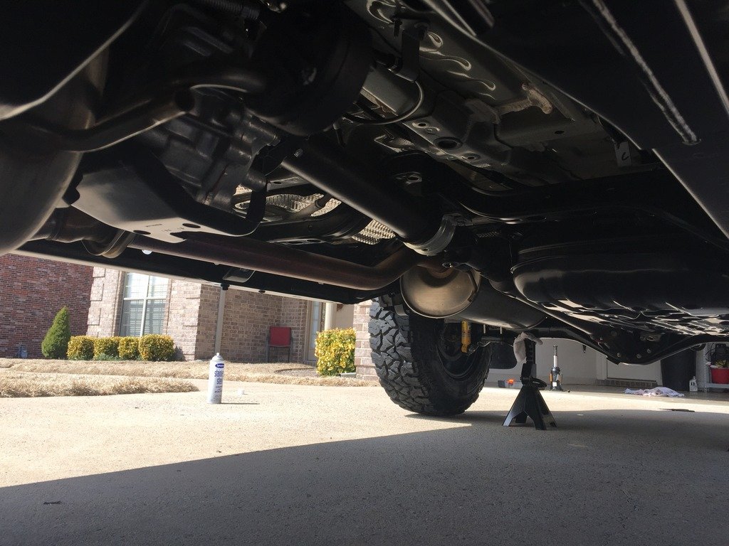

    Mine are flat. Jack stand under the axle. 18,500 miles.
    No issue with ride or off road.

    Lol... It doesn't look like that right now. I'll clean it like that every time I change the oil and rotate the tires. Takes about 6+ hrs to go from the front to the back but it allows me to check everything underneath the truck and catch any problems before they become problems.
    What it looks like right now. It's rained on and off for the last month just enough to where it's not worth washing since it's going to rain the next day. I just pressure wash most of the stuff off of it until I get a break in the weather.
    833B2D62-1B3B-414D-9A70-66E470F7F99F_zps_1d1828305676eb72ce47cd5c607c2e61c1e669ed.jpg
    What it will look like once I'm finished again
    Last time I actually washed it.
    46CF88CC-4D51-4C63-B0A6-8F21779E117C_zps_9d8ccbf39921d9cdae4281cf68d2ef39001dc6ff.jpg
