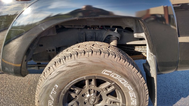

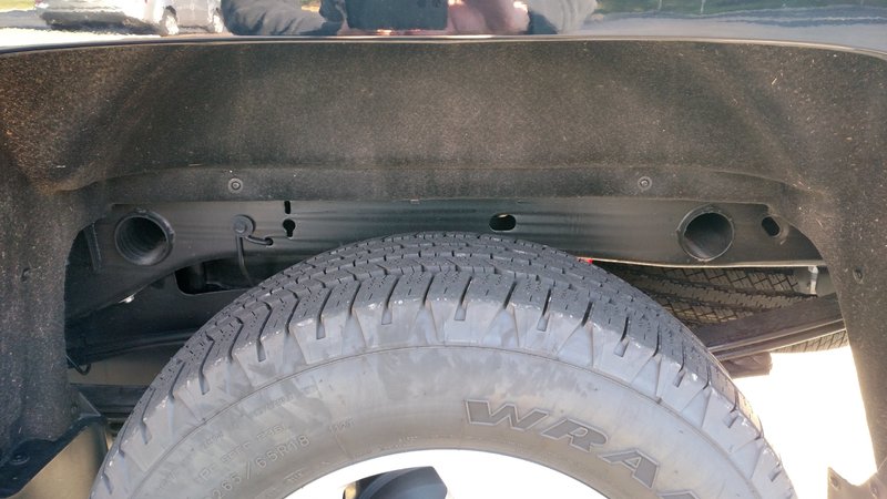

    just checked out two 2015 Silverado's here at work. both have curved rear leaf springs. they look like what I would expect rear leafs to look like. there is much more curve to them than my Tacoma had before I put the air bags on.
    shakerhood likes this.

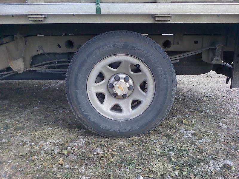

    I'll shoot a picture of our chevy 1/2, 4x4 with out the bed.

    here is a pic of the 2015 4x4. not a huge arch but not flat in my opinion (at least not as flat as mine was).
    and here is my springs after I put the air bags on.
    nice slight arch at 15 pounds in the air bags. I agree that flat is fine as long as that was the design intent. But I will also say that before the air bags mine were not flat, they were caved upward at the middle with NO weight in the bed.

    12091510201.JPG2.jpg Well here is ours with the flat bed so you can see it from one end to the other, its not completely flat like the Toyota, but compared to how they used to be they sure look flat to me.
