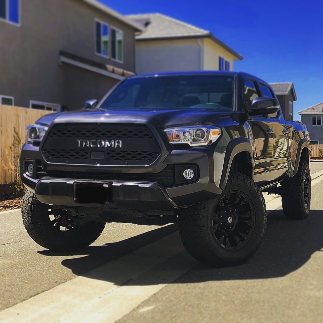

    Headstrong Stage 3 Fox with Total Chaos UCAs, Fuel Vapor 18s and Ridge Grappler 33s with an Empyre Offroad Grill.
    Waited until the 10K mark. May have done extra driving to get there faster...
