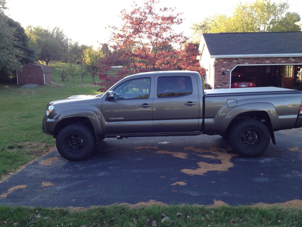

    5100 @ 0” w/ 2.5” Eibach spring, 1.5" Icon Progressive 3 leaf + 1” block, Procomp Wheels, Grill Thin Lip (Custom Car Grills Mod), Access Tonneau Cover, Pop & Lock Tailgate Electronic Lock PL8521
    Mine at 1.75" in the front and 1" in the rear. 265/75-16 on 16x8 0 offset wheels.

    PERFECT! what method of lift?

    Thanks. Bilstein 5100 set at 1.75" on factory sport spring in the front. On this truck I went with a 1" block in the rear. I've had AALs in the past, but I don't like how they ride. I don't do extreme off roading and the block maintains the factory ride. Personally I wouldn't go with a large block if I wanted a lot more lift. I would bite the bullet and get a new leaf pack.

    That does look good and confirms my wanting all black wheels. I do want it higher though.
    Something about the Pyrite Mica and black just really works for me at least.
