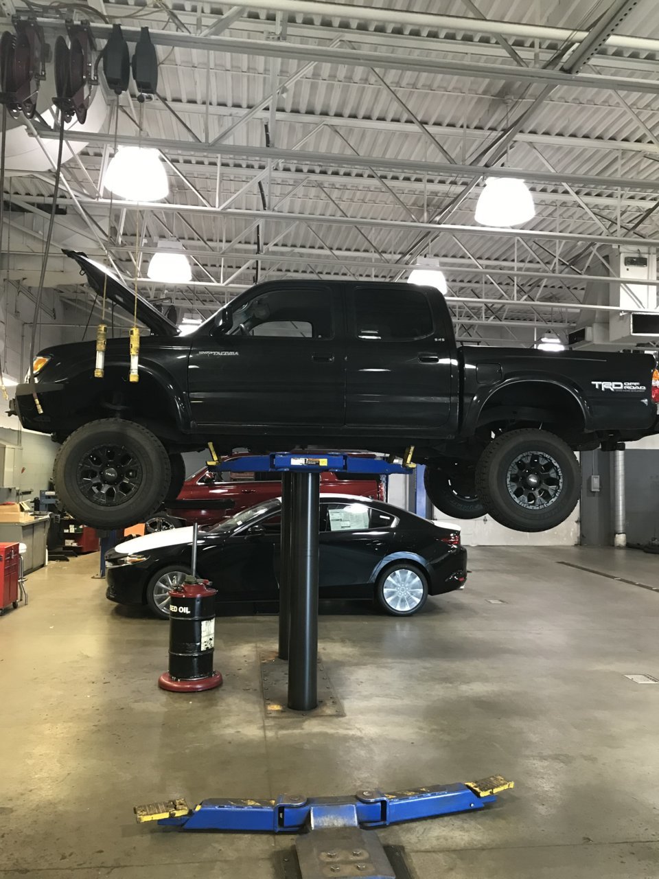

    I just left a truck shop and the lift is only around a 3 as it is. He recommended a leveling kit and switching out the springs as they appear to be quite thick for a Tacoma. He eluded to the possibility of the poor ride quality at highway speeds being caused by poor alignment. I mentioned that I wanted to lose the blocks and spacers and remain at 3” if I could get a better ride quality or go down if I need to. He seems like a super cool guy but he had no problem with blocks in the back and the price was a bit up there for the work.
    So having left there , i honestly don’t know if I’m more confused or less. And I saw a screw in my tire while we were looking at it lol. The search continues...

    I don't think I've ever seen a 3" lift with balljoint spacers and a drop bracket. I think someone makes a 4" lift with the drop bracket, but not the balljoint spacers. I don't think that mechanic knows how high a stock tacoma is... Those appear to be stock tacoma springs (3 main leafs and an overload leaf) , I don't know what he means by "quite thick for a tacoma."
    You already have a lift on it, and this guy was recommending a "leveling kit"?! So in other words he wants to put *another* lift on it. Yikes. More lift, if anything, will make your issues worse, not better.
    **Don't have that guy work on your truck**
    Depending on what you mean by a "bad ride", that's not an issue with the alignment. You'll get weird steering issues (drifting to one side all the time, etc...) or tire wear problems with a bad alignment, but not a rough ride.
    Another reason a ~3" lift with higher end shocks is all around a better than this type of lift.

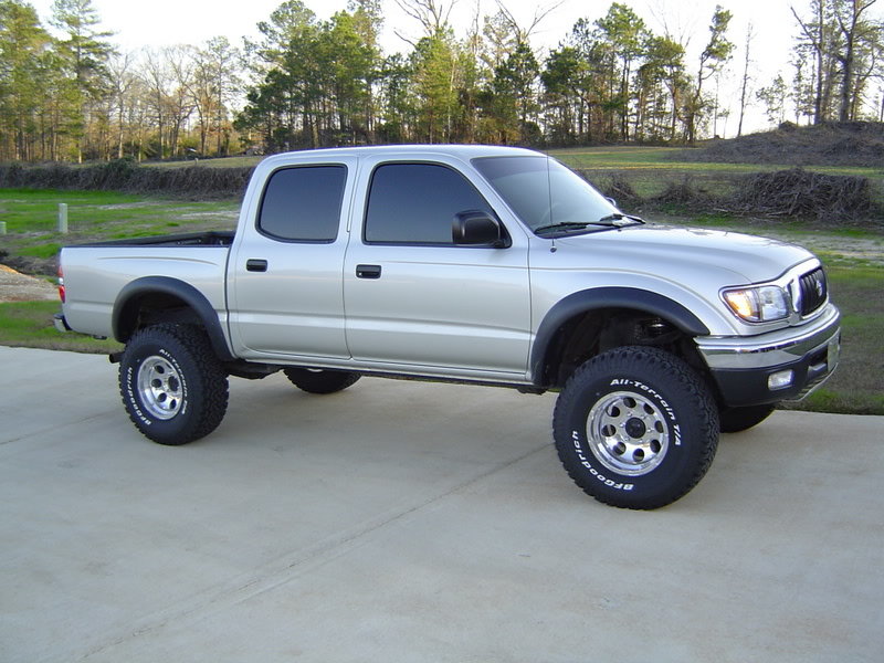

    04 XCab 4x4 TRD/OR
    OME 2.5,Tundra 17s,Falken Wildpeak AT3W hitch w/ 7-pin, ARE cap, JVC HU w/BT, HID/LED lights
    regular stance Tacoma:
    lifted 6" Tacoma with larger tires:

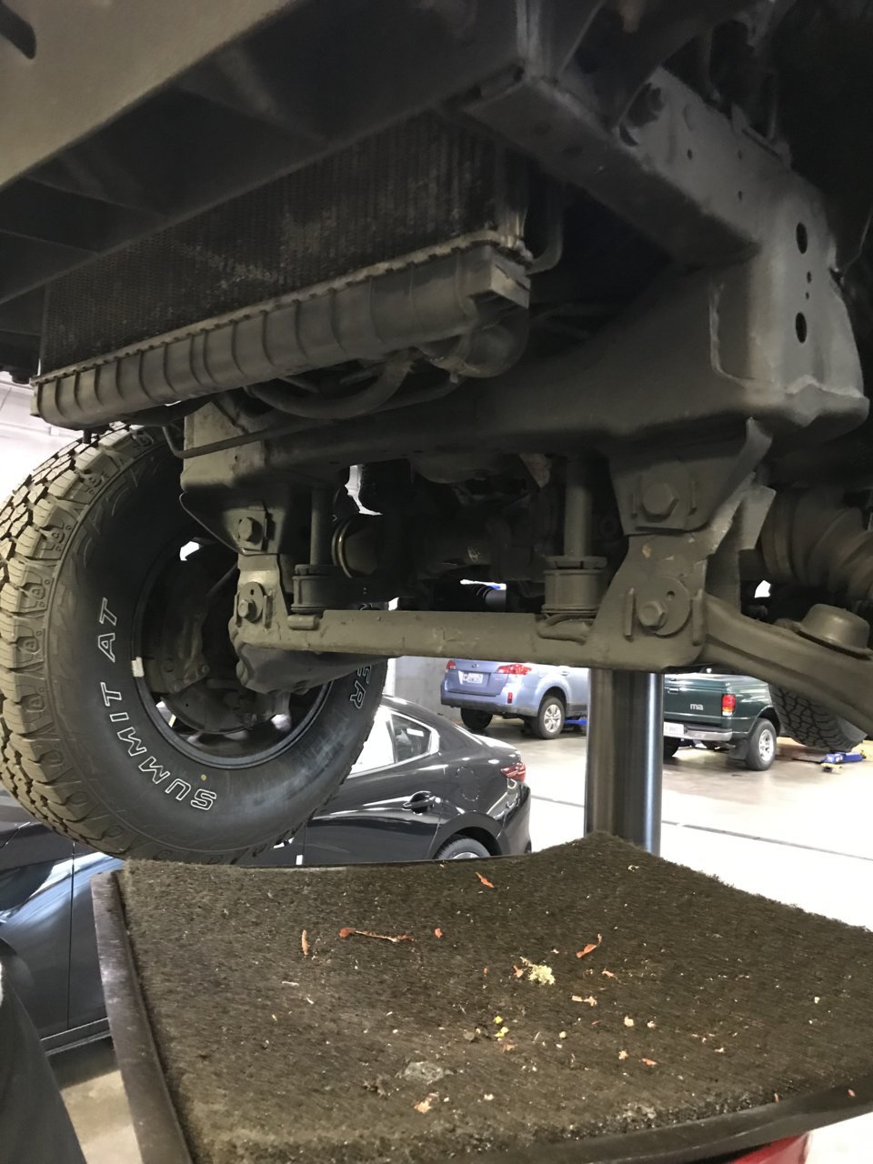

    Another question: will this crossmember setup be okay to put with the 3” or does something have to be done to make it compatible?
  15. Mar 26, 2019 at 4:57 PM
    #35
    jbrandt
    jbrandt Made you look
    Feb 12, 2011
    #51038
    17,612
    Justin
    El Dorado, CA (NOT El Dorado Hills)
    '04 TRD Tacoma 4x4 DC
    Kings, J59's Total Chaos UCAs Custom skids Sticker mod
    That's the rub with the 6" lifts, the stock cross member usually gets cut (not exactly sure how, though) in order to have clearance for the bracket for the LCA mounts and the diff drop spacers.
    I can't find a good picture of a "stock" front suspension without the skid plate to show the difference using google, so I'll get a picture of mine when I get home and post it.
    From what I understand it's not impossible to do, so any competent fabricator should be able to retrofit it fairly easily.
    The other thing is that it looks like you don't have bump stops, and the bracket on the right side of the pic (driver side) looks like it's been cut up or something (which is where the bump stops for the 6" would be).

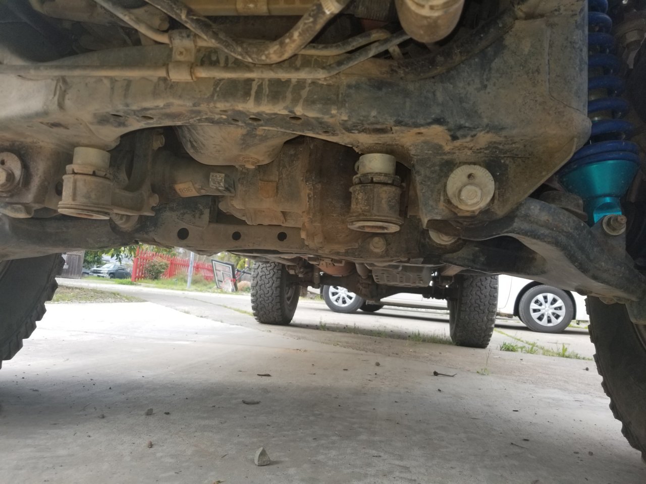

    Possibly, that's just what I've heard, as I've never personally tackled a 6" lift before...
    Here's my front end for a comparison, yours doesn't look to far off from mine aside from the obvious bracket, so you might be okay. Not sure what your rear mounts look like tho.
