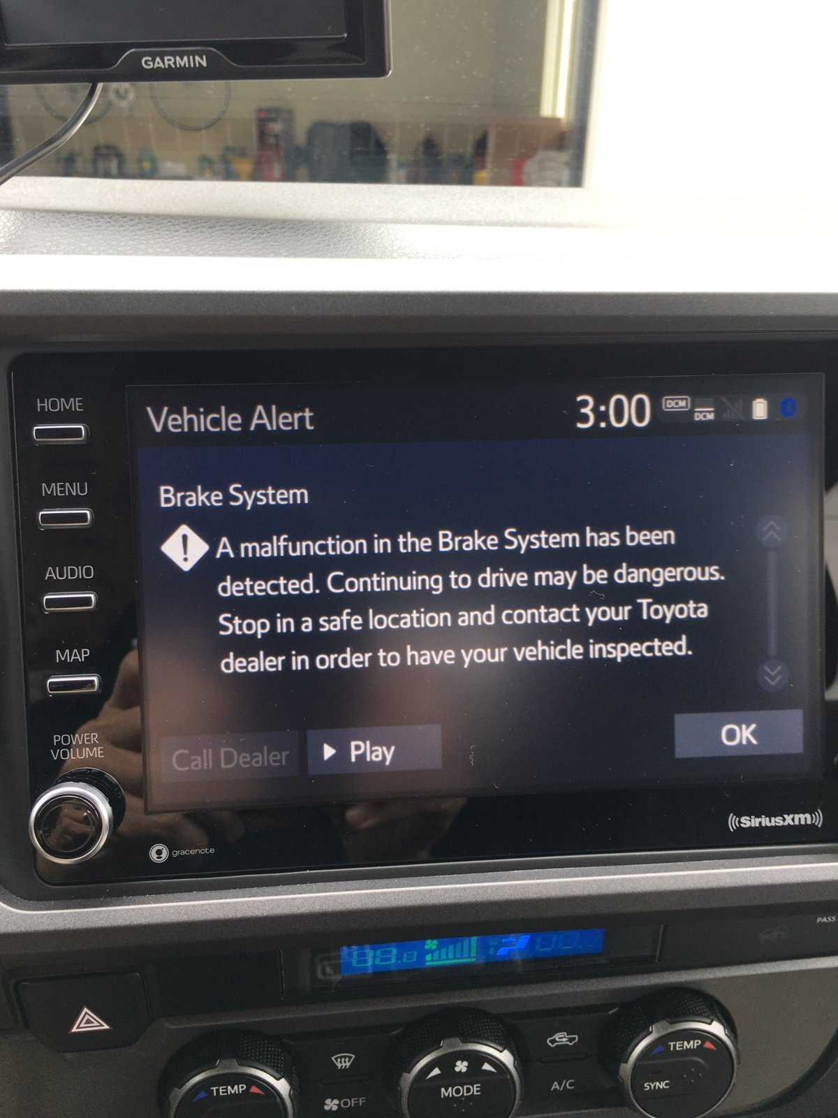

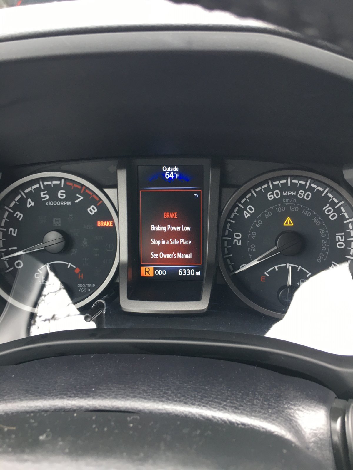

    [​IMG] [​IMG] Dealer kept the truck for eleven days and found nothing wrong with it. Said if I can duplicate the issue to bring it back.
  7. Jun 17, 2024 at 6:07 AM

    OP here. Well, it happened again the other day. I wash my truck, dry it, pull into the garage. About an hour latter get in to go somewhere and about halfway backing down my driveway it slams to a stop. It won't go forward or backward, brakes have locked. I put it in drive and start tapping the brakes, that's when all the brake malfunction warnings pop up. I keep tapping the brakes and it will slowly start moving forward and the brakes release. I put it in reverse and go about 10 feet and slam, locked again. Do the same routine tapping the brakes just to get it in the garage. The next day it drives fine. The first dealer kept it for 11 days and could not find the issue. Took it to a different dealer and they also kept it 11 days and could not find anything wrong. They ran it thru a car wash, sprayed it with water but could not duplicate.
