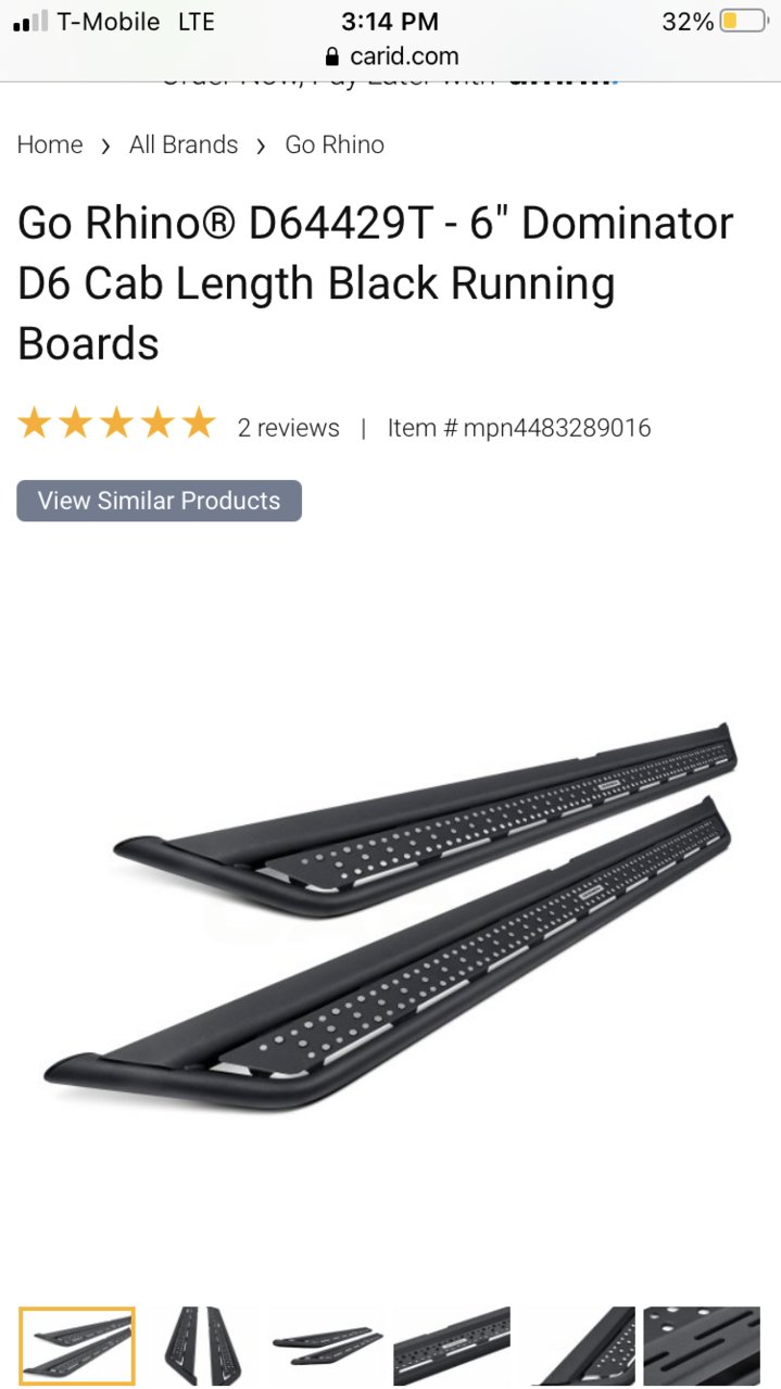

    You probably want to consider changing the order and look for a frame mounted slider, as the body mount steps can cause rocker panel damage if bottomed out off road. There are a number of Black Friday sales going on right now. I just picked up a set of CaliRaisedLED Trail Edition bolt on sliders for $552 OTD. There are other options, but CaliRaised is close enough to where I live to drive to pick them up.

    Unless they are mounted to the frame, they will not provide enough protection to be called rock sliders. The sheet metal of your rocker panels and the rest of the body of your truck is super thin and weak, yet extremely expensive to repair.
