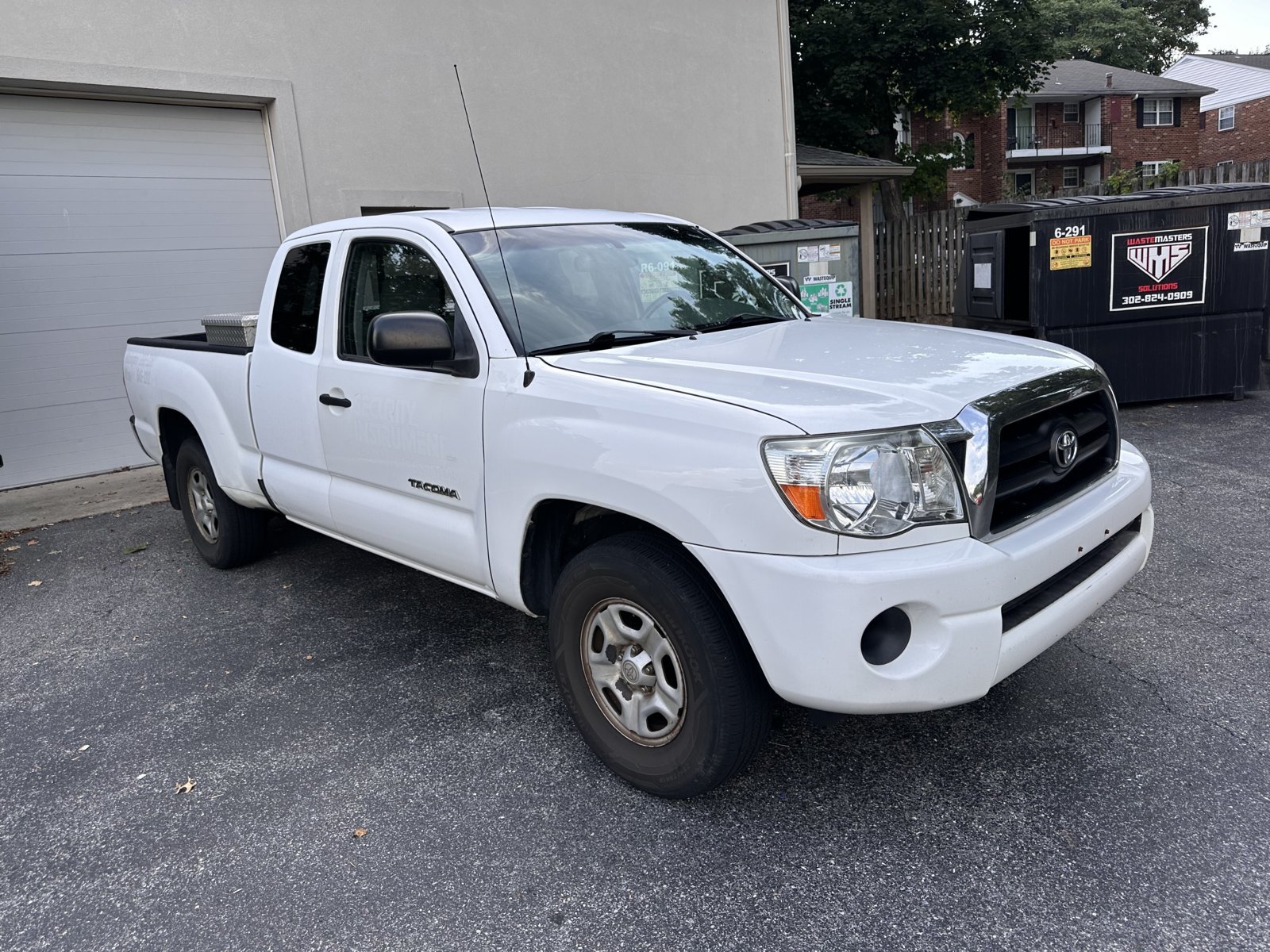

    New owner/member here, looking to spiff up this old fleet truck and I’d like to keep things cheap and simple. This is my first truck and I have very little experience with vehicle modification.
    It seems to have a low height compared to other Tacomas I see on the road. It needs new tires and I’m hoping to give it a better stance. Hit me with any and all tips, suggestions, questions, and recommendations. Example photos would also be much appreciated.
    Thanks in advance!

    It sits lower because it's 2wd.

    It's a 5 lug truck not a 6 lug (Pre-Runner/4wd), they have a completely different suspension and sit lower than 6 lug trucks.
    They can be lifted but there's not nearly as many options for lifts/wheels/tires as there are for 6 lug trucks.
    Check out the 5 lug sub forum for more info.
    https://www.tacomaworld.com/forums/5-lug.114/

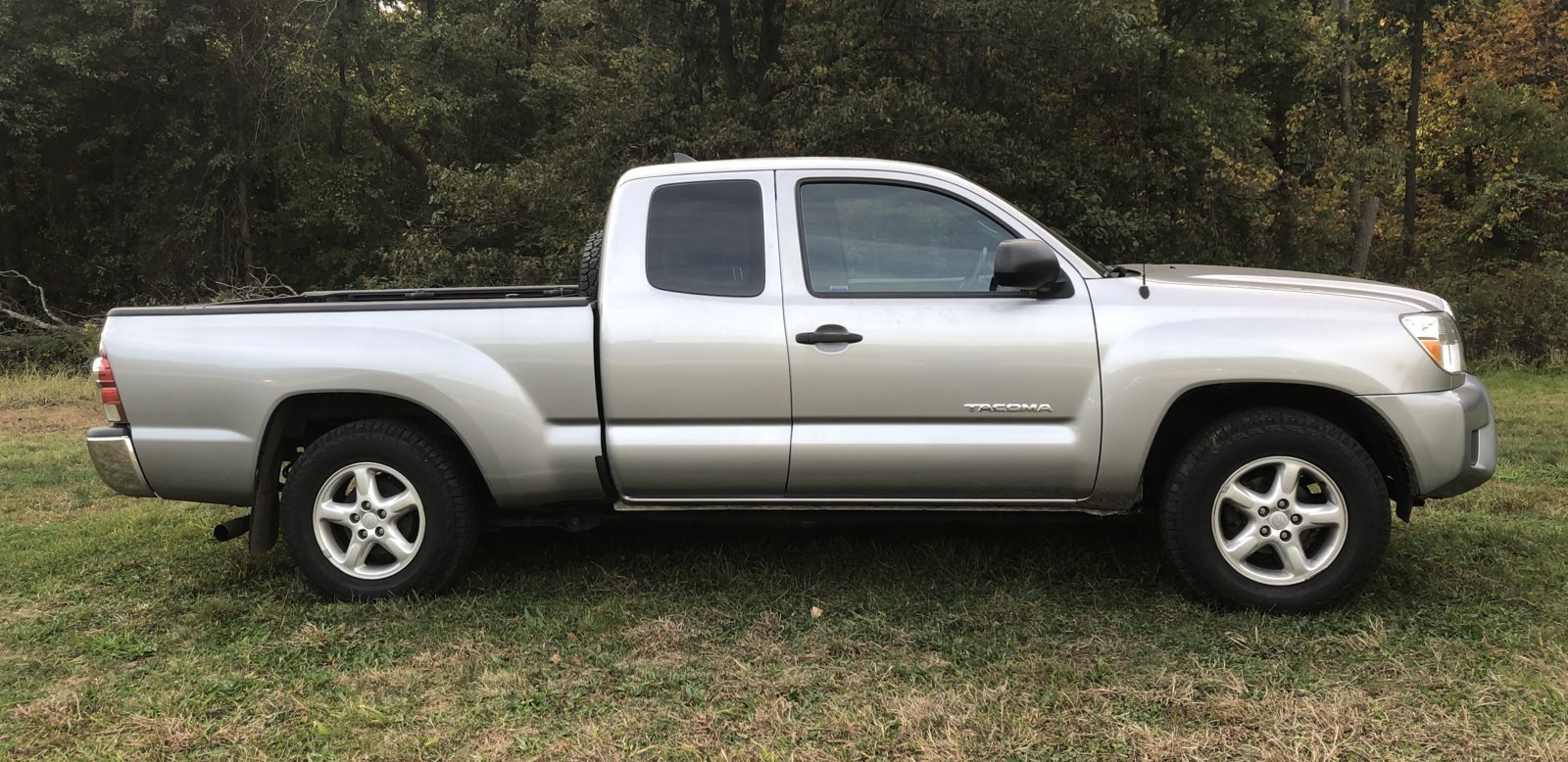

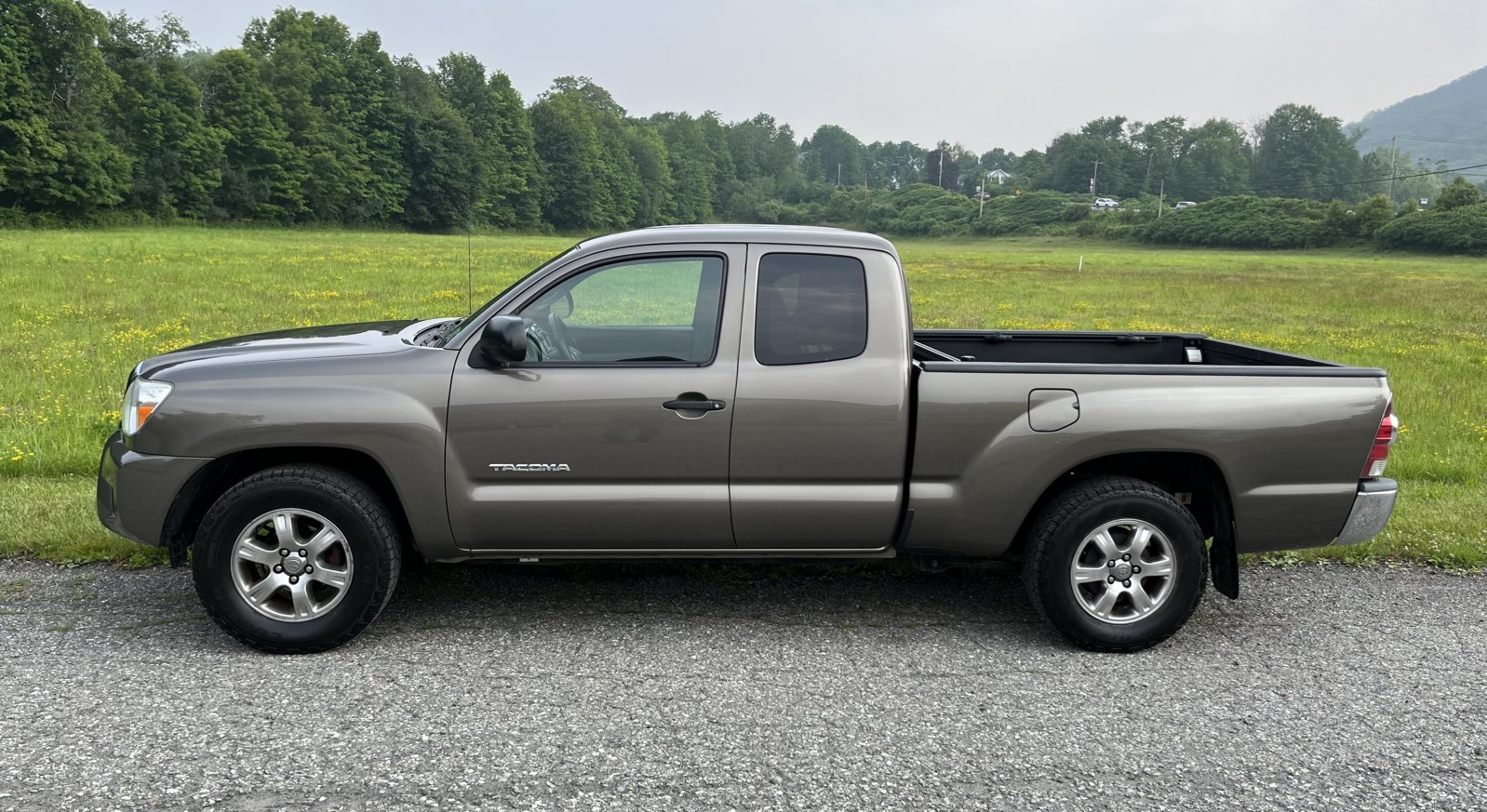

    There are a lot of better looking used wheels which will fit a 5 lug Tacoma.
    Most Highlander, RAV4, Sienna and Camry rims are a straight swap.
    I've also seen Jeep and Mustang wheels used.
    Search the 5 Lug section of the forum for examples.
    I had RAV4 wheels on my first Tacoma and Highlander wheels on my present one.
    RAV4 16" wheels with 225/75R16 tires
    Highlander 16" wheels with 235/70R16 tires
