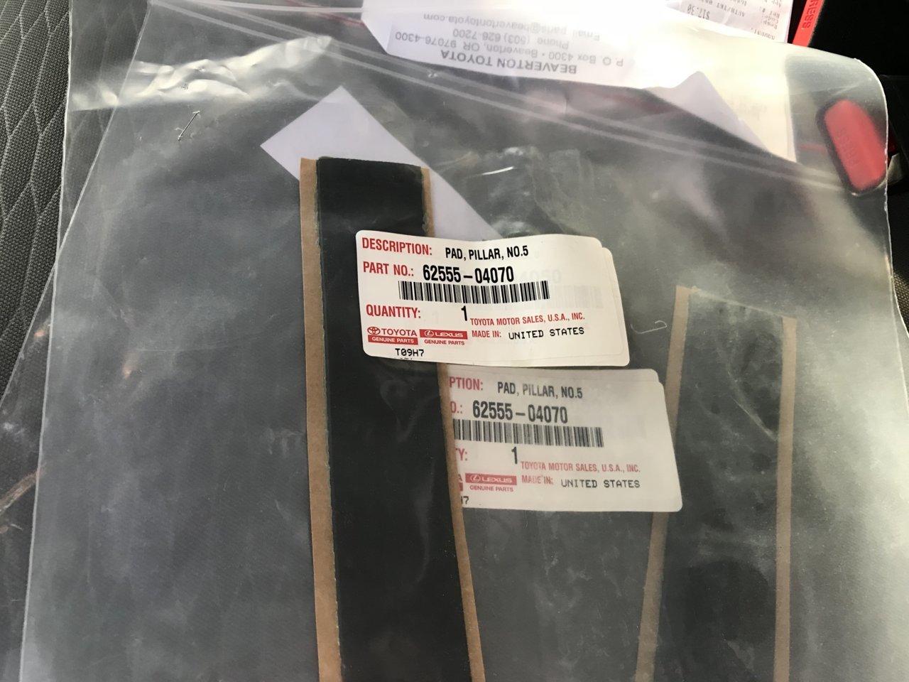

    Haha that it is! Oddly enough i kind of liked the challenge of all this at first, but now I’m getting a bit tired of it ha I would rather not have to listen to my music at 40 just to block out the howl. Maybe that is being ridiculous? Haha
    Attached a pic of pad pillar no. 5. Not what i was imagining. Maybe I got the wrong part somehow? Lol23EB265F-F8C1-4E3F-8414-7C2A619F03C2.jpg

    Check, not sure if there is enough detail in the photo:
    https://www.tacomaworld.com/threads...hering-throttle.442341/page-215#post-17223994

    The attachment shows the frame dynamic dampener - Those are on "back order" according to my dealer. I went in yesterday for my T-SB and called two days prior to ensure all parts were on hand. Well after 5 hours they called me and informed me they could not perform the T-SB because they did not have all the parts. The Assistant Service Manager who placed the order screwed it up. They did not have the frame dynamic dampeners. $hit! No telling when they will arrive. What a f up Toyota has made when they don't even have the parts available for a T-SB that has been out for months.

    Took apart the back seat area of my truck yesterday. It actually isn't too bad to do. The only hang up I had were the c-pillar lower trim panels. I was afraid I was going to break them until I watched a How-To video. Also, don't let the seat belt retract.. That's not fun to deal with after that happens ha
    Anyways, I still don't know where to put the rubber pad pillar things. TSB says bottom of pillar, but mine had a big plastic plug with spray foam around it. There is a one way valve type thing in the plastic that opens up into a cavity below the c-pillar. Wish I would have looked at it more and taken some pics, but I was in a hurry. Ended up placing two layers of thick rubber/foam in there before closing it back up. No difference in sound after. Still can be heard above HD radio 30 and from 61-53mph, but I didn't expect the foam/rubber to do much.
