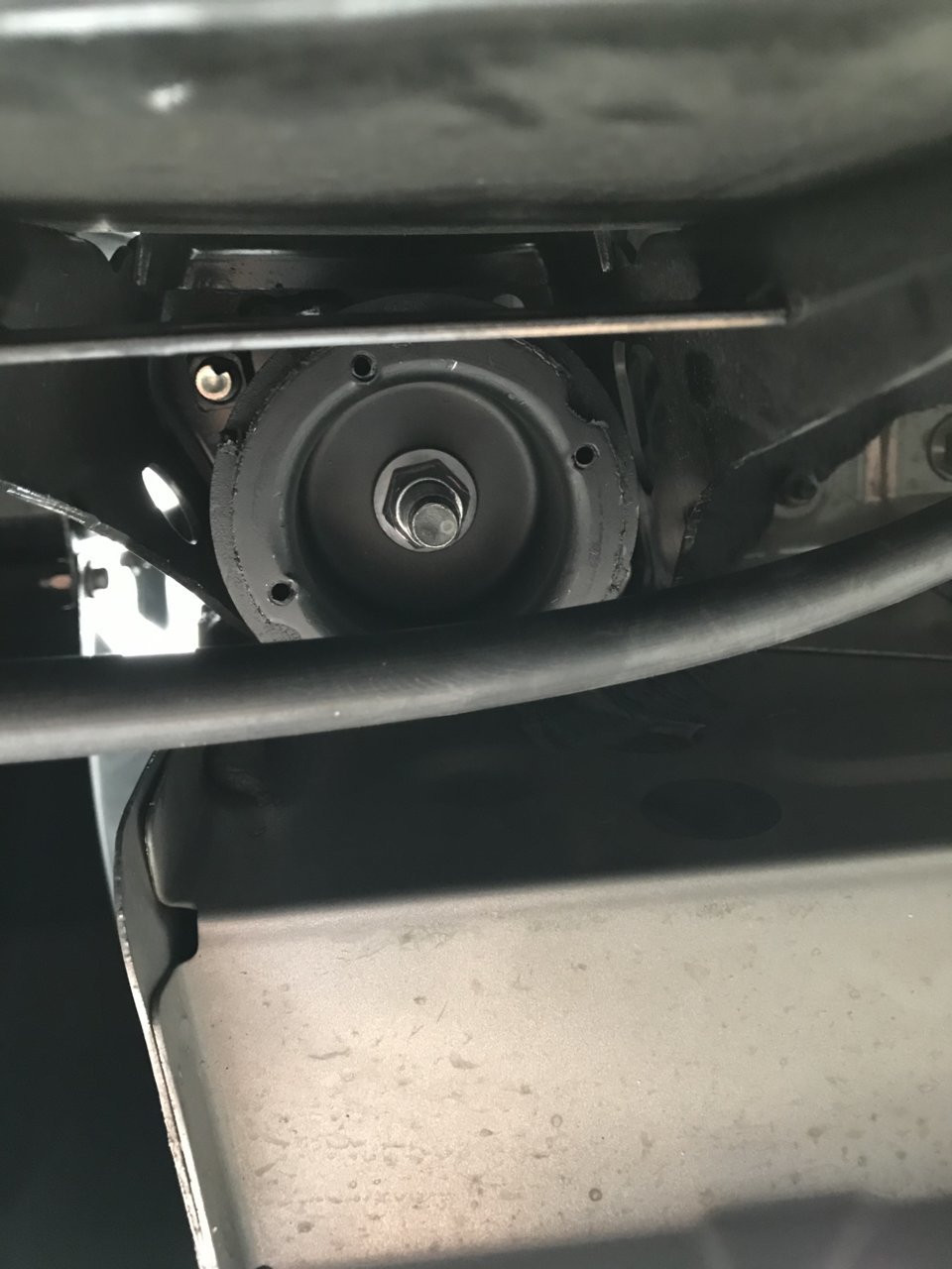

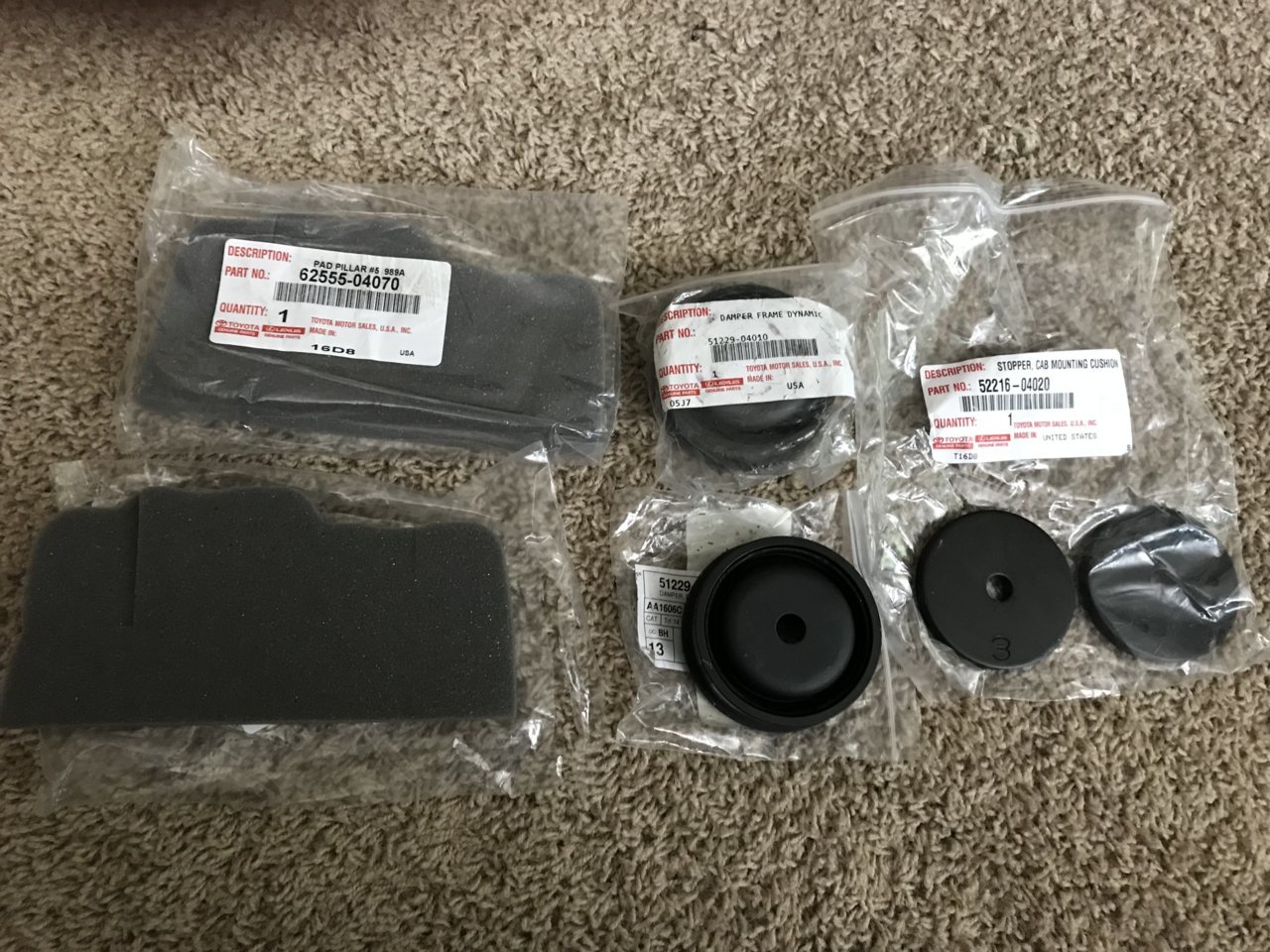

    Here are some pics!
    Pad pillar #5, dynamic damper, and stopper.

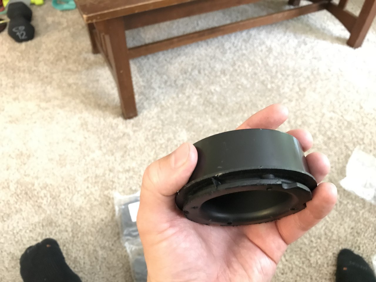

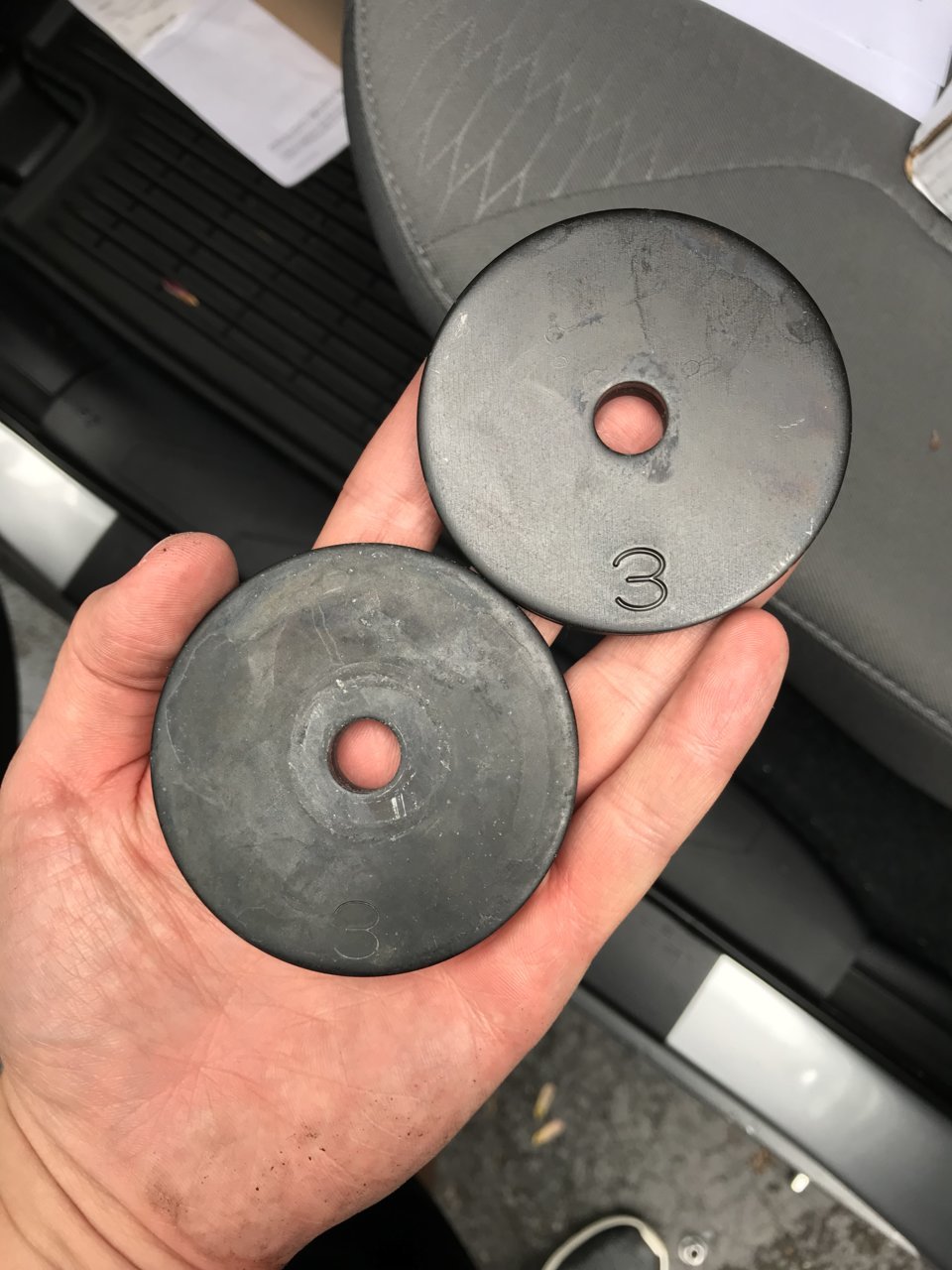

    Well, there is no point in buying the new stoppers as they are they same ones that come on our Tacoma’s.
    Old/New
    Oh well I replaced them anyways ha
    The dynamic damper is pretty heavy. Makes sense since it needs to absorb that howl.
    The flat washer aka stopper goes first and then the dynamic damper goes on the end.

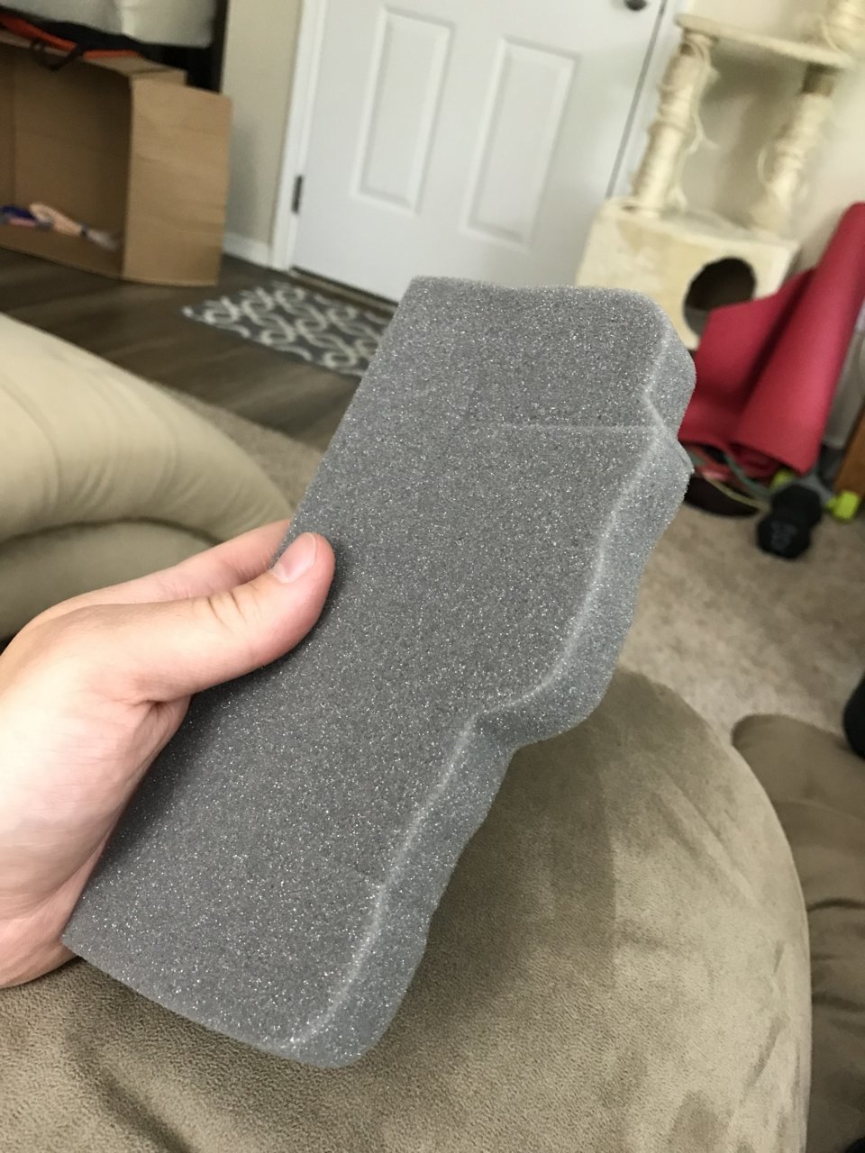

    The pad pillar will have to wait until I get my foam and sound deadener. I highly doubt it will do anything though. I already put my own thicker foam in the c-pillars a few weeks back and it didn’t help with the noise at all.

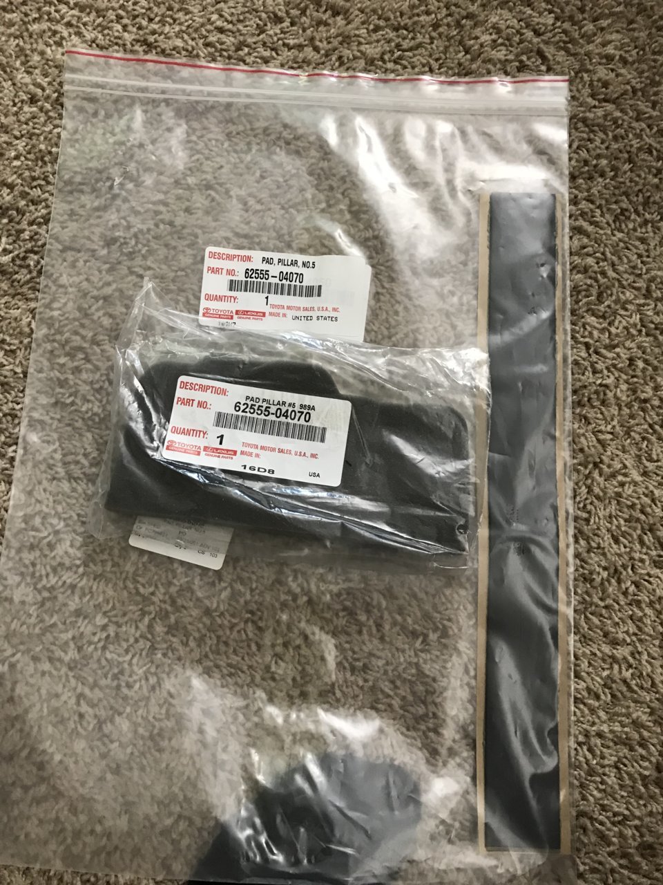

    So I had gotten what I thought was the pad pillar from my local dealer a few months ago. Well, I think they put the wrong sticker on what I bought as they look nothing like what I got today ha
    Oh well I believe I can still return it. Especially since it’s a wrongly labeled product.
    So how does my truck sound now you ask? Do I still have the rear diff howl between 53-61 while feathering, decelerating, and light acceleration ...?? Can I still hear it with the HD radio set to 35???.............. I will find out tomorrow!!! Haha I will check on my way to work in the morning. I’d rather not try it now and still hear the howl. I want to wait few hours before possibly being disappointed haha
    Tacolife5, nDub, shakerhood and 3 others like this.

    I bet you will still hear it. "Hear" me out though....lol, sorry.... anyways, I noticed mine right after me TSB was done as I was listening very closely for the difference. I was pretty pleased with the difference, but you could still hear it. Now however after a couple of weeks, I notice nothing. Your ear has been trained to pick up the howl, but once you change the howl tone, you find that your ear isn't picking up any of the noise. I'm sure if I drove with the windows up and AC and radio off I would still find it, but since I normally drive with the rear slider cracked at least, the radio on, and I use AC, I find myself not even thinking about it now because I can't hear it. Before I could hear the howl over all my normal usage noises. If I use my truck in a normal way and have no noises, I consider it completely fixed. If you go out of your way looking for a problem, you will find one.
    Ultimately I think you should be ok even though you aren't changing all the parts per the TSB. I think the important ones you have.

    Hahaha oh I have no doubt it will still be there in some way. Mine is very loud and very annoying ha
    Well, if it changes to a pitch less noticeable to the ear I’d be tickled pink Hana Im really hoping at the very least it reduces the 9mph howl range down to 2-3mph max. I’m just having a hard time believing that little damper can help that much.
    Also, I have a DCLB so once I put the pad pillar in that’s it for the TSB parts. No leaf springs for long beds. It will go in with additional pad and sound deadener. I’m hoping once I finish it all up that my howl will be fairly quiet :fingerscrossed:
