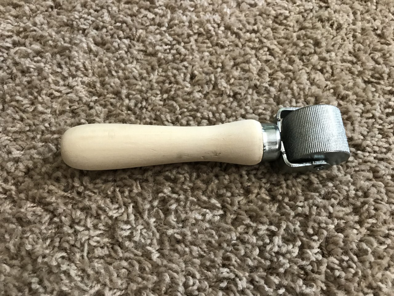

    Also, I still feel like the howl is mainly coming from passenger rear corner. The c-pillar/cab mount area. I’m hoping to pull the rear interior and have someone else drive me this weekend to confirm.
    Still waiting on sound deadener and foam, but I did receive this in the mail today:
    Hoping for better results once all said and done.
