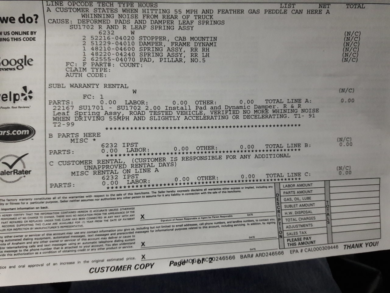

    Had my TSB for ~400 miles now. Is it perfect? No. Is it 90% or more better? Definitely. If i didn’t know about it, I couldn’t tell it is there after the fix. Plus the price was right at $0.00. So far, I’m happy with it.
    I feel bad for the folks that are still having issues. I guess we can’t all be winners.

    So I picked up my truck tonight. I have the long bed and they replaced my leafs as well. I would say the whine is about 70% gone. Like other have said, I can still hear it because I know when to listen for it. Anybody else riding along wouldn't be able to tell anymore. With the radio turned up to only about 10, it's unnoticeable. Glad so many others have chimed in on their experience with the tsb. It gave me some realistic expectations. After reading a few, I knew what to expect and it was spot on so I wasn't disappointed that it's not completely gone. I'm just glad the whine is down to an acceptable level for me. It's something I can live with now.

    OK, TW brethren, I just got my truck back. For background, my howling noise was the worst at 55mph. I could hear it over my radio at volume level 35. The noise at 55mph is now completely gone. However, I can hear the noise when lightly feathering the throttle at 58-59 only. With the radio on virtually any level I cannot hear it. The noise is not audible to my ears at any other speed. I’d say the noise is at least 75-85% muted compared to what I heard before. Obviously, I wish all of the noise was gone but this is a win as far as I’m concerned. I’ll take it and it’s nothing a set of Duratracs won’t completly fix. ;). If you haven’t had this done then you should. I think, at a minimum, most people have at least satisfactory results. My 16 Yukon XL makes a louder howl at 55 then this now does at 58-59. I’m pleased.
    I also had the Entune TSB done and my radio is a different animal now. No more neurotic behavior. Another win.
    Parts (weather stripping) on on order for the cross wind TSB with no ETA, but my dealer said it should be in in a week or two. To me that is an ETA...

    Man, that is good news! Glad it helped your truck so much! Did they end up replacing your leaf springs, too? I'm hoping after I add some foam and damper that mine will be as quiet as yours!

    Mine is a long bed (Super Long for TSB) so they didn’t give me new leafs and did everything by the books. I’m still pleased. That damper will make a difference. The guy at the dealer said you need it.

    Yeah, it sounds like the leafs alone don't do much for the howl (per a few people on here). The damper helped mine out quite a bit. Crazy that little chunk of metal and plastic can make such a difference.

    My howl is gone best I can tell post TSB today!

    Just got my TSB done and I’d say it is absolutely 90% gone. What remains is only audible to a trained ear. Very happy and glad Toyota did something about this
