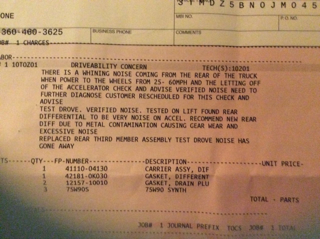

    After performing TSB 0013-18, dealer road tested vehicle. Noise still present. Dealer called TAS to start case 182600104. TAS advised to use Chassis ears on both rear wheel bearings and rear diff case to confirm noise location. Confirmed noise from rear diff carrier. Drained fluid to inspect magnet on drain plug. Found material present on magnet. Replaced diff carrier. Set fluid level, bleed braking system, road test, all OK at this time.
    I have put about 50 miles on the truck since the work was performed and the whine is gone. There may be more than one cause of drive train noises, but if your dealer is in denial, Find another one or call Toyota. I'm very pleased with how mine handled the problem.

    I think it's possible that in some cases bad diff parts are being replaced by more bad diff parts too. It seems like the chassis ears could be used to confirm this.

    Picked up my truck from the dealership today. It sounds like a new truck. No whine at all.

    Glad they fixed you up. Did it list a total price even though its covered under warranty?

    This is great news! But, give it some time just to be sure.

    Did you get an extended warranty?

    Did you confirm whether or not new parts were used?

    If you sift through the rear end whining mega thread, there have been numerous instances where people had the whole third member replaced, reported that the noise when away and then reported that it came back.

    No, it didn’t.
    No, I’ve only had the truck for a couple months and I didn’t think about it.
    I’m hoping new parts since they had the truck for a week and had to order the parts.
    I was glad they didn’t give me the run around and wanted to fix it. I was pretty skeptical after reading the numerous posts about how some dealerships were denying the problem exists.
