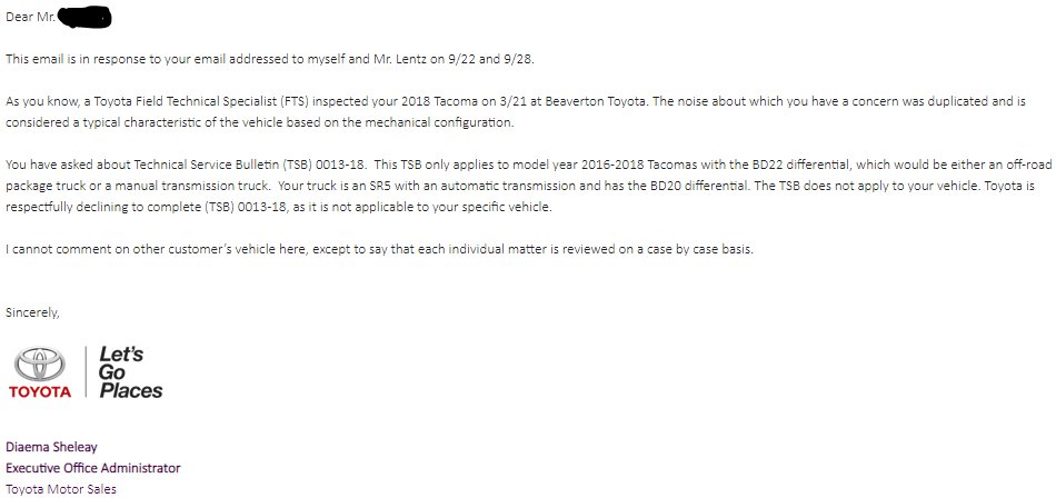

    Well, I fought the good fight, but I think I hit the wall.
    LAME.

    Just Lemon Law it or file notice of such and they’ll come around.

    At this point I really don't know what else to do. I have been emailing and calling them since January haha The howl is just a noise, but a very annoying one. Toyota has deemed this noise normal for my vehicle as well. Not normal for TRDs, but normal for SR5s. I don't think I have a leg to stand on since its a normal trait of the vehicle.
