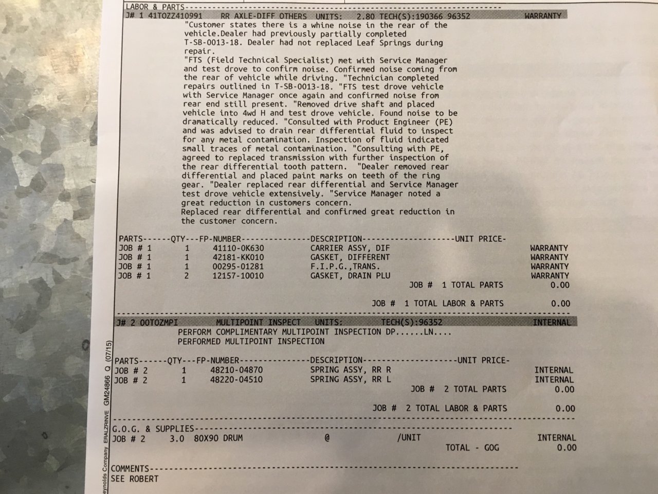

    I just got my Taco from the dealer today. The work order says the work was completed on 12/19. Toyota pretty much tore my truck apart for 13 solid days. I got near daily updates from corporate but chose to stay quiet until all was done. Like many others, the howling/whining has been driving me crazy. My corporate contact stated that my pinion angle was “off” and that my gears were damaged. They replaced the rear leaf springs (I have a long bed), replaced the rear differential, and as you can see from the repair order, did a few other things. The noise is gone, at least so far, but then again I had no noise when my truck was new as it started around 1000 miles, so I’ll reserve judgment for later.
    I am not trying to start a debate but I do find it interesting that this noise is summarily dismissed as only a “resonance” yet my howling rear differential was confirmed to be bad and subsequently replaced, resulting in no howling. I’m still trying to get the Field report as the repair order doesn’t relay half of what I was told, but I didn’t expect it to. To me Toyota truly tried to fix my truck and I’m grateful for their efforts. The corporate contact was open and candid. The dealer obviously had been muzzled and wouldn’t say a word, deferring to corporate the whole time but they did what they were instructed to do without question.
    The only thing that seems to be bothering me now is a really bad surging that had gone away after the tranny TSB. Does anyone out there know if pulling the tranny could have undone the flash I had done previously? If I can get the surging fixed now I’m a happy camper, so long as the noise doesn’t return. :)

    As for the resonance issue, I had the TSB done and it fixed my truck, yours decided to go a different direction haha. It is possible to have seperate issues cause the same symptom though. You even said yourself that yours was better after the TSB was done, until it wasn't. You might just be blessed... There also might be tons of trucks out there with the exact same problem you had, maybe not.
    I hope your truck is good to go, i'm sure you will keep us updated.
