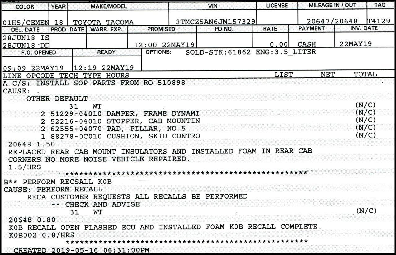

    So I paid a visit to the doc today. Here's the receipt:
    Everything was totally free of charge, covered under warranty or recall.
    I can report that the howl is 95% gone, as far as I can hear in the cabin. The dampers/cushion/foam pads do a good job of masking the noise, and the cabin is a tad quieter overall, which is nice. I realize the issue probably hasn't been solved in any meaningful way, and this is really just more of a band-aid to alleviate the annoyance. However, when talking with the main service manager kahuna guy, I got the understanding that it's nothing to worry about, and if that differential really becomes a problem, it will be taken care of. He also admitted the rear end howl is really common with these Tacomas, which to me is both unnerving and reassuring at the same time: unnerving because Toyota really sent out a TON of defective units, but reassuring in the sense that my dealership is well aware of it and isn't playing dumb. They've been honest thus far, and I haven't had to literally show them print-outs of TSBs or recalls in order to get them done.
    As you can see, they also flashed the ECU, and maybe it's just placebo, but I think I've noticed some improvement in the transmission. Going up hills, there's less gear hunting, and the whole rig just seems more sure of itself.
    Anyways, I'm an average dude, not too mechanically inclined, just trying to maintain a realistic balance between the flood of information I get online (mostly negative) and what I experience in the world. It's easy to let the bad stories lower my confidence, but this is a strong little truck and it's never let me down, and I don't get the feeling that it will anytime soon. There's definitely some shit Toyota needs to fix, but I doubt their quality has just completely tumbled to hell. I'm always willing to hear evidence to the contrary.
    I do just have a couple questions, if anyone can give me some insight:
    • If a Taco's rear differential is leaking and potentially "eating itself" as I've seen posted (metal shavings in the fluid, etc.), how long until it totally gives out and leaves me stranded? Have there been accounts of this happening yet?
    • If you had to guess, what percentage of the howling noise is caused by actual malfunction of the differential, and how much might be caused by some sort of "harmonic resonance" in other components?
    • Is flashing the ECU capable of producing the kind of change in performance I mentioned, or am I just crazy?
    • Is there anything on the service receipt that sticks out like a sore thumb?
    Cheers.
    Tacoma816 likes this.

  20. May 22, 2019 at 5:55 PM
    #840
    NMTrailRider
    NMTrailRider Well-Known Member
    Sep 28, 2009
    #23469
    5,292
    New Mexico
    Yes flashing the ECU will change things. But as you drive it, it will adjust back to your driving style and revert to the way it was before.
    If they do an ECU update (TSB or a different ECU software version) then it will be altogether different and stay different.
