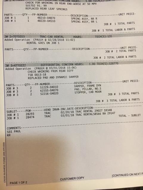

    They swapped out my gears twice. The second with Toyota rep measuring tolerances. The diff whined like hell after this one. Found out that any gear replacement is done with refurbished parts. Go figure. After TSB the noise is not completely gone but you have to listen closely to hear it. If I had the original set of gears now I probably wouldn’t hear it at all

    I only had the one replacement but I feel the same way. Original gears were nowhere near as loud as the replacement diff they gave me.
    Interesting to know they used refurbished gears. Its like musical diffs to see what you end up with.

    Probably gears from one of those that had oil leak issues
