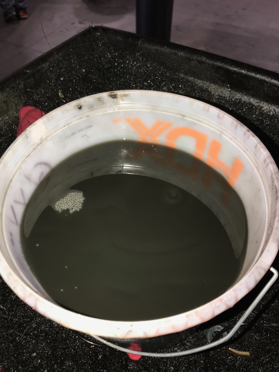

    So to chime in here. New 2018 trd or dcsb howling started around 2500 mi. Took it in for it's 5k the found it was the rear diff. Drained the fluid it was black and had metal shavings and parts. So something got burnt up in there . There are replacing the whole thing. He told me dealers are keeping on the DL and eventually will have either tsb or recall .I won't believe that till i see it. they seem to know about it .No matter what they tell you. It is slightly different than the 16's17's though . They are trying to find the root cause, and fix before they officially recognize it

    if you never drained at 500 or 1k, 5k you'll see shavings and the fluid will change color from the lapping compound. ( not 100%) if Toyota uses that during their break ins... Should be a dust of particles, any solid chunks are cause for concern.

    It was more than just shavings. This is what it looked like.download_20180329_223049.jpg
    The tech told me this is bad enough they are just straight up replacing it and sending the diff to Toyota to look for the root cause
