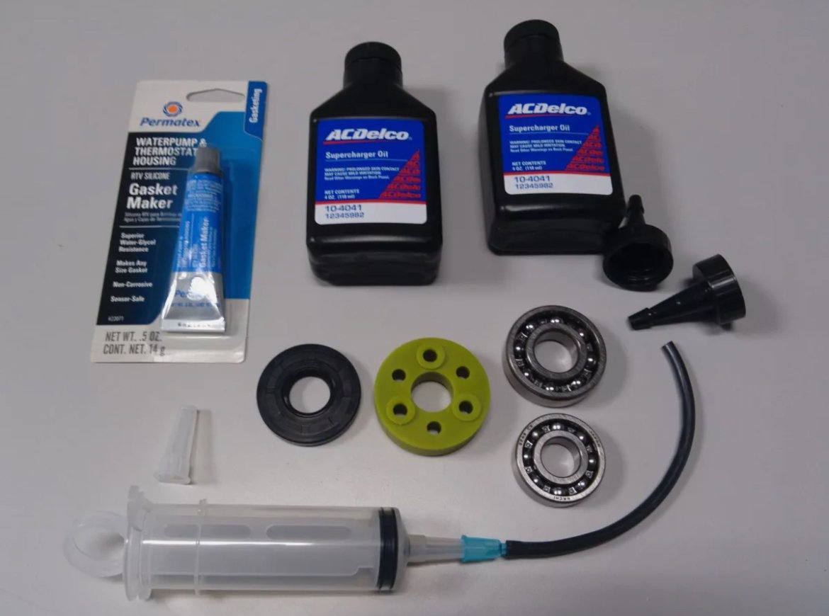

    It would not be professionally rebuilt, just a new kit similar to what’s pictured IMG_2192.jpgDone by me.
    As stated, the rotors are in good condition, maybe 85k miles if factory installed and same age as truck, a bit of chipping coating, but not much.
    I’m weighing running the old or splurging on the new, I guess it’s worth what someone will pay for it, but I’d be happy getting a couple grand toward the 1320.
    The question also becomes, why would someone buy the old TRD when they could get this newest version, the value greatly decreases as the new one gains word of mouth and the old one loses support.
    Truly a case of can’t have your cake and eat it too

    Very true, I sold my old TRD supercharger that was rebuilt by Jon bond with a year of miles on it for 2500.00.
    I think the prices will keep going down just because a rebuild is getting more expensive each year and those rotor seal and bearing are on borrowed time if they are not replaced. I’ve had both the rotor seals and rotor bearings go bad on me before and created a lot of damage.
    The 1320 bearing are rated at 20k and the old supercharger bears are at 15k so the 1320 will probably go much further before a rebuild and will run a lot cooler IMO

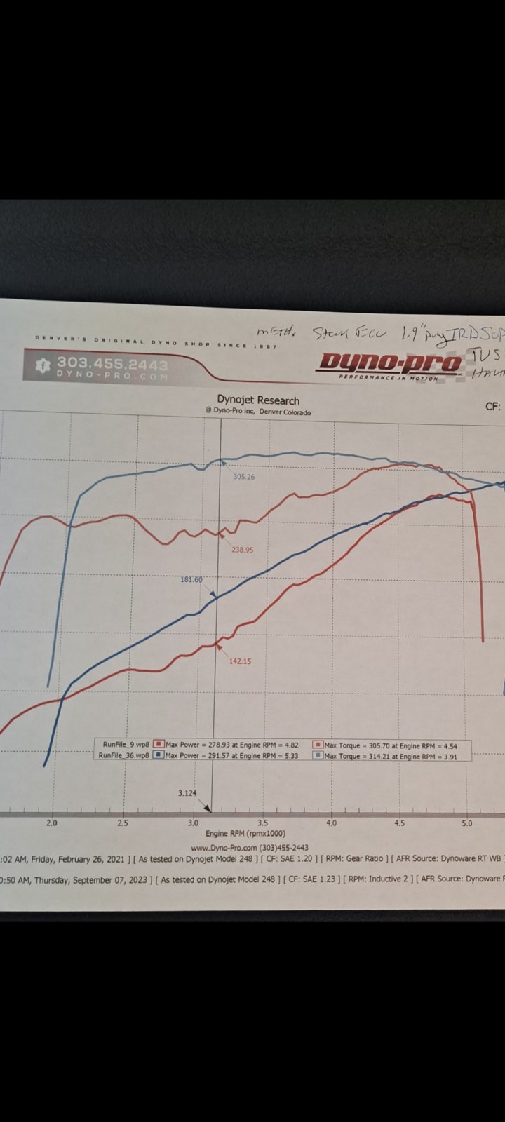

    This is the stock ecu and trd supercharger and haltech and 1320 difference.you get the idea.
    The haltech gets your power in at 2k because it's not setup with the open loop close. The differences is 65TQ at 3krpms
    This is an older dyno not with the current 56mm pulley

    Thank you John. This is very helpful and useful information.
    I might be over-simplifying a complex situation and asking too much, but it sure would be nice to have a chart with base 1320 S/C set-up (with all the basics needed) through the list of popular mods (Haltech ECU, larger injectors, each logical pulley size swap, headers, methanol injection?, etc.) and show the est. HP & Torque gains for each added mod. and perhaps an estimated mod. cost with pros/cons and make this a sticky...sure would help folks like me better decide how far they want to chase this speed rabbit.
    Many Thanks again!
