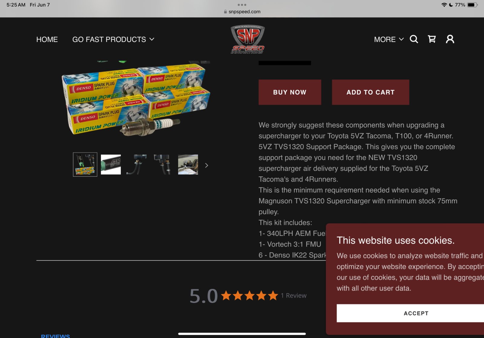

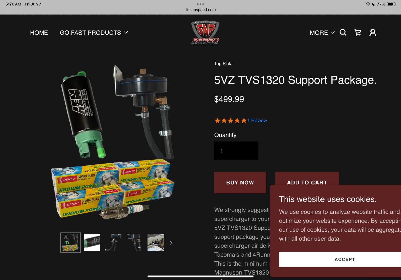

    This package will cover any lean issues and will work for smaller pulleys.
    https://snpspeed.com/all-go-fast-products/ols/products/5vz-tvs132-support-package
    strongly suggest these components when upgrading a supercharger to your Toyota 5VZ Tacoma, T100, or 4Runner.
    5VZ TVS1320 Support Package. This gives you the complete support package you need for the NEW TVS1320 supercharger air delivery supplied for the Toyota 5VZ Tacoma's and 4Runners.
    This is the minimum requirement needed when using the Magnuson TVS1320 Supercharger with minimum stock 75mm pulley.
    This kit includes:
    1- 340LPH AEM Fuel Pump
    1- Vortech 3:1 FMU
    6 - Denso IK22
    frenchee, Chuckk321 and izzy421 like this.

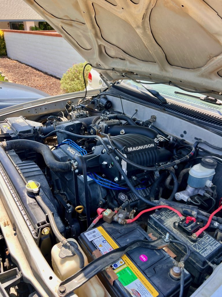

    Just finished my install.
    Took a while since I did the lower manifold gaskets, hoses, wiring harness, sent injectors for clean, valve cover gaskets, new radiator, fan clutch on and on.
    Feels great giving the truck the maintenance it's needed. My truck is quite heavy on big tires so it's no race car but it feels a bit faster than when I had no mods years ago. It's a very smooth steady power band until I get into 3500 RPM in 2nd (auto) and then I feel a bit more power.
    I'm getting a weird clunk or odd noise (maybe a ping?) when it downshifts and hits the power band suddenly. Will keep an eye on this.
    Really nice upgrade but I do wish it had the whine. Quite sad about the noise haha.

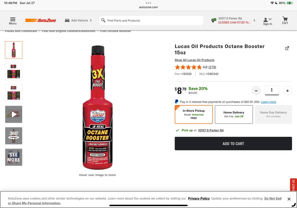

    Because you’re at sea level I’m not 100 percent sure, call and talk to Gabe and ask him and reference me.
    The other thing if you want to do depending is run Lucas octane booster 3x. You can add a bottle per tank 15 ozs and raise your octane level 2 to 3 points on top of Premium rated if ping was still an issue. I use it so I can run a little more timing on my haltech tune and it works very well.
    A case of 24 comes out to about 5.00-6.00 per bottle
