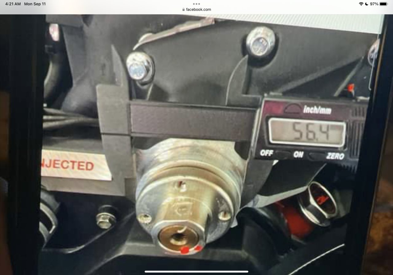

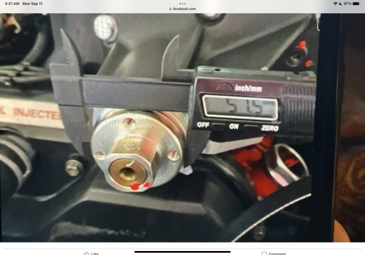

    Is 65mm the smallest pulley you can go?

    At this time yes, But one might be able to shave the snout lip down.
    If so a 60mm might be possible adding 1.5 pounds of boost =10-15hp or so
    Magnuson said they might redesign the snout to accommodate smaller pulleys but not sure,
    OR just having a larger lightweight crankshaft pulley would get you much higher gains
